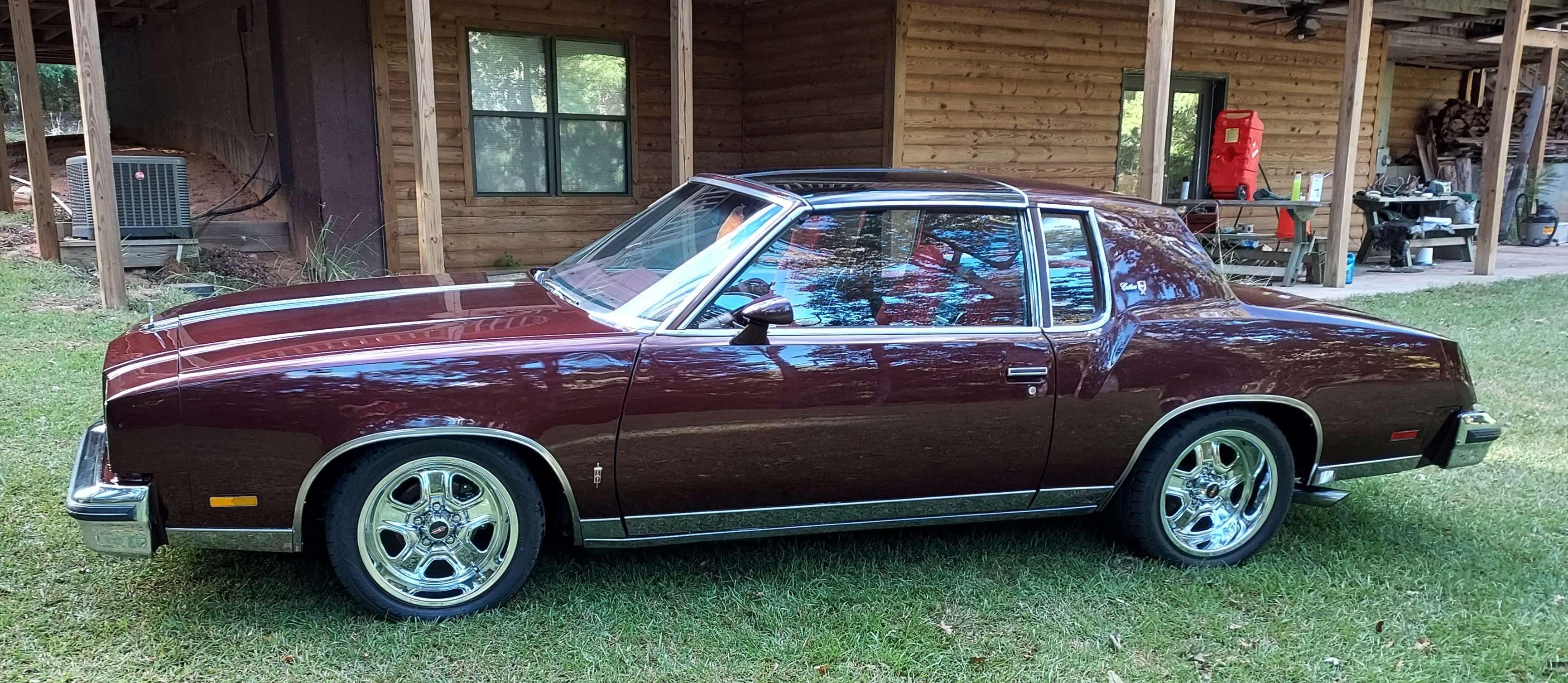

I looked at both UMI and BMR. I called both to ask questions. I was worried 2" drop would be too much, but did want it a bit lower. UMI's answers were unclear at best, said there was variation from application to application, you might need to cut springs to get the exact height you want. BMR was more clear, assured their kit was designed to give 1.5" drop over stock. They did advise my stock springs could have weakened in 40+ years.

I've driven it 12 miles so far. I understand settle, and it'd be great if they do/did; but I expected "some" drop right after install all things considered.
UMI is advising me to remove them and cut them now.

I talked to UMI and definitely ordered the right springs. I've been in constant communication with Ramey, which is honestly the only good thing about UMI to me right now. He's basically saying cut them though.
My front is heavier than stock because my car was stock when I got it, and I added in AC and went from v6 to v8.
No. I just said my stock springs weren't that worn; they literally were about half inch lower than stock.

The shop does about 100 cars a week, does everything from body to engine work, and is a multi-million dollar facility. First Class Auto Service. That's why I call them professional; the place has two receptionists at all times and about 10 guys working in the shop. You're right, they could have screwed it up but spring jobs aren't exactly rocket science; and even with doing it the wrong way I don't see it not lowering at all.
Again, I made this thread and had the concerns because another forum literally calls these springs garbage and say they ride like a 4x4. Tons of horror stories. I'm just going to jack it up and check the work.
I'm not backing down from these are a bad design if these are installed correctly though. Because it should have lowered if their reference is a stock gbody as mine is heavier than stock.
UMI took my money and it's not like they are offering to do anything about it if it is a bad product; so I'm not the bad guy here. I'm just screwed.

Sorry to see you have a negative experience. I have seen others complain that they didn't get the drop they expected from these springs. A few things to consider/questions that came to my mind:
The shop you describe sounds nice. What kind of cars do they normally work on? These cars are up there in age and many of the youngsters don't know how to work on them.
We're your stock springs for the V-6? If so, that could explain why the car is at the same height as I'm assuming the new springs are for a small block. These cars set pretty high from the factory by today's standards. The center of the wheel on a stock setup is usually in line with the bottom of the rocker.
At the end of the day, more times than not, you have to trim springs to dial in the desired ride height. That's been my experience. I hope you get it where you want it soon. When you do, please come back and tell us what you did and share some pics.
