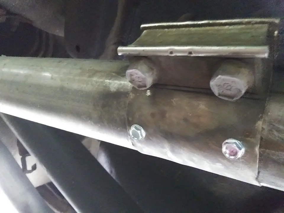

Box of self tapping screws.
"fixed" my exhaust. the only way band clamps will actually work.
I was thinking you had used it for the last few months .....
