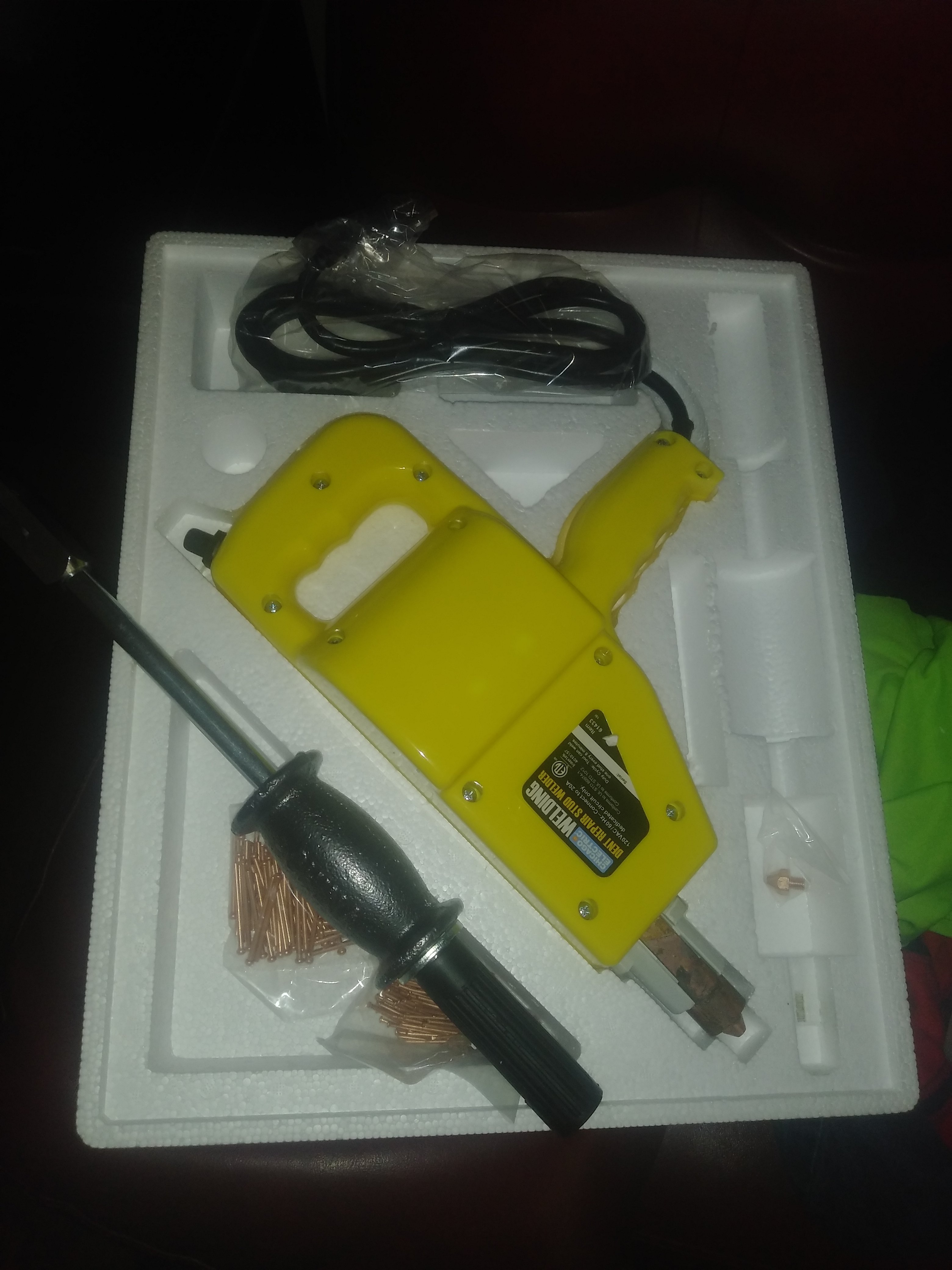

Bought a HF stud welder for 99$ to fix a dent from a past tire explosion. The welder works as it should.

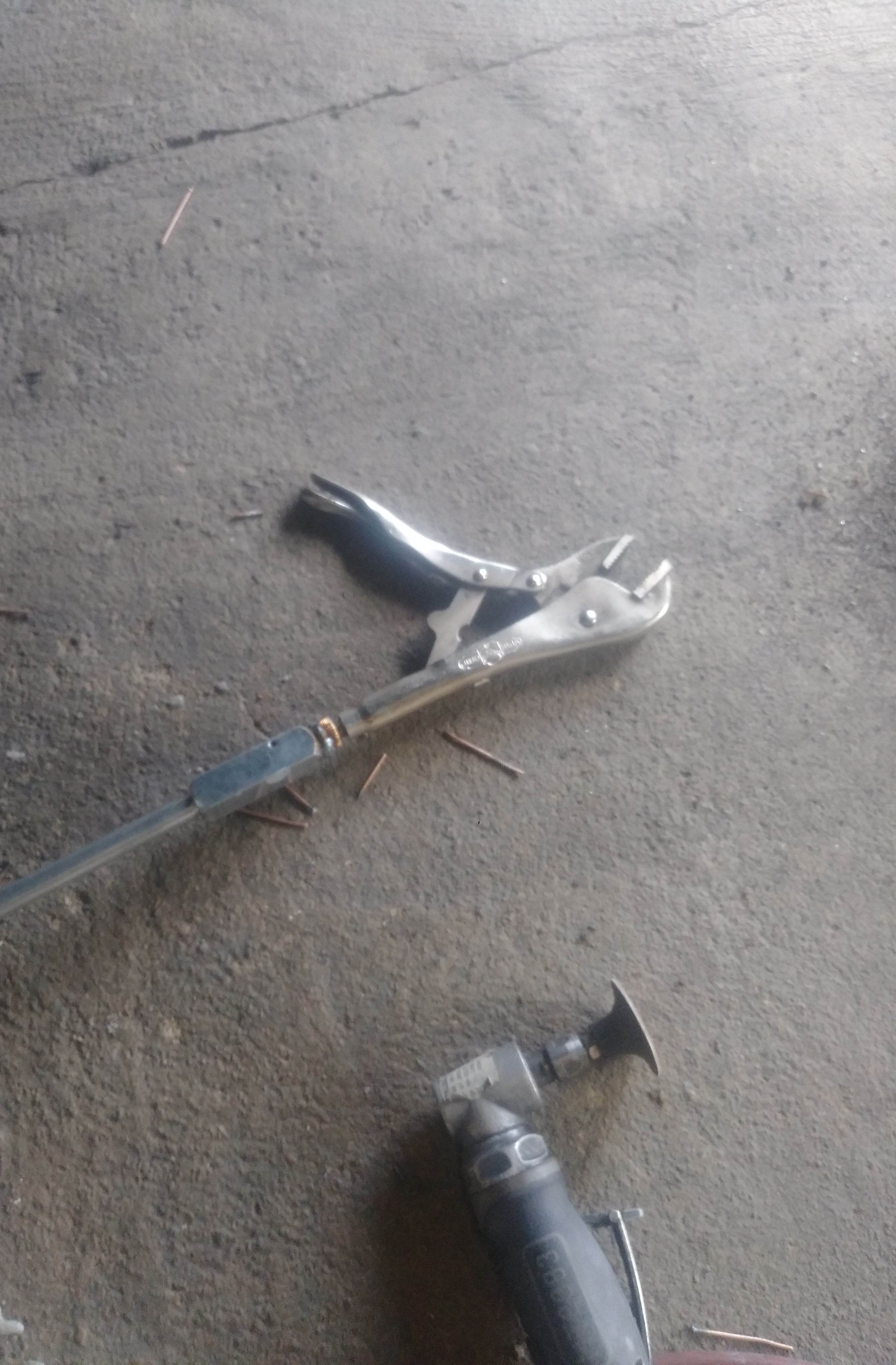

The slide hammer is pure s#!+. So I fixed it.
Now I just gotta figure out how to use it properly.
Where the bolt threads in for the vise-grips, you will want to weld the gap together where the handle was formed. Otherwise it will spread out with use and allow the slide hammer part to rip out of the vise-grips.
Unfortunately, these are pretty common tools in the plastic molding industry for removing stray plastic or parts from molds, so I have got to use several to the point of failure.
