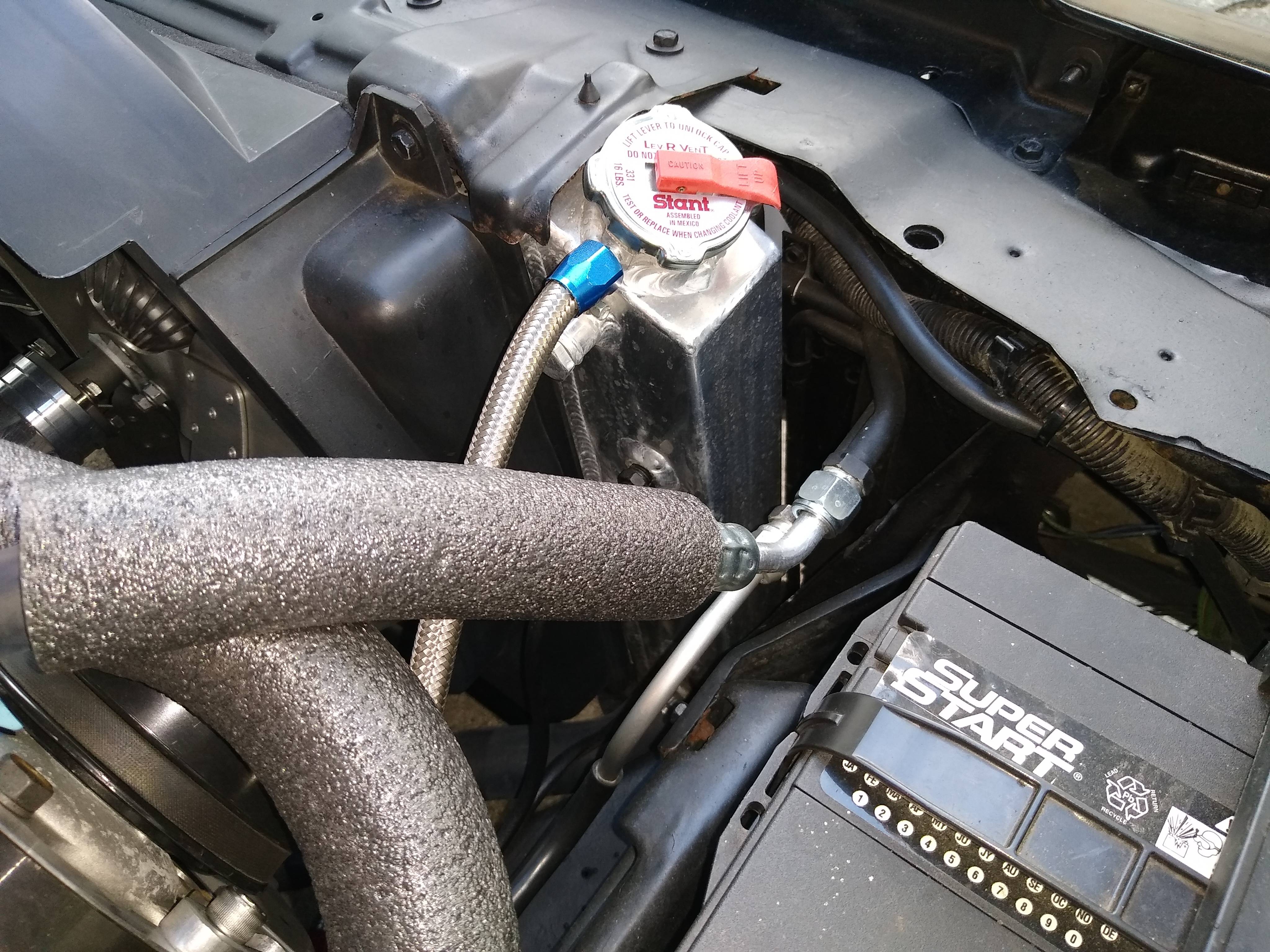

When I installed the SBC in my Regal in place of the Olds 307 I bought a new heavy duty clutch and a 7 blade fan with aluminum blades and found it needed to go another inch in the shroud and ended up buying a 1" billet aluminum spacer to get it done.
This has worked great for a few years now but I recently just changed over to a big Griffen radiator and Intrepid dual fans and can't even use the top plate.

Looking @ your image, this is how I feel the depth should be. It appears the fan blade is completely under the extended upper portion & about 50% depth into the opening that's under that extended portion. When I started, mine was exposed top & sides. Now I'm about .750" out @ the top & the blades are basically flush w/the lower section vs. being partially within the opening.
A spacer is on my radar but I was trying to source a clutch unit that wouldn't require one if possible first.
