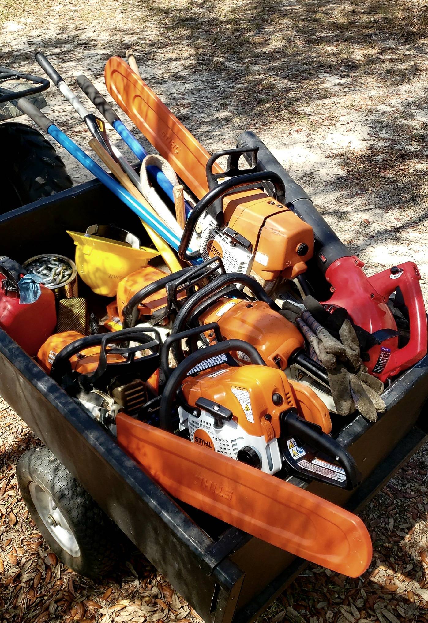

Had a small tornado hit near a buddy's place, wrecked his neighbor's stuff a little bit. Half this tree was on the house. Put the saws to work. Amazing what wind will do.
Ran a few saws today as well as the neighbors with their stuff.
MS261 Pro Saw
MS362C Pro Saw
MS461 Pro Saw
MS171
MS290 Farm Boss
View attachment 194647View attachment 194648View attachment 194649View attachment 194650View attachment 194651

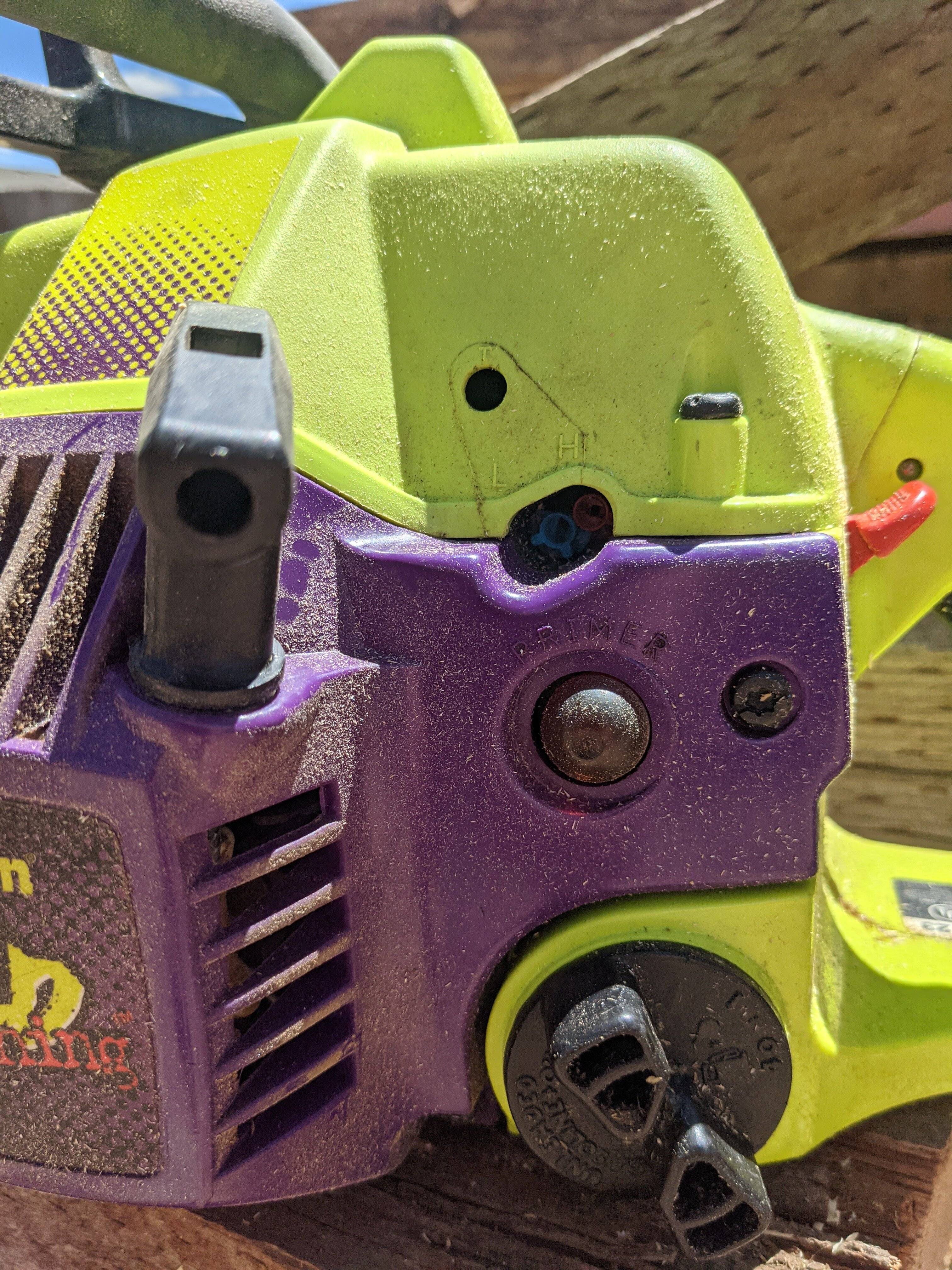

Mine is being a little bipolar and I can't help but think it's the tune given my elevation. I drained the old gas, put in fresh, all new fuel lines, clean carb so we can cross that off. Problem is the adjuster screws have these dumb caps on them and I can't seem to find out which way is rich and which way is lean.
Common sense would tell me out is fat, but that's assuming these control fuel and not a air bleed. Here's why I think it's rich:
I can't use my nose or an O2 gauge since 2 stroke smells no matter what. It ran well enough to cut up a couple of old 4x6s then got warm and angry and quit. Same as my Crown Victoria would do before I rejected for altitude. Can anyone shed some light on those adjusters? It's a wee 18" Poulan Wild Thing built in 2000 but it's plenty capable for this light work.
I had the same saw years ago. I think I removed the cover and modified the carb adjusters so they could be done with a screwdriver with the cover on. One is a high setting (full throttle) and the other idle air you can tune it by ear hold it open and turn until it runs smoothly same for idle I often had a problem with dirt somehow getting in the carb and I'd have to take it apart and blow it out. At one point it has a cracked gas line. It would not leak but it would suck air and go lean there's also a fuel filter on the gas line in the tank you can check. Mine eventually went lean and cooked the rings. That's when I went Stihl
Gave those stupid plastic things a tug and they came right out. Low speed was about 1.5 turns out, I put it at 2 and bang whole new animal. Fiddled a little with it but it seemed happy there. Now to figure out the high speed tuning, seems there's an ear for that.
Reactions: joesregalproject
There is. Listen for "four stroking" at WOT. Basically when the saw is only hitting on every other combustion cycle.
Then make a cut and the 4 stroking should "clean up" and sound smoother under load during the cut.
If you don't hear it four stroking at all, it's too lean. If it is four stroking in the cut, it's too rich.
