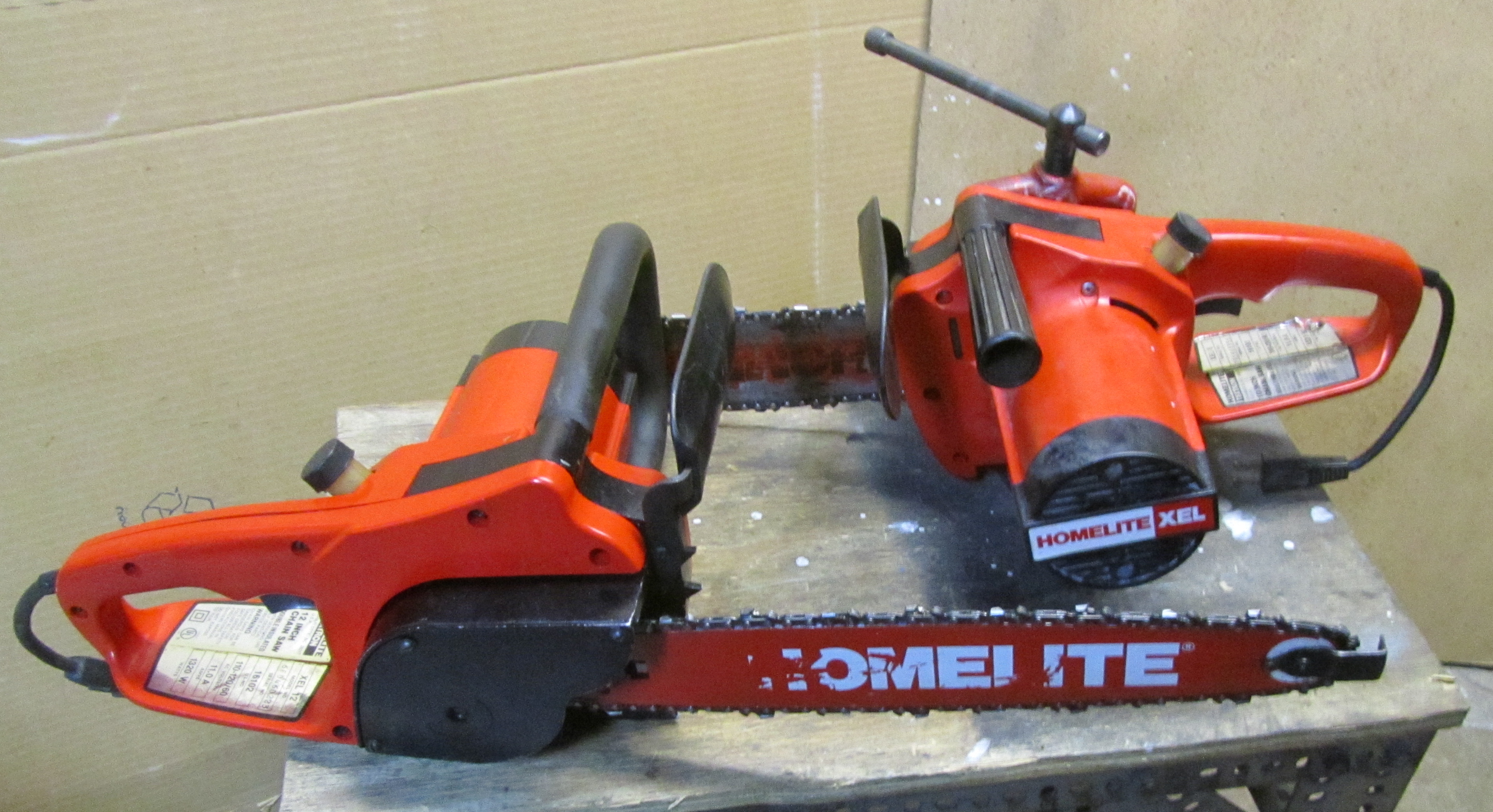

Somewhere along the line it must have gotten dropped because the side cover was all busted up. I found a parts saw XEL-8 on Fleabay and I scrounged the side cover off it. I opened it up and found a stripped main shaft and drive gear. Someone must have snagged a rock or rebar because both were missing teeth. I stripped it down for parts. I really like these saws with the steel gears and stuff. The new plastic gears just strip too fast. Then I went about searching for more parts. I found an XEL-10 intact but missing the bar. I put the 8" bar on to complete it. Now I needed a chain and NO ONE even lists it. A fantastic place called Frawley's Saw Shop supplied me with two of the oddball chains. Now it is a nice working XEL-8.
I scrounged an NOS armature/main shaft, new drive gear, chain tensioners, brushes, hand guards, chain scabbards, anti-kickback devices, lots of stuff. I could build a third saw but I still need a side cover. Pic is Fleabay,not mine, but same model.
