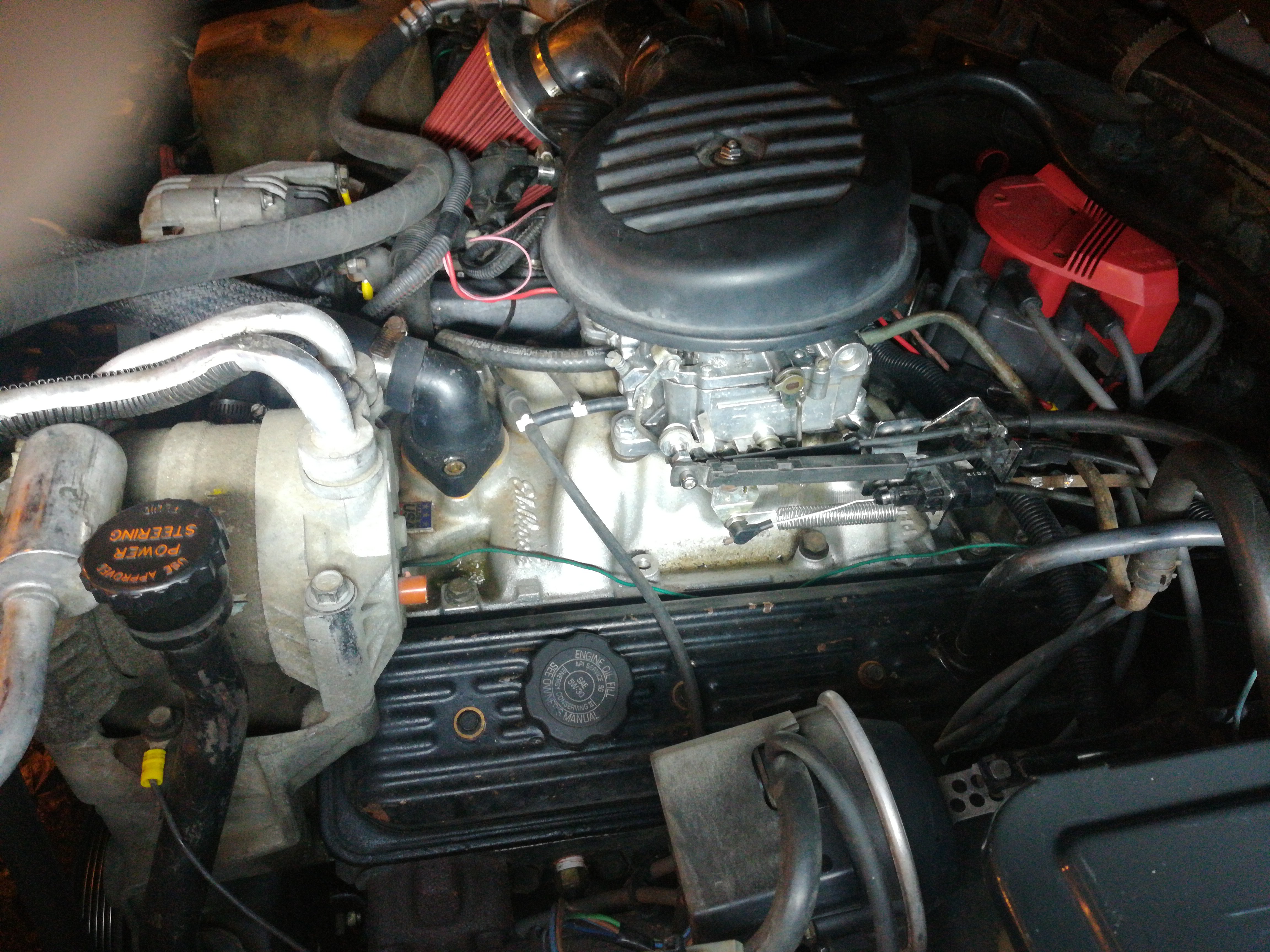

I changed my air cleaner out to the Durango air inlet with a cone filter on it. This helped greatly with hood clearance and allowed me to hook up my unused vent port on the drivers side instead of venting it to the air. I also moved the throttle return spring from pulling from the front of the carb to pulling the kickdown cable post to a bracket hidden under the kickdown cable. Due to some throttle sticking, I added in a longer bolt to help the cruise control cable clear the throttle cable mount on the throttle arm.

I would try to find a new spot for that filter
All its doing there is sucking up the hot air coming off the exhaust
This is not it's permanent home, I just need to get a longer (and not gaudy chrome) intake tube from the junkyard. I eventually want the filter behind the coolant bottle, but this will be fine until spring.
