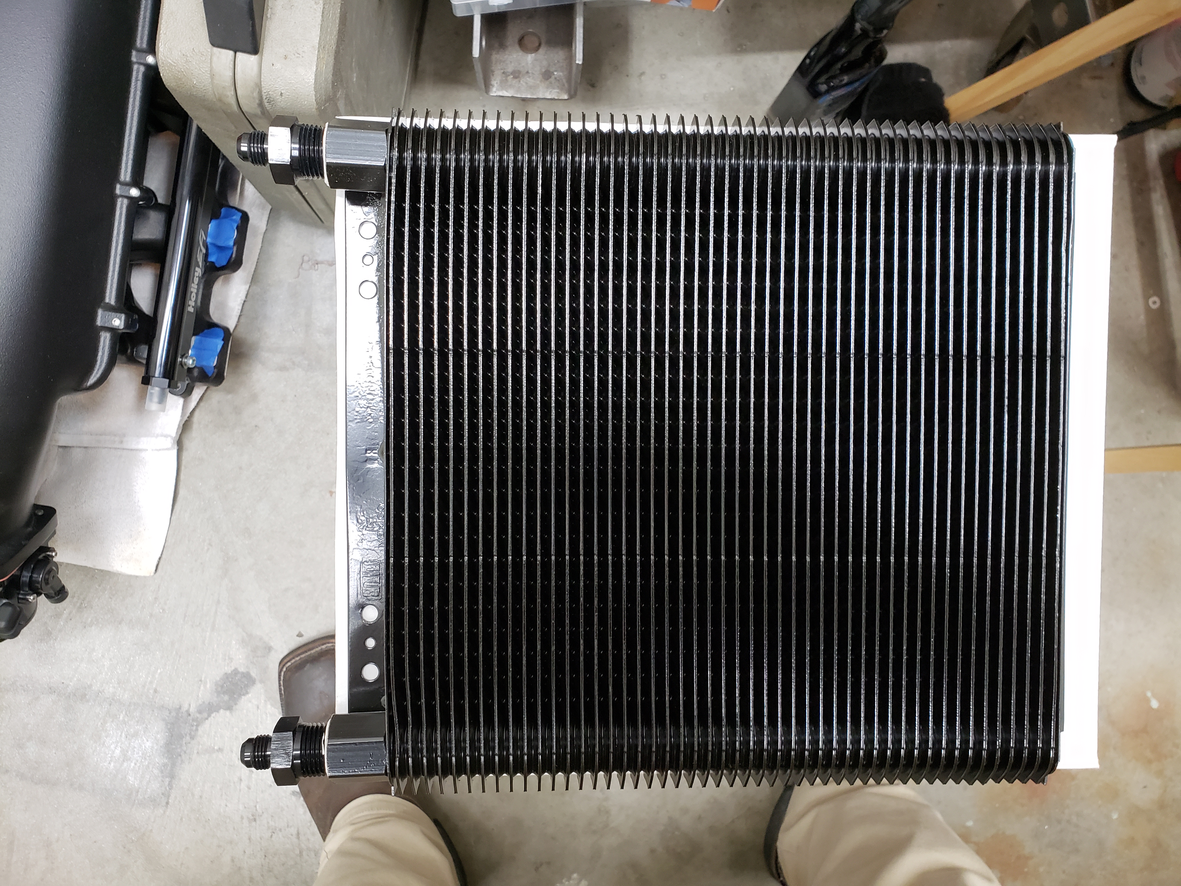

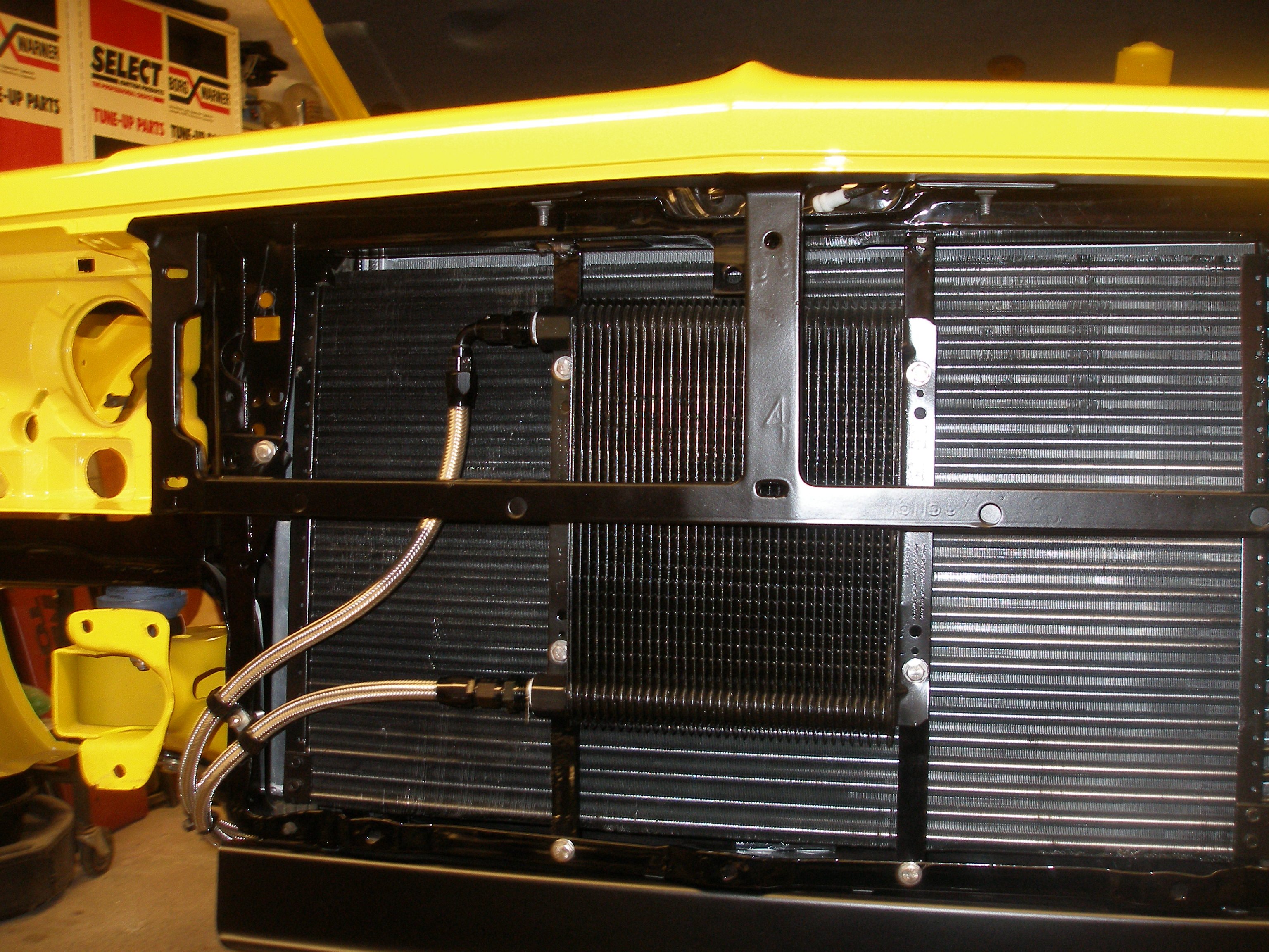

[QUOTE="Injectedcutty
I'm brainstorming for trans cooler mount ideas. The new cooler is too heavy for me to comfortably mount it to the radiator. i don't know if this helps you @ all but the holes were already in the support to accept these brackets i made.maybe you fit the cooler in front of the condenser.
I'm brainstorming for trans cooler mount ideas. The new cooler is too heavy for me to comfortably mount it to the radiator. i don't know if this helps you @ all but the holes were already in the support to accept these brackets i made.maybe you fit the cooler in front of the condenser.View attachment 108650
Haha, same cooler! Did you paint the front of your rad black, or is that the lighting?
My Cutlass doesn't have holes in the support, but it can with a drill bit lol.
Issue I have is the cross braces, and I don't have A/C so no condenser to worry about.
