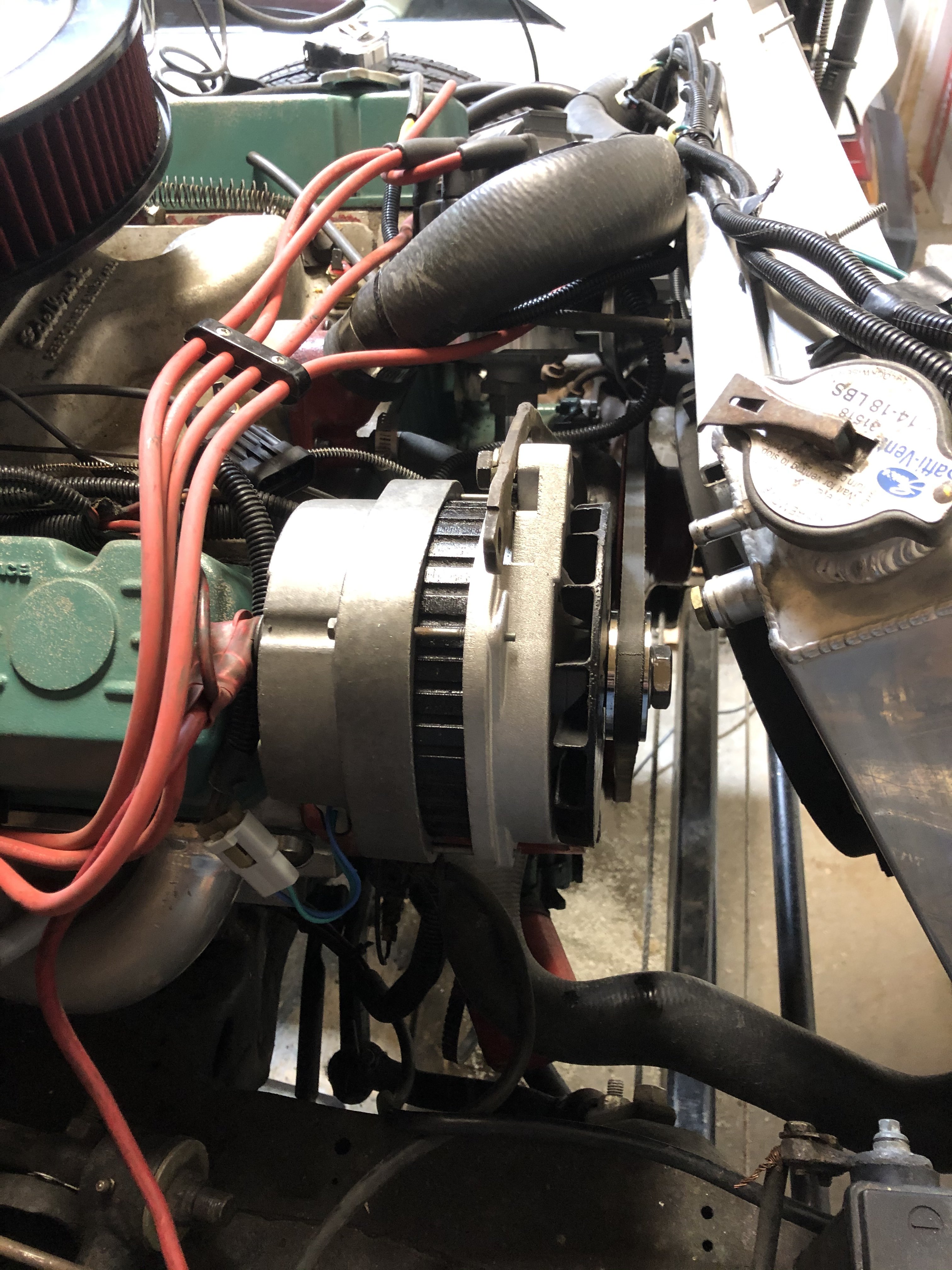

I installed a CS 144. 140 amp alternator on my red car today. Had to reclock it 180 degrees, install an adapter and lengthen the top bar adjustment.0ED24B31-8D87-4D4F-911F-656FCD741296.jpeg
I installed a CS 144. 140 amp alternator on my red car today. Had to reclock it 180 degrees, install an adapter and lengthen the top bar adjustment.View attachment 165132
Wha? I knew this was a thing on my GMT400s but didn't realize that family of alternators went back so far.
