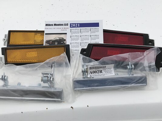

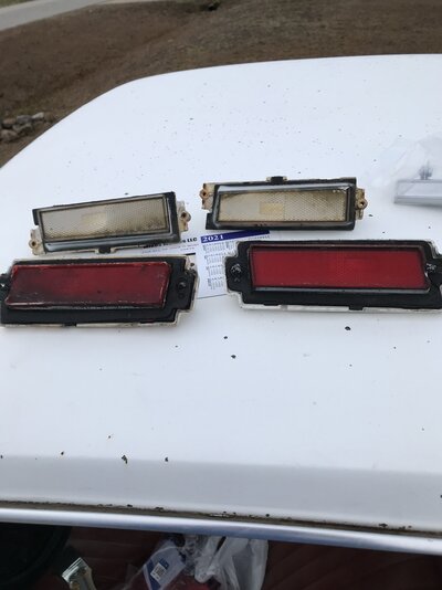

thanks to mikes montes I replaced front and rear side light markers

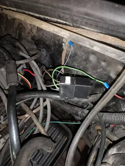

After getting some weird hard starting issues figured out, I had to change my wiring to the fuel pump to add a relay in.
I had been running the fuel pump off an oil pressure switch, but I was starting to see a voltage drop across the switch which was making the fuel pump lazy.
