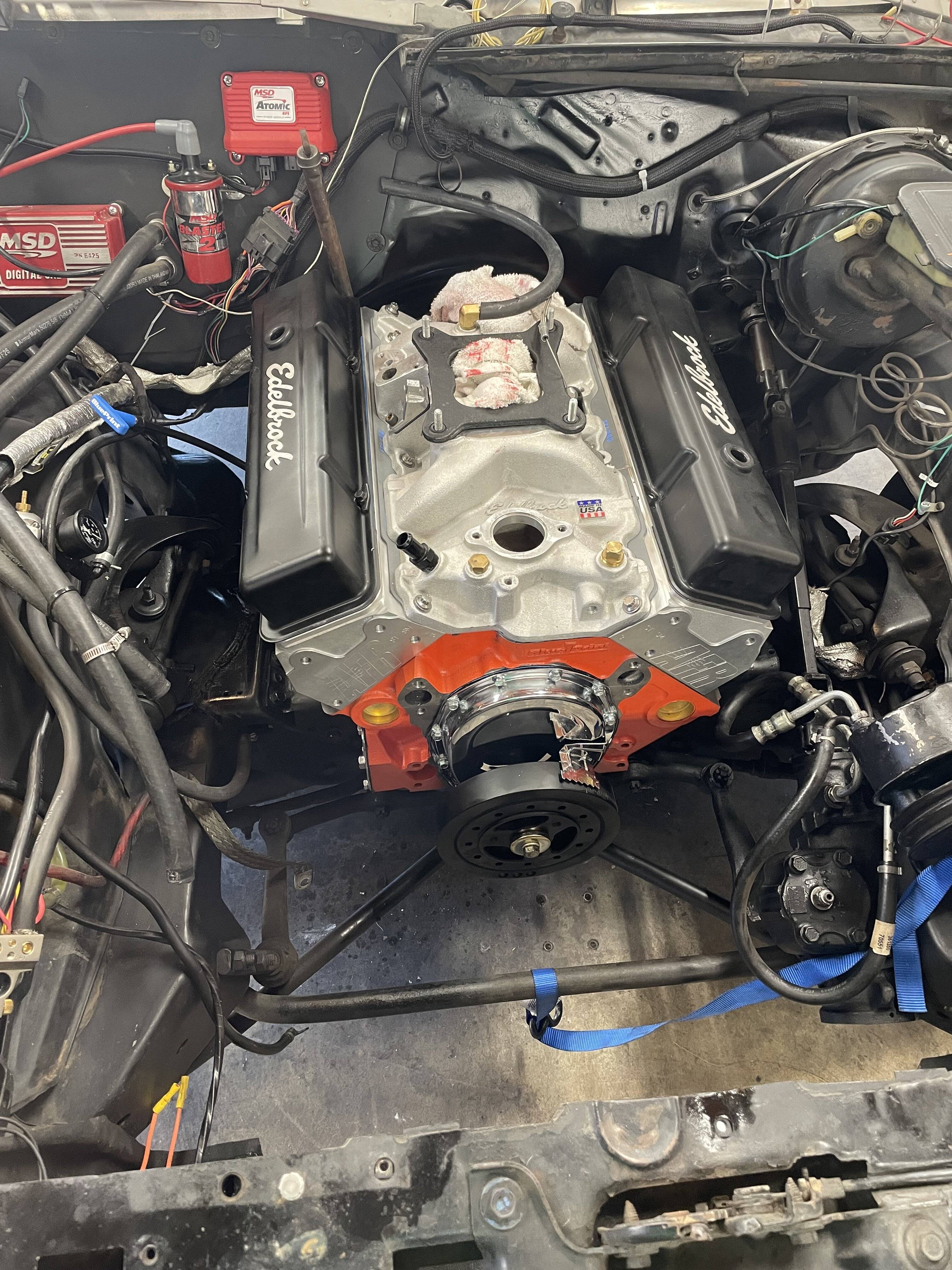

.030 over 350 truck block... 3.75" crank, retrofit roller(225/231, .501/.509, 112deg ils), edelbrock rpm heads, edelbrock streetmaster s.p..
Meant to fit under a ezefi throttle body. I ran this combo years ago, but couldnt figure out a wobble that never went away until i took the crank to a machinist who wouldn't set it up on his balncer. So... i had a complete rolling assembly re installed and finishing up several million little naggers until i can hear that beast run without loosening every bolt on the engine all by itself.
Kid you not! Couldnt keep an air cleaner tight, distributor would loosen itself, broke a bellhousing due to loosened bolts on it... a nightmare.
All reassembled and waiting to return home.
