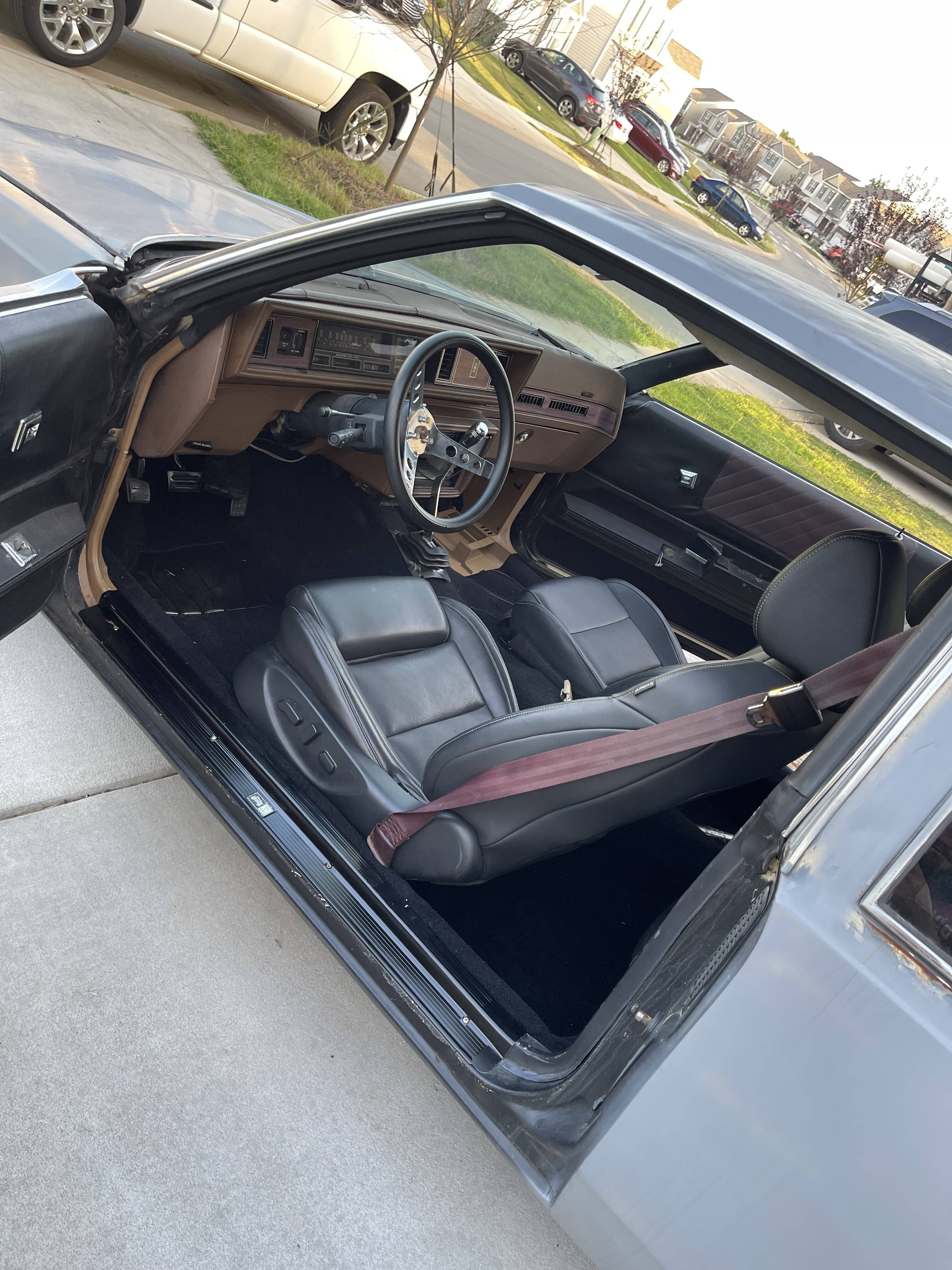

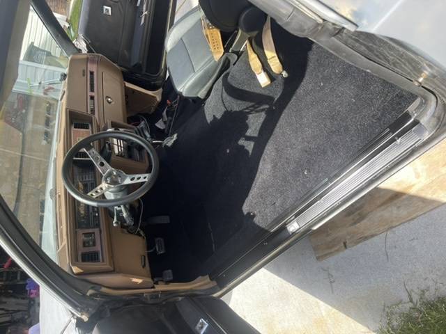

Finally finished the carpet although I’m super happy with how it came out. I think it’s just the shifter and how I cut around it.

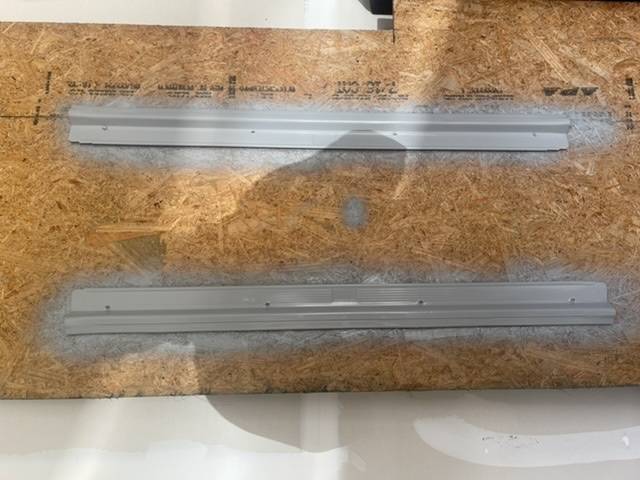

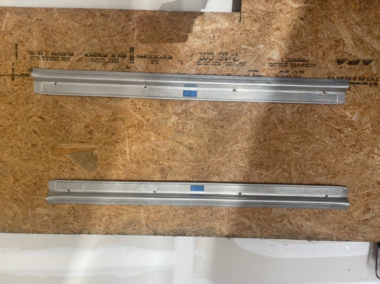

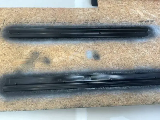

I paint the old sill plates. I couldn’t find my nice ones but these came out decent.
Put the seats in buttoned most of it up. Then took the kids for a rip around the neighborhood, and did some groceries.
Hot start problem seems to be gone as well!
