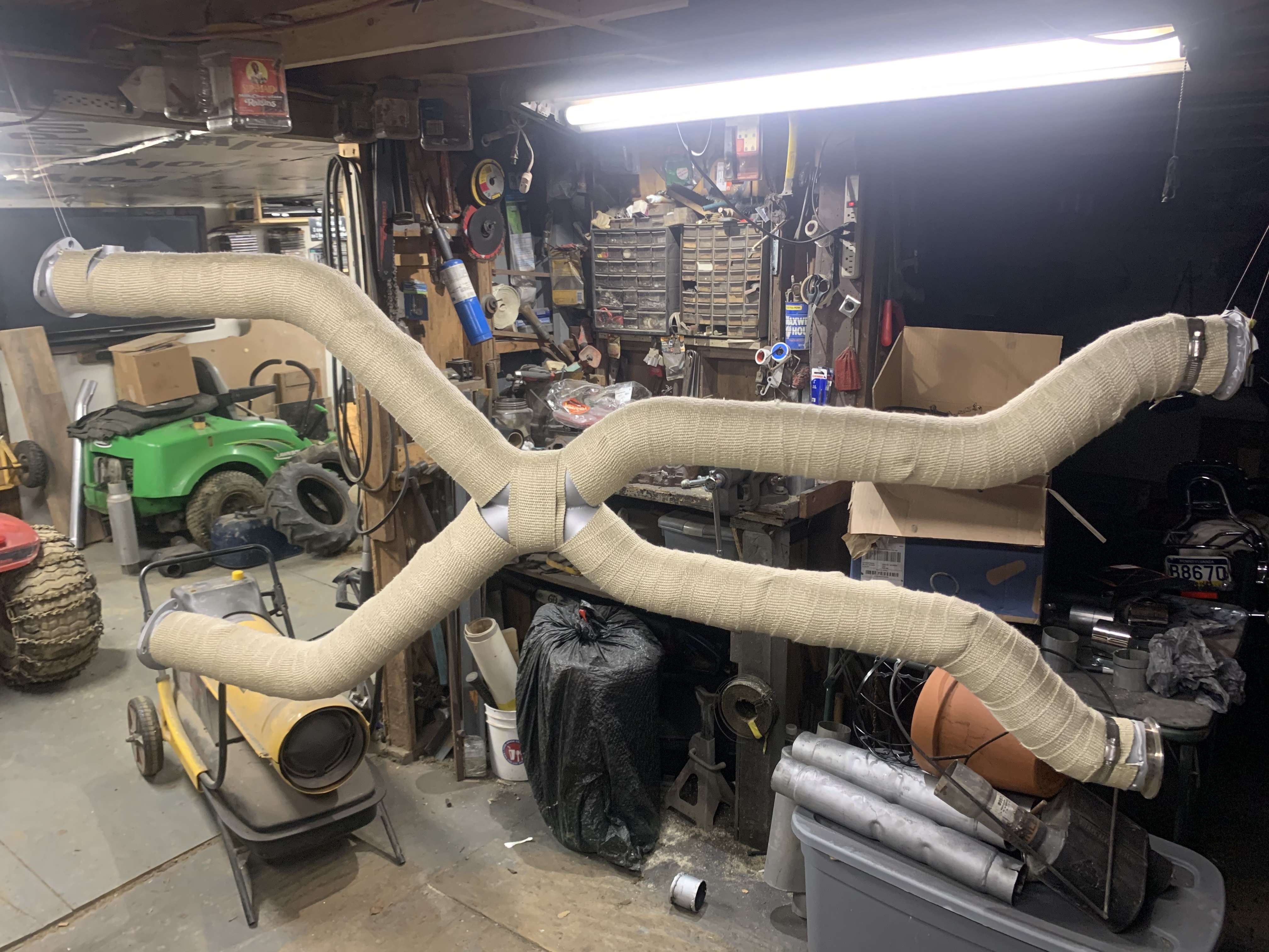

Got my reviseified X-pipe painted and wrapped over the weekend.
And after a bit more looking and some test fitting with the old Flowmasters that came with this, I think a pair of offset/offset mufflers will work. But I’m wondering if I should make the connection a V-band connection or keep it a slip fit.

did your exhaust system sprain a bend? it's got all that Ace bandage wrapped around it! 😁

I thought that exhaust was floating in mid air until I saw the strings holding it up. I'll blame that on my misspent youth.
