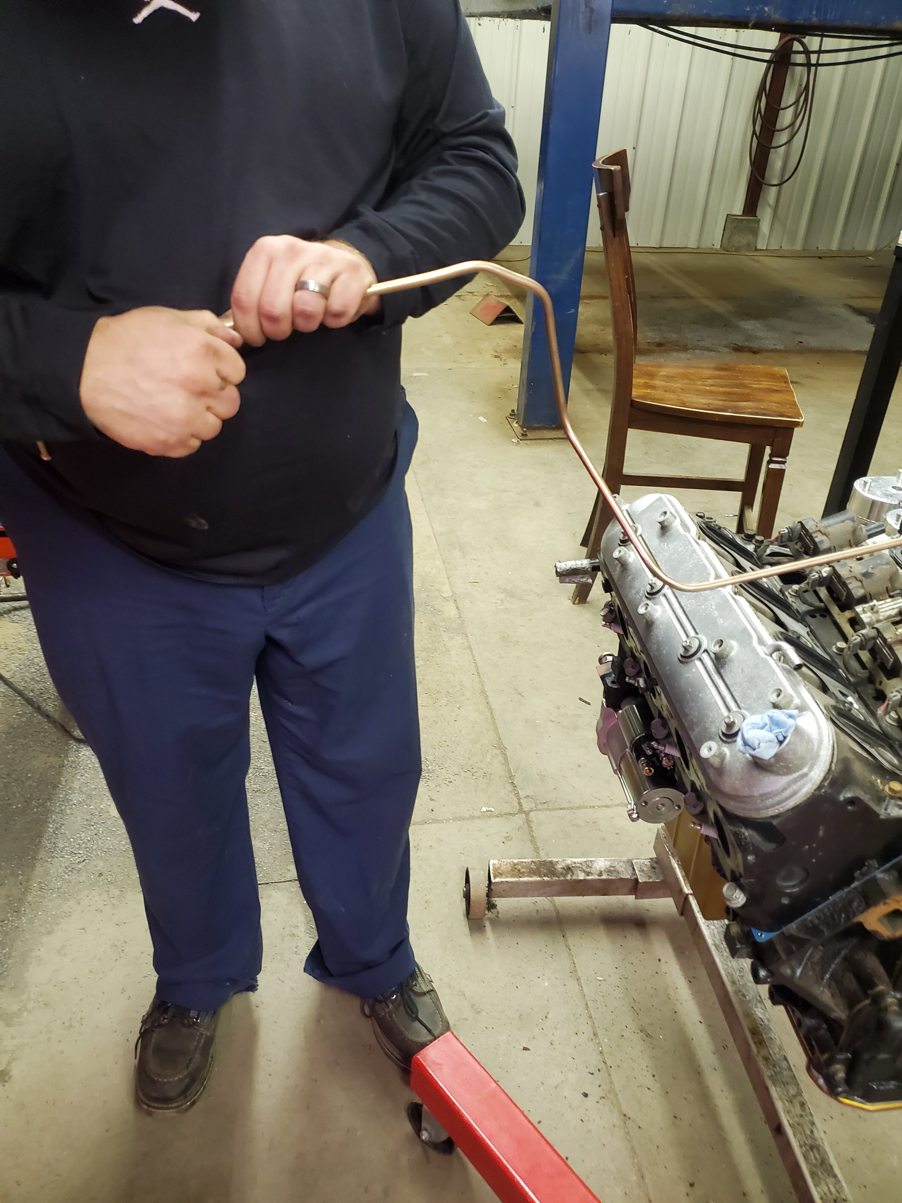

Another weekend of adventure, tried to get the transmission line to stop leaking. Got a replacement fitting from the transmission builder, tried to tighten it one more time before swapping to the other fitting without success. So change over to the new fitting and it leaked worse and also from the line itself now, so continue to mess with it. Decide that the nut may be off shape and causing a leak so run to the store to get a new line and bend it up. Install that and it still leaks, we were about to hit the roof with anger. My buddy had a transmission sitting form what he pulled from his Camaro when he swapped over to a stick. So we take that fitting off and try it, it seems slightly different but for some reason that stopped the leaking so we called it good enough after a very long adventure

I blew one of these apart in 6 degree weather with a high pressure hose clamp. I HIGHLY recommend a compression union/barb dealie.
Drove it home.
If he has a bubble flare on the end of that metal line that will help. Just enough to have a bump not the full bubble that closes off the end.
Agreed. Tough to know from behind the keyboard.
