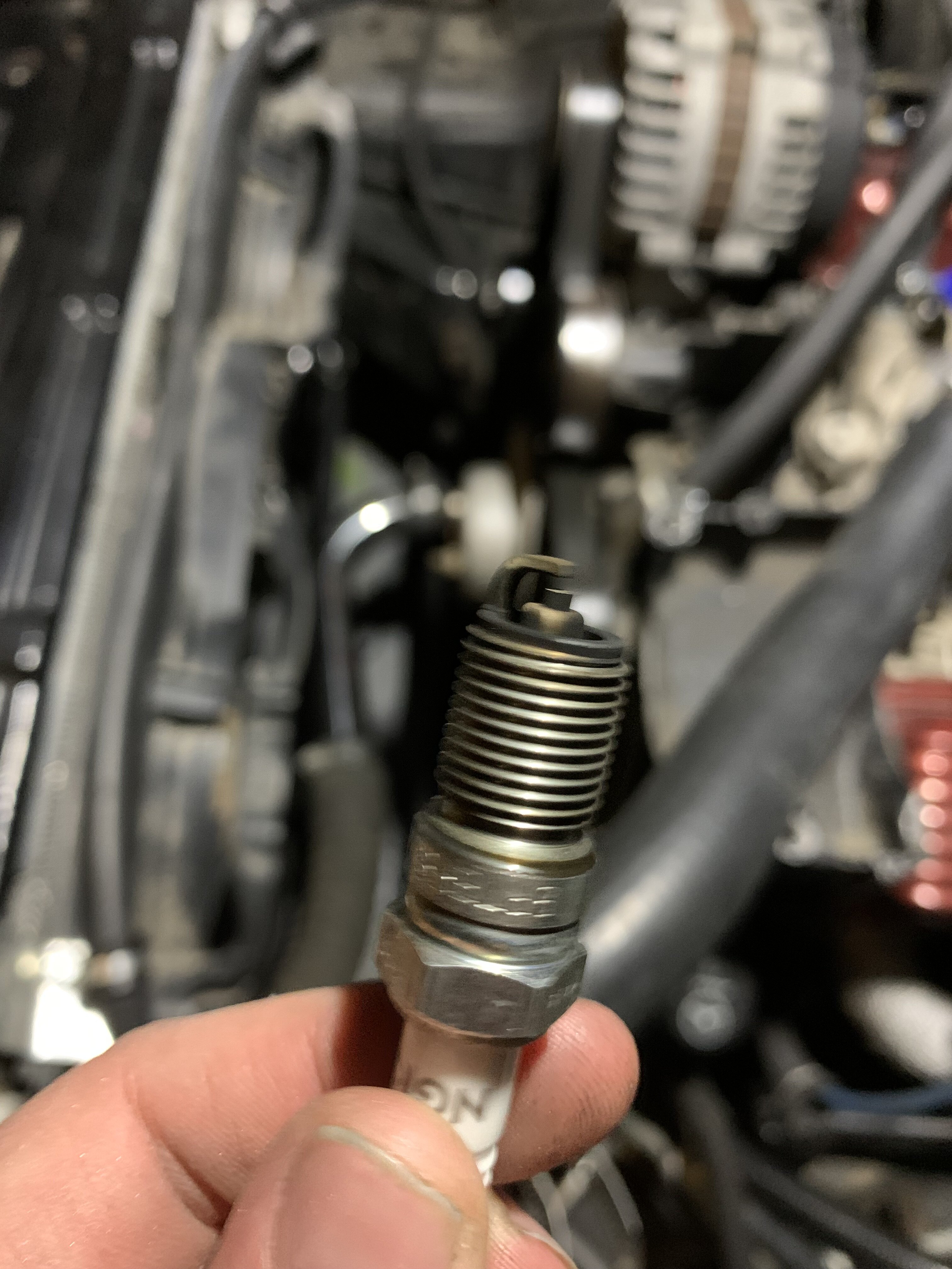

Gave it 2 more degrees of initial timing, cleared the lope right up. Left it idle for 10 more minutes and pulled the plugs:
No oil on any threads!

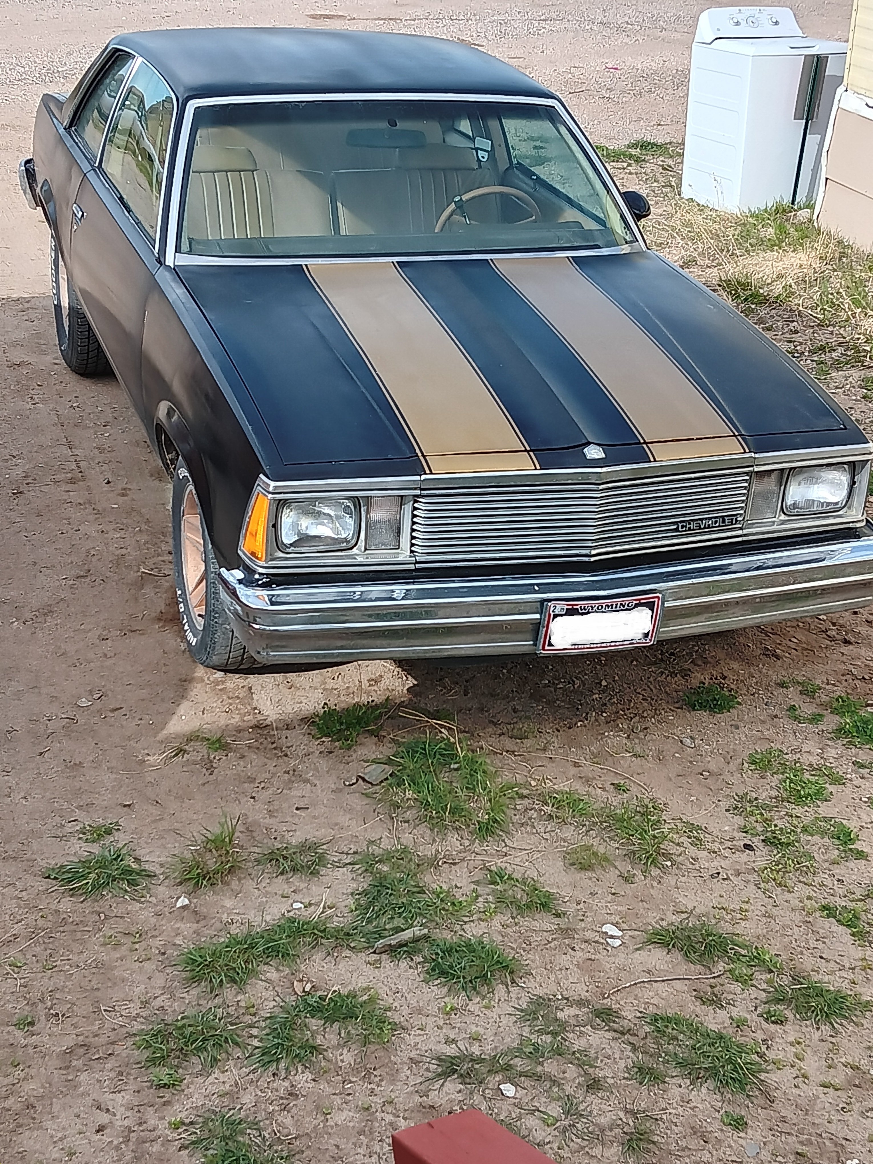

First I got new Rear Shocks put in to it this morning. Now that we have a warm Spring day I decided to put the Stripes on the Malibu. this particular set of stripes was probably the most difficult to work with as the adhesive of the back was very rough to pull off causing the decal to lift off the surface and bubble. This set of stripes came with instructions for using either Wet or Dry Methods. Stripe on the Front left/Driver side gave me the most trouble I used the dry instead which seems only slightly better for this Stripe Decal. Luckily I had bought enough to cover any mishaps that may happen and I have enough for when I can purchase Front and Rear Spoilers. Still trying to decide if I want to do the M81 side stripe I planned. . . That's another forum posting I'll update.
