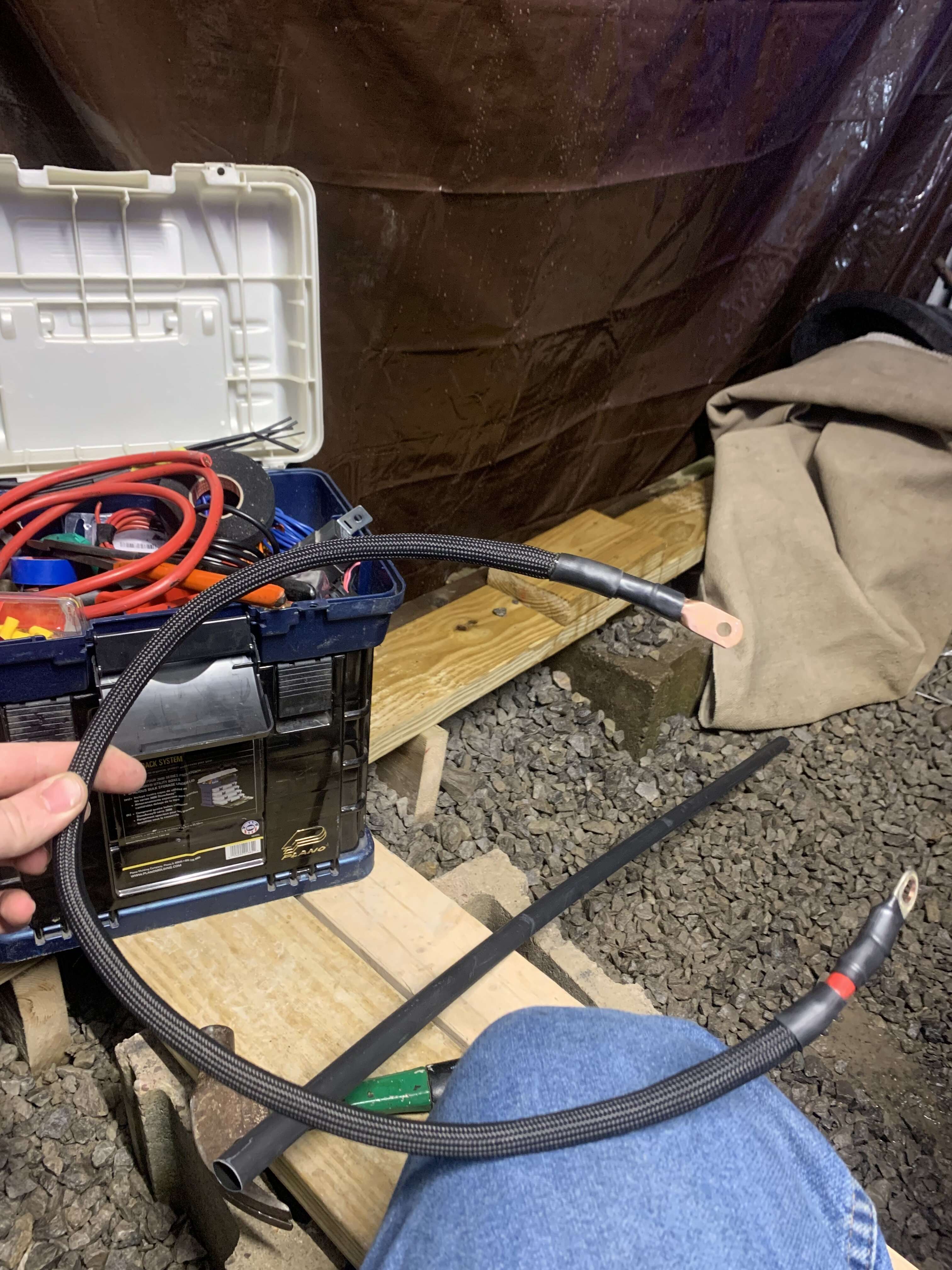

Stuffed the revised accessory panel back in, and ran the main power and ground wires for the panel. Wrapped them both in braided nylon from Techflex, well worth what little it cost for 25 feet of 3/8 braid.

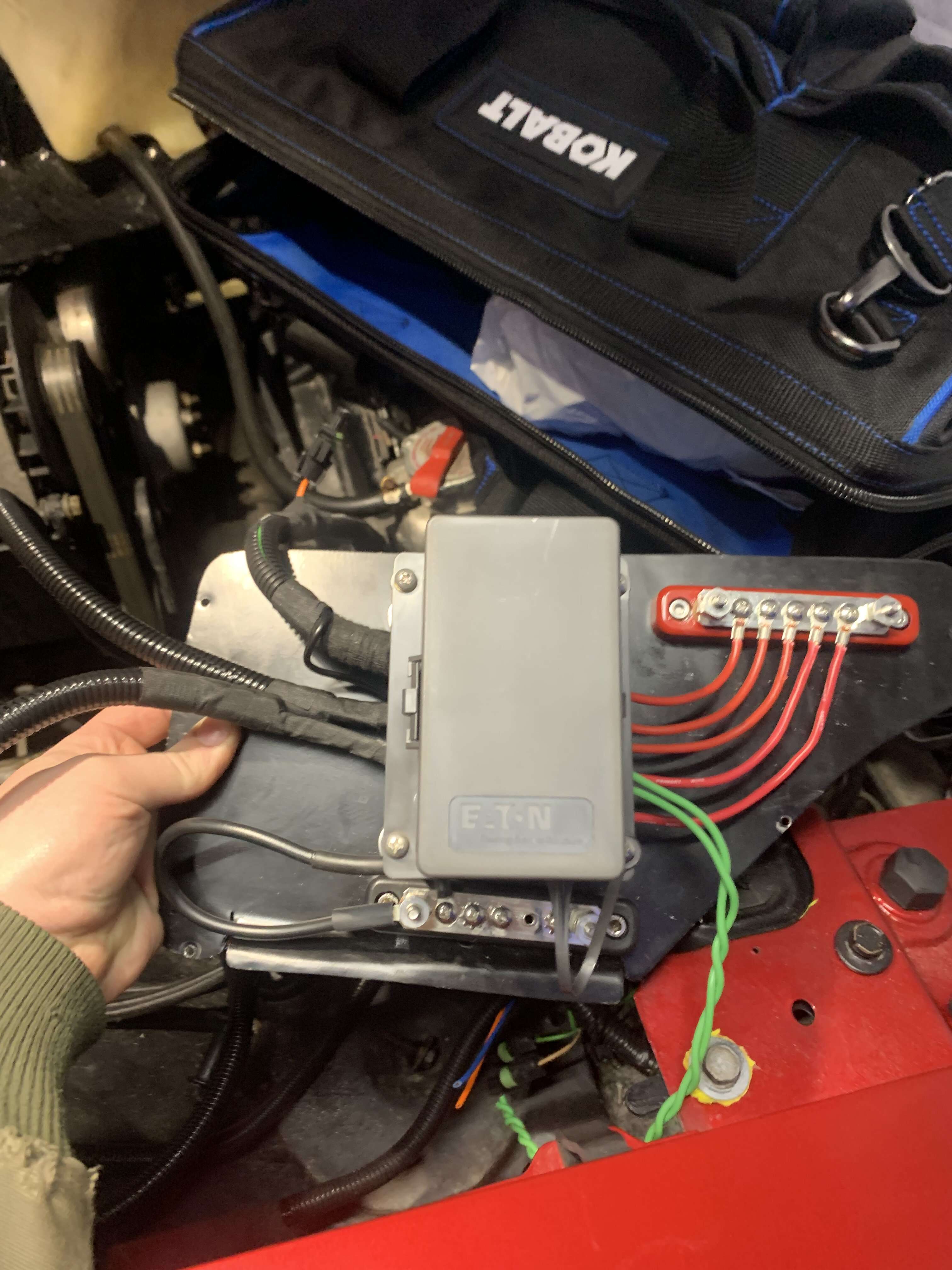

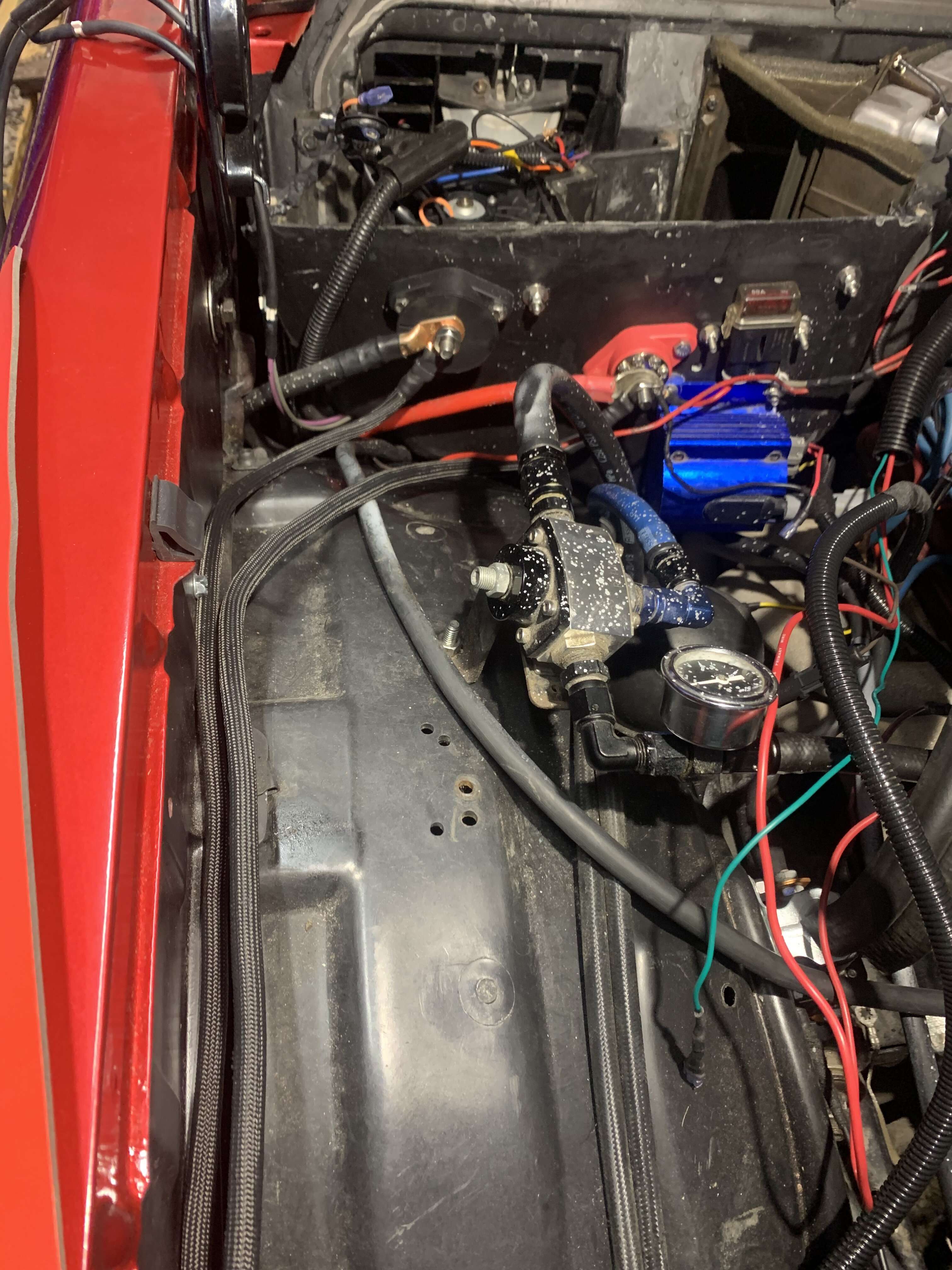

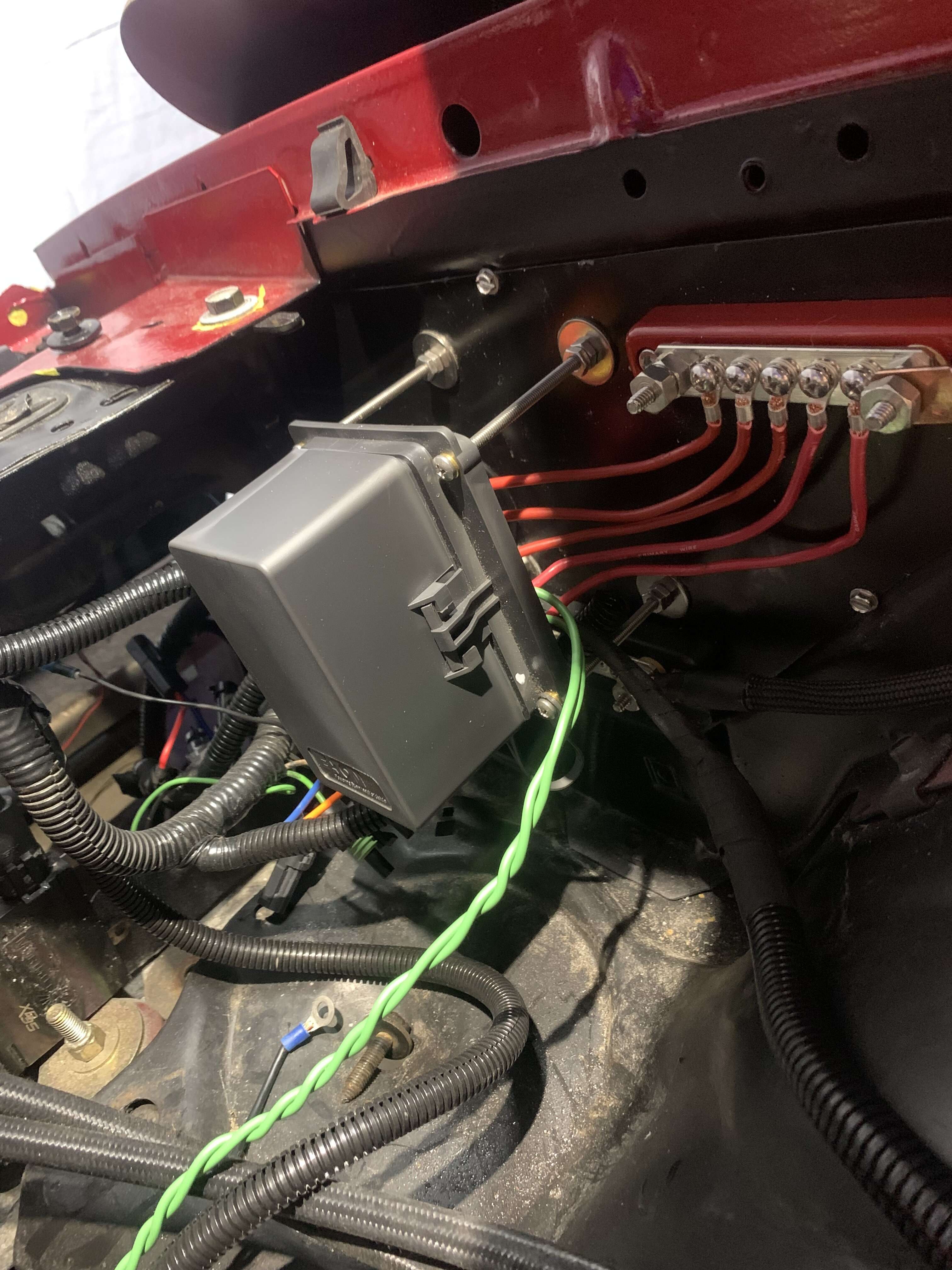

I was limited on where I could put the distribution blocks on the heater box because of the new blower fan on the ground side, and the overall length of wire I had for the main power. There’s going to be 2 extra runs of 3/8 convoluted tubing over here, one for the ignition, and one for the fan switch wires and the starter relay wire. All grounds that were previously located on the fender will be moved under the accessory panel. The fan relays have been moved into the panel instead of being out in the open, and I’m using one relay for high and low beam on the headlights, instead of individual high/lows for left and right like before.
And if you peep above the ignition coil, you’ll see a maxi fuse holder with a 50 amp fuse that’s now running the car’s factory harness instead of 2, 30 amp in line fuses.
