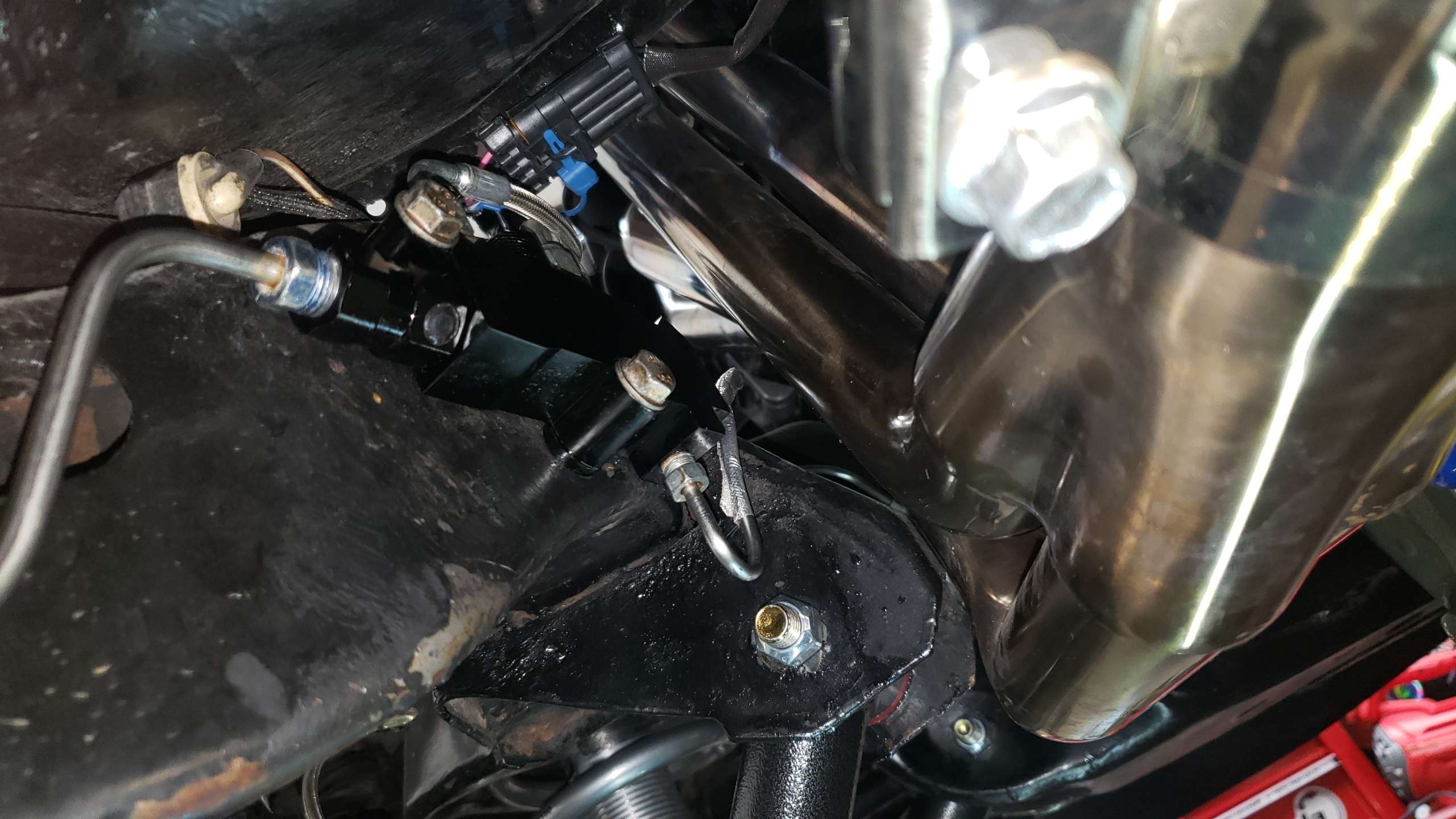

Did a job I've been dreading, swapped the stock style distribution valve to a disc/disc unit. I found an aluminum one that seemed stronger than the brass ones I've had prior issues with. I followed the video that Texas82GP linked in my build thread for proper seating of the lines. Seemed to have worked mint!
However, I think the right rear caliper is bad maybe. Once I changed the crush washers (yep I forgot to install new ones at first) I tightened the banjo bolt to what seems a proper torque. Can't get a socket on it due to interference with shock, but that bolt is tiiiiight and its leaking like a sieve!!!! I called it a night and plan to look again at some point today. Might pull the caliper and try to torque it. Weird cause the other side is dry and did the same procedure.View attachment 214267View attachment 214268
When I torqued the banjo bolts on the Blazer front calipers on the Grand Prix they seemed fantastically tight before the torque wrench clicked. I thought it was going to strip out or twist off for sure. If you're sure it's tight enough, you might check for a burr on the shoulder of the bolt, on either side of the brake hose or on the machined surface of the caliper.
Jared, I actually just checked torque and it was fine. I'm a dummy, the bleeder valve (speed bleeder) is leaking the fluid down onto the banjo which made it look like the bolt doing it sheesh. I'm glad its not the bolt, but now trying to figure out why the bleeder is leaking is concerning considering they're correct for the application. Its always something.
Just keep swimming. You'll get there. The work looks great, as always.
