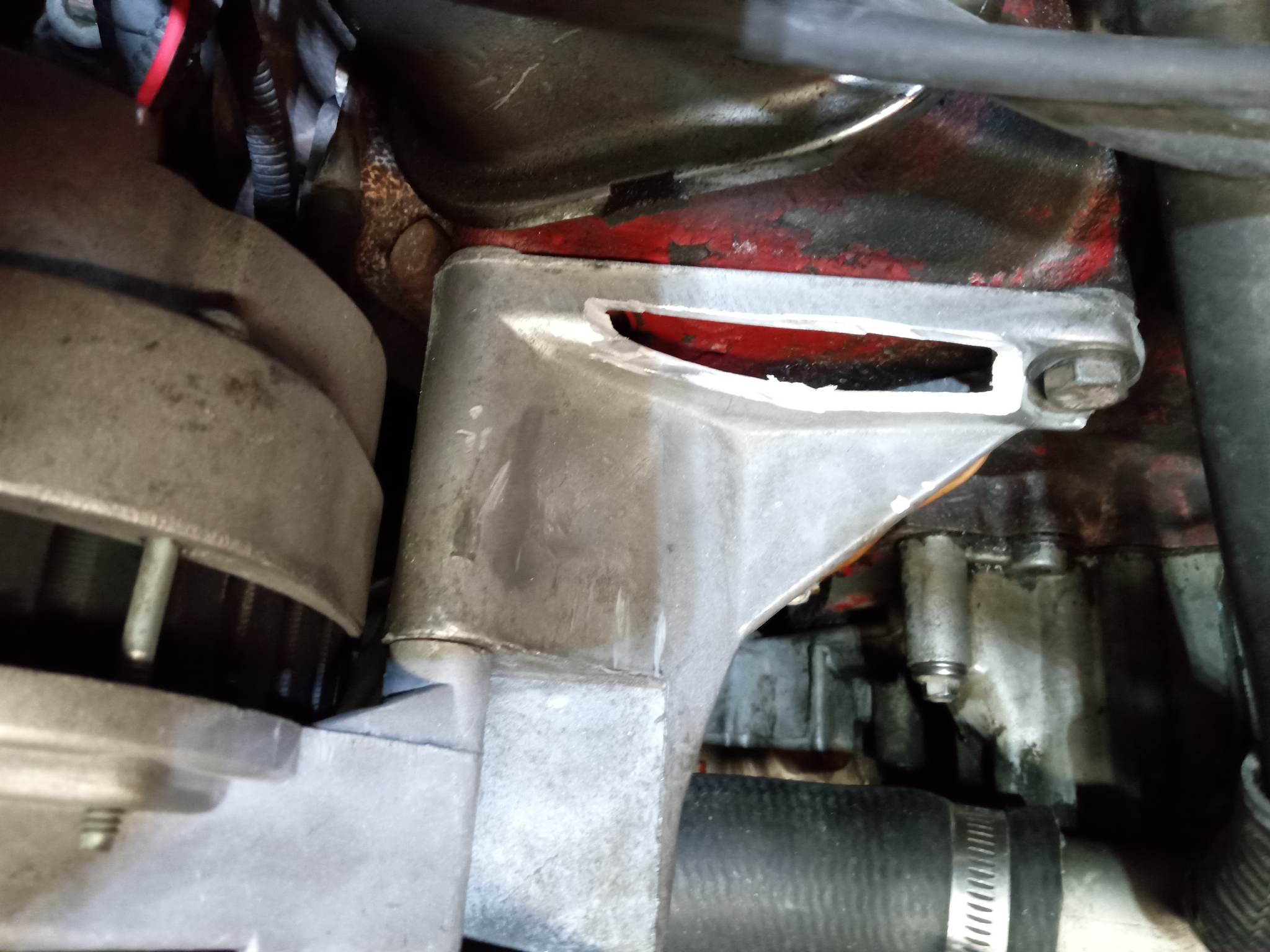

Also it hurt my soul but I had to slice some meat out of my alternator bracket to get some adjustment back. The CS144 has a different case shape than the 12si i had so it would only take a 47" belt and would barely get tight enough to not slip.
Is this a stock GM serpentine setup? I had been wondering if I'd have to trim some of that bracket because of the alternator upgrade. Good to see someone has done it already and it works.
