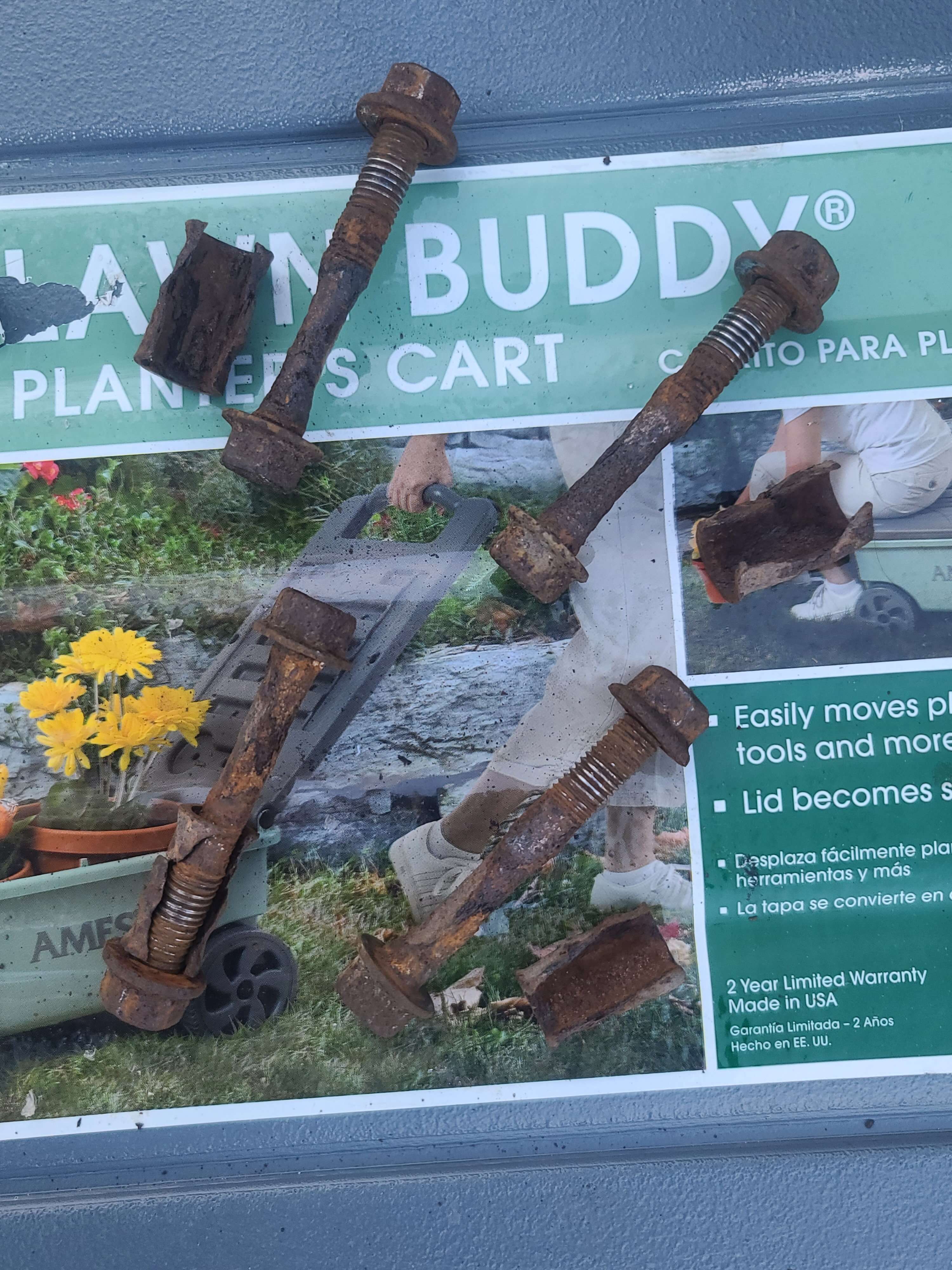

Pulled a frame today.... it was "free" aside from labor and gas - we had to pull an engine/trans/rear end out of it and leave them behind, but I'm not sure what I'll do with it as it wasn't as nice in person as I was let to think.
Front control arms are great shape, and most of the frame is pretty decent, except some of the body mount holes. Most of it is standard 'washer repair' fare except for the last rearward on each side.
Rh:
Lh:
The left hand REALLY surprised me given how thick the metal usually is there. No rot o. The rails themselves, just the mounts and the rearmost ones are just, as said, those last two are horrible.
But for all that, it even has the factory dual exhaust hangers that I haven't seen on anything but low mileage/garage queens for a long time. So... it's not a waste, lots of little parts on it that ought to cover our fuel and labor.
I had expected it to be something I could take apart, have powdercoated, and build a nice frame to have something ready to slide under one of my 83s, but... those last to mount holes may render it parts and scrap metal.
