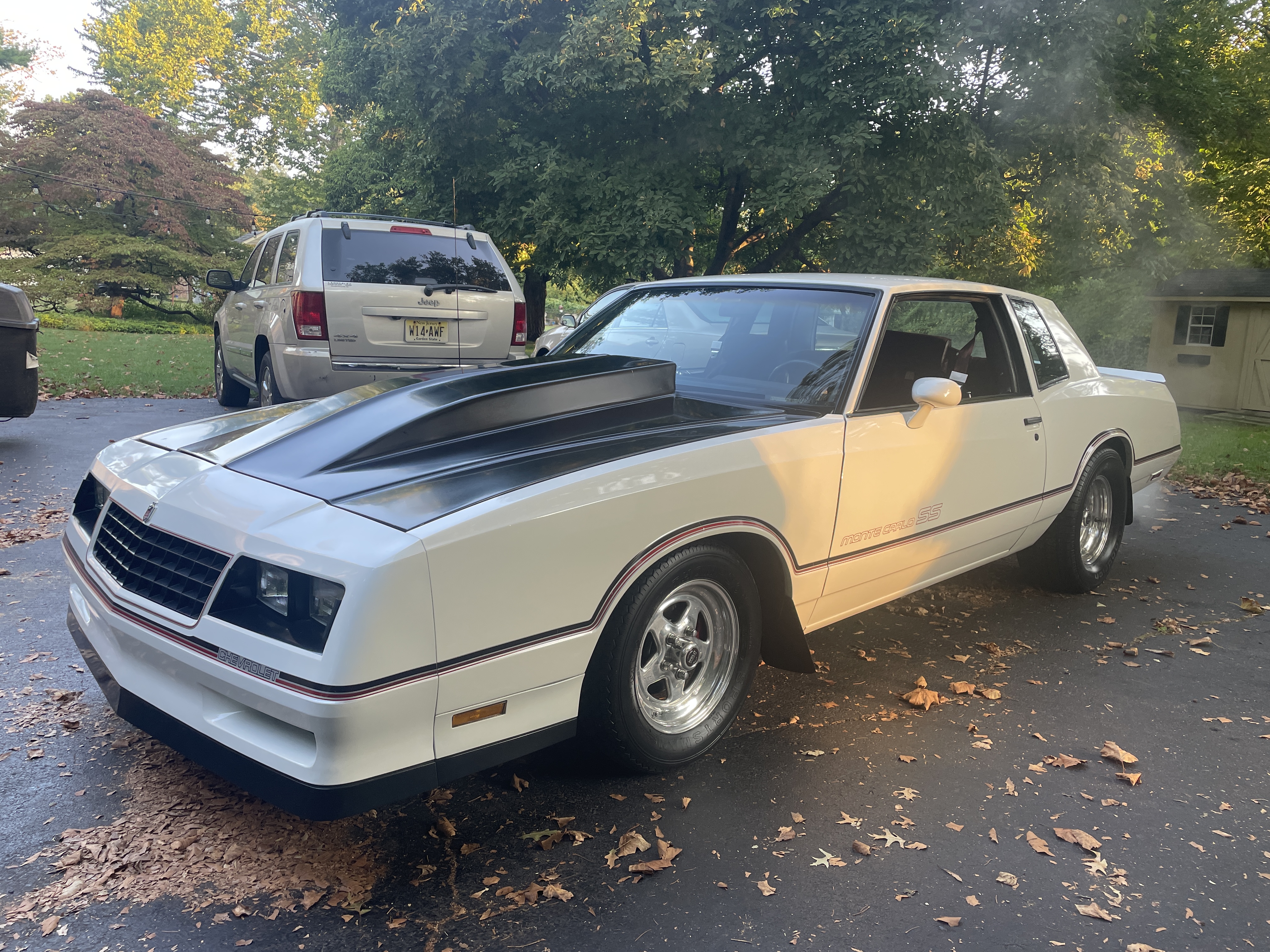

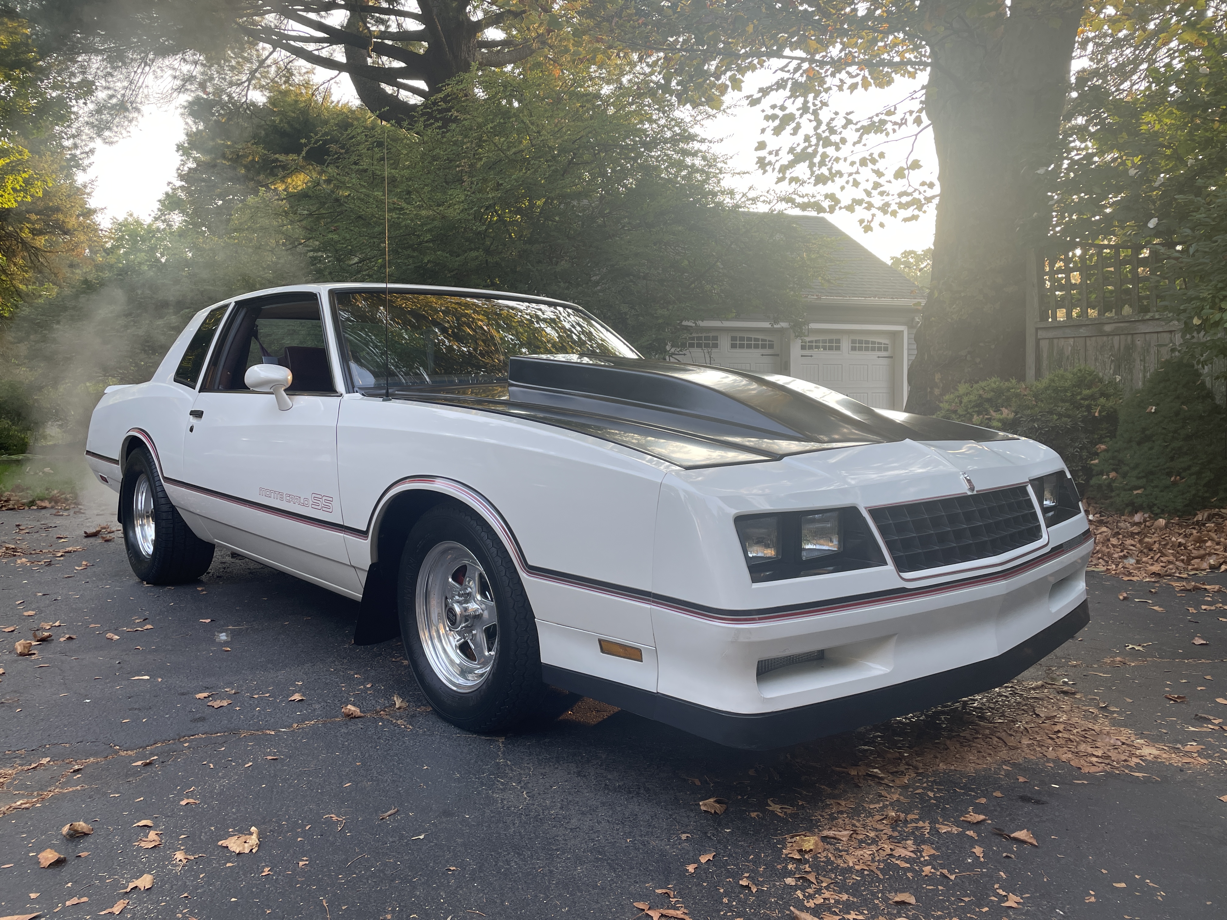

Put on a new Harwood 4" cowl hood. I removed the circular coil spring and left the entire hinge there - lined up and works perfectly! I will be getting it painted to match, don't worry.
How’s the fitment on that? I’m looking to buy a fiberglass hood in the future and opinions on all the manufacturers are a seesaw to say the least.
It fits great! Using the stock hinges helped since those were already lined right up. I had to adjust the side-to-side fitment slightly, but that took literally 5 minutes total. I say go for it!
