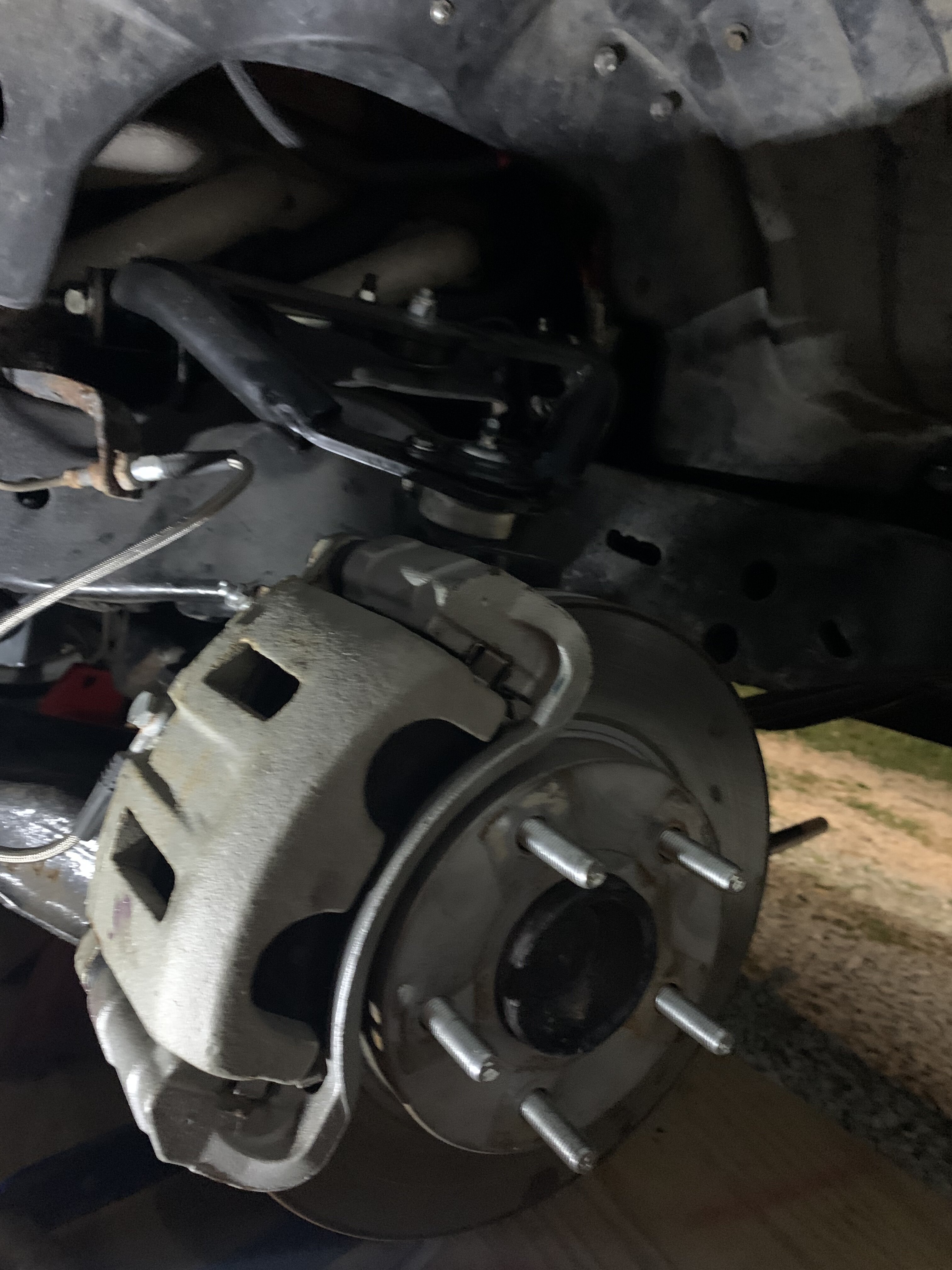

After a chat with Mac from SSM on Wednesday, I changed out the tall upper ball joints for stock units and changed out the front wheel studs for longer units to use spacers.
A 1/4 inch spacer keeps the wheels off the control arms, and the UBJ change gained me 2 degrees of positive camber. Tomorrow afternoon I’m going to attempt to use an angle gauge and a level to get the camber setting back in spec.

I was running a set of 1” taller Proforged units with .5” taller lowers. The Speedway uppers I’m running are just copies of the stock units, with a little more caster added in but no more angle on the ball joint pad.
I think the uppers were binding and asked them about the travel their joints had, that led me to find out on a 3 inch front drop, the ball joint is above the pivot point of the control arm. And that was causing some wacky UBJ angles, on top of making the camber curve way too extreme.
