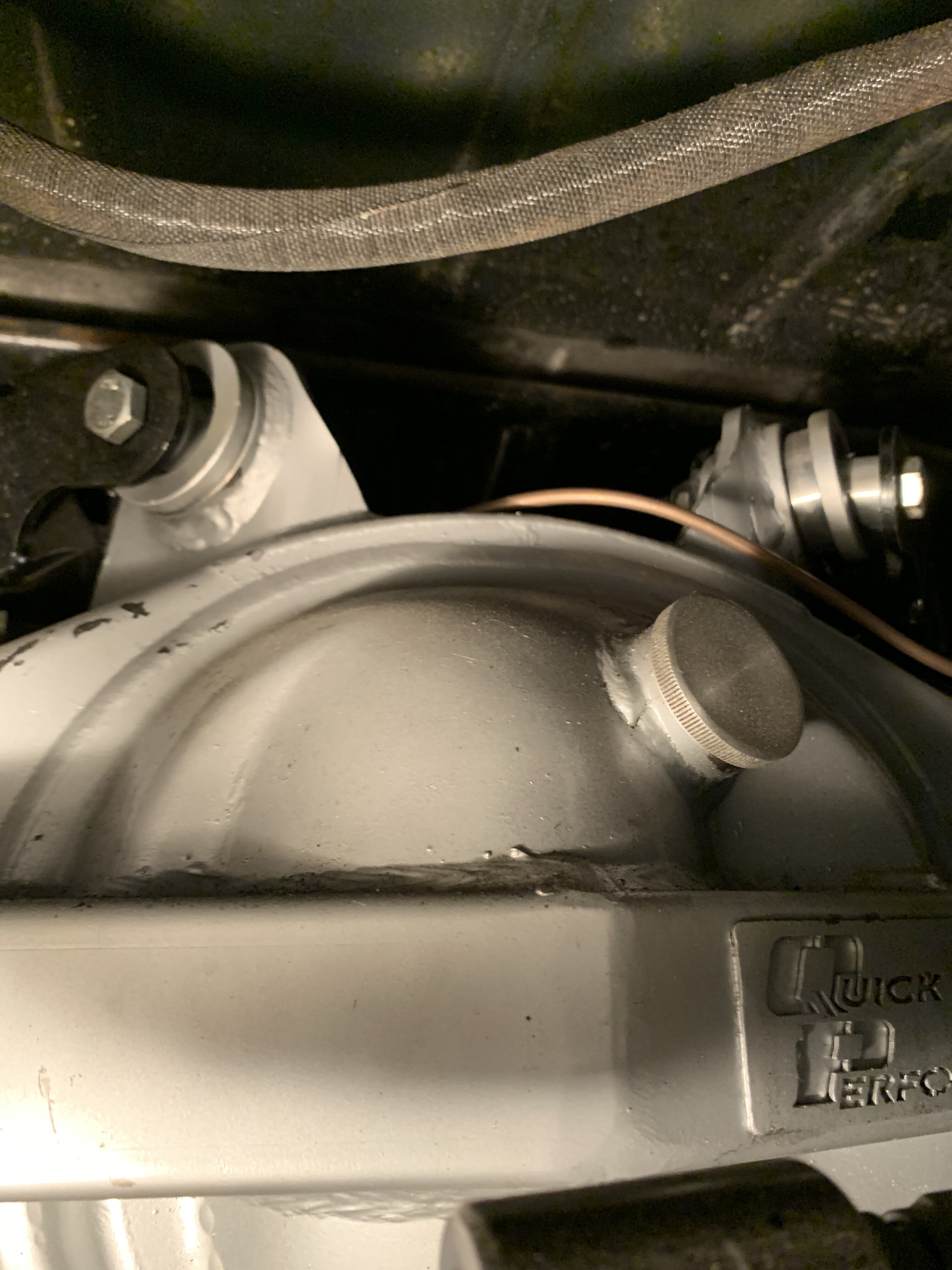

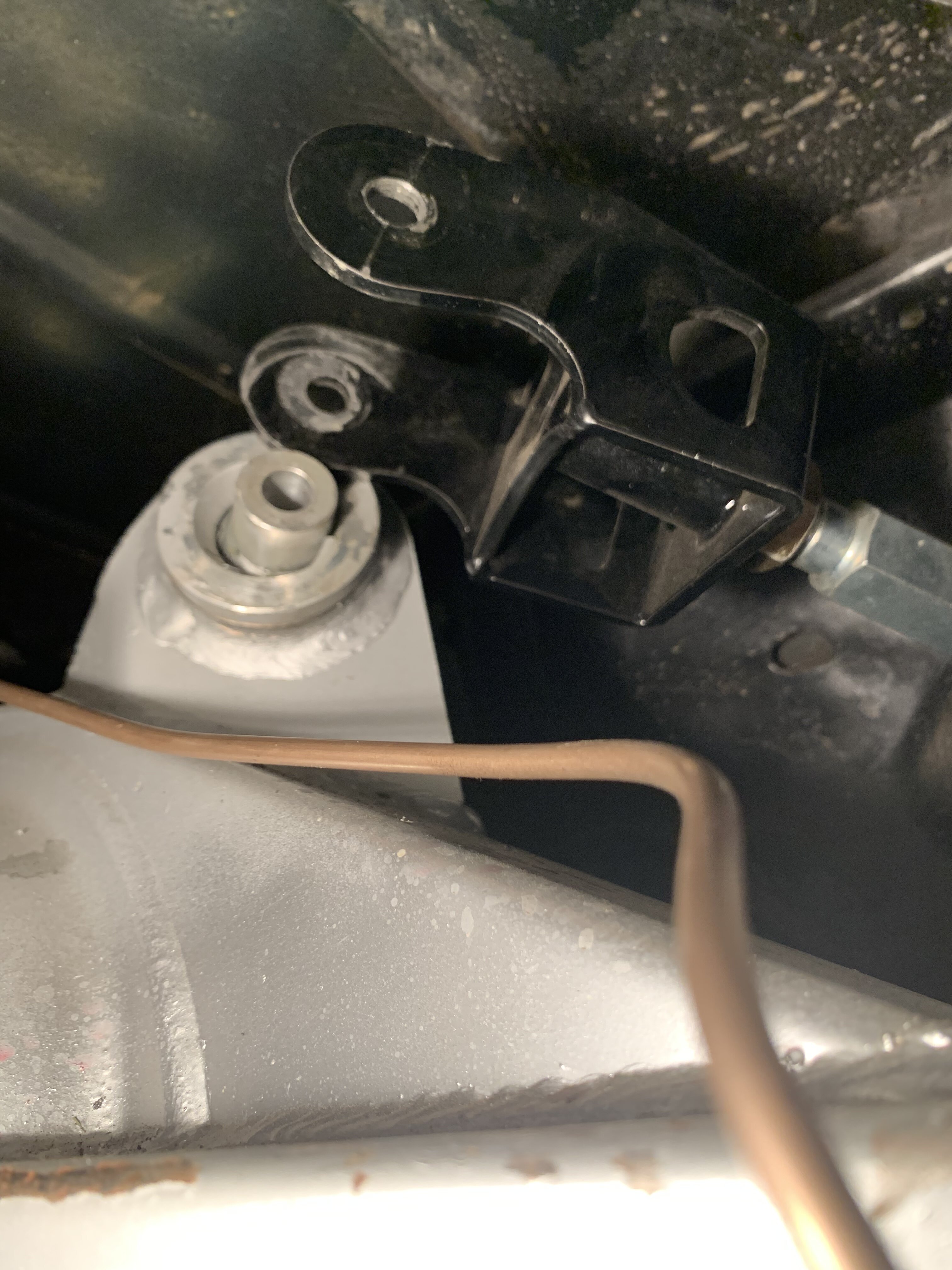

Was also fighting really twitchy steering for the past month or so, changed the center link and idler arm since they were shot, that helped turning left but turning right still had major issues. Just a small about of steering input nearly tripled the directional change in feeling, almost like the steering was going over center. Found the reason why when I got under the rear to check for leaks in the pit:
The spherical bearing’s locknut had backed off, fell off, and eventually wedged itself between the bearing and the control arm, shoving the bearing out and binding the arm up. I drove this for who knows how long too 😂
The arm, while marred up is fine. Everything moves freely and the steering twitch is gone. Guess it helps if your suspension actually moves like it’s supposed to!

I love the spherical's in the control arms like global west and the UMI stuff.having them in the housing has to be the best for these cars but I hate to see stuff like this happen.glad you spotted it when you did before something really bad happened.
I made sure to tighten the locknuts the first time around, but they’re just plain round aluminum so the only thing that fits is channel locks. Smeared some blue thread locker on it so hopefully it stays put now.
