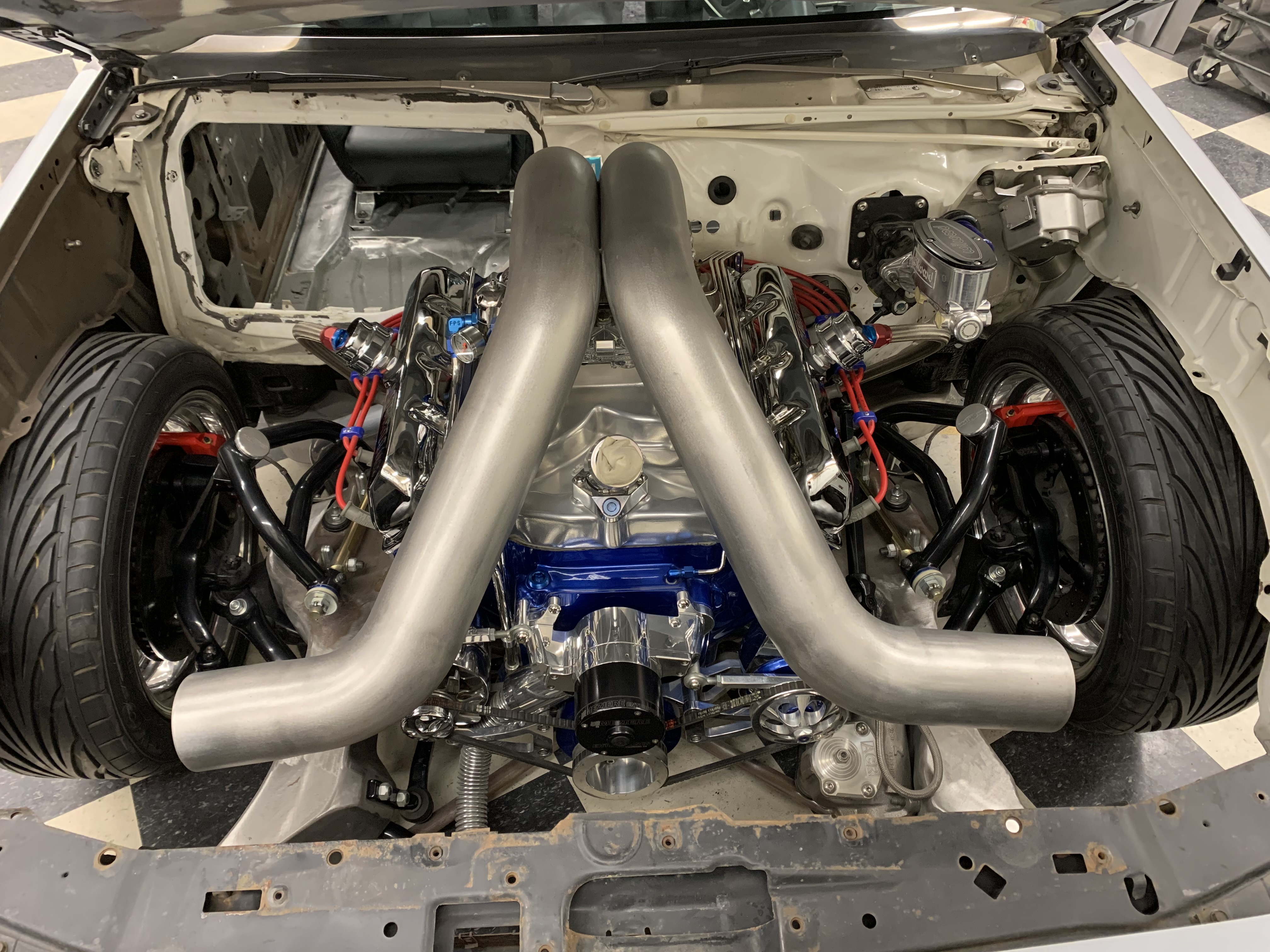

I've had these headers coated more than once over the years and I've never been happy with how rough the flanges were.seeing as everything surrounding them has gone to the wayside,this point there's really no difference i'd get them ready for blasting/recoating...again:popcorn:20241127_183812.jpg
Actually those flanges look to be a good candidate for some practice with a die grinder or air motor with a barrel bit chucked into it. When i dismounted the factory exhaust manifolds from my Orphan LS motor, they were chock-a-block loaded with casting flash. By using the die grinder I was able to whittle away almost of it of and smooth down and blend the seams into the adjacent surfaces. For an open edge/face like those flanges I don't think it would take much to knock off the high spots and ease the edges so you don't come away with your finger tips looking like you were using a dull razor blade to remove your finger prints.
Reactions: MalibuDavyou5
