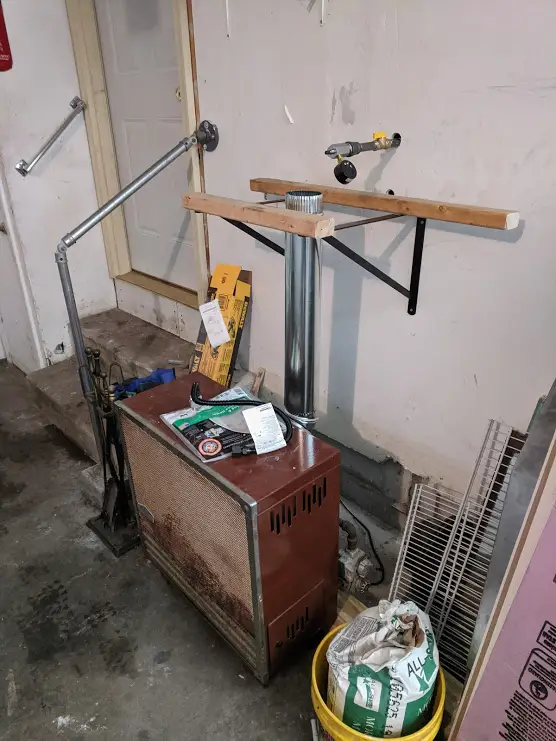

Got the shelf built for the heater, new hole drilled through the wall for the gas line and all the fittings gooped and its pressure testing now. If it holds like it should I will get the tap into the main line done in the basement, check for any smelly leaks and do a soapy water check, attach the heater to the shelf and tighten up the last few fittings and we should be in business!

Since heat rises, wouldnt it be better to mount the heater lower like a radiator?

Yeah it crossed my mind. I have this set close to where the previous owner had their heater, and there is a ceiling fan mount in the center of the garage so I'm guessing they either wanted air circulation or it did heat "soak" the ceiling.
With only having a 2 stall garage I wanted it off the floor to gain some storage space on the floor. If the ceiling gets too hot, I'll just throw a fan in and get some circulation going. I have a spare used fan I swapped out of the house so it won't cost me anything to put one in. Might help in the summer too.
I installed two used ceiling fans in my shop. It is also insulated for the North Pole. In the summer it never gets above 70 inside if I keep it closed up even if it's 90+ outside. The ceiling fans on high are like poor man's AC. In the winter the place never gets below 40 even if it's below zero outside. I keep the fans spinning on low to push the heat back down from the ceiling.

Most building codes require heaters to be high mounted as a safety measure. And the fans do do a good job of pushing the air around. With my floor being concrete, the cold from the ground keeps things nice and comfortable until almost the end of the day. May have to give some thought to ducting to bring the heat down to floor level and let it rise naturally.

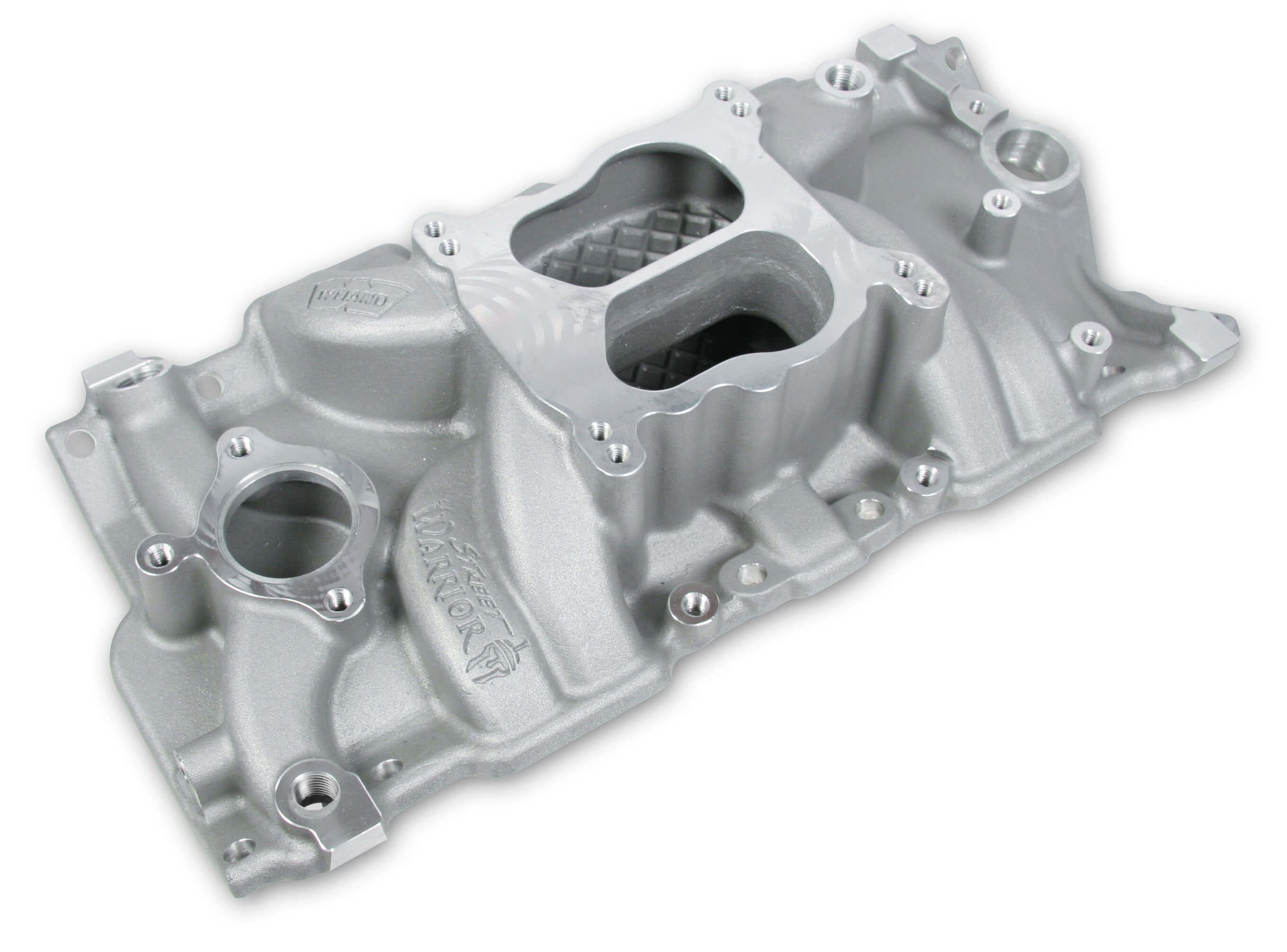

Not really my project, but my brother is infatuated with 3rd gen F bodies (I personally ****in hate them) and aside from being yet another rigged up trailer-trash mullet mobile, it's ok body wise. It had a TPI setup, the dumbass that owned it before swapped it to carb and, well, it's bad. wires cut and left bare everywhere, kinked fuel line ran from the driver's side over the front of the motor rubbing on pulleys, sending unit just sitting in/on the tank, lock ring missing, tank all mangled from him prying it out, standard f body hole cut in the floor for said sending unit, pre 86 intake on an '89 sbc which he said was a 350, pretty sure it's a 305, edelbrock that looks to have been used exclusively as a cover for painting engines with a chunk of the choke surround missing, standard f body bent/shifted rear end from hitting curbs, etc. The main reason for the new intake, the guy ruined that intake manifold. It was a pretty nice edelbrock EPS that has the center 4 holes (2 on each side) completely demolished and misshapen (you can actually see into the lifter valley through them) from ramming grade 5 walmart bolts (and allen bolts) down that were too long, broken and loose intake bolts, intake gaskets clearly very old and falling apart after multiple uses, half a pint of silicone holding them together, worst spark plugs I've ever seen, the ugliest hood I've ever seen with a random off center hole cut for a massive 4" scoop, I could go on.
Where was I? Ah. I felt bad he got screwed so I got him the right intake. The right one, Weiand 8126. For '86/87+ iron non vortec heads.
I'm no master mechanic, I do what I can with what I have, but there is literally no excuse for anything done to this car.
Some people just need to stay away from cars. Forever.
