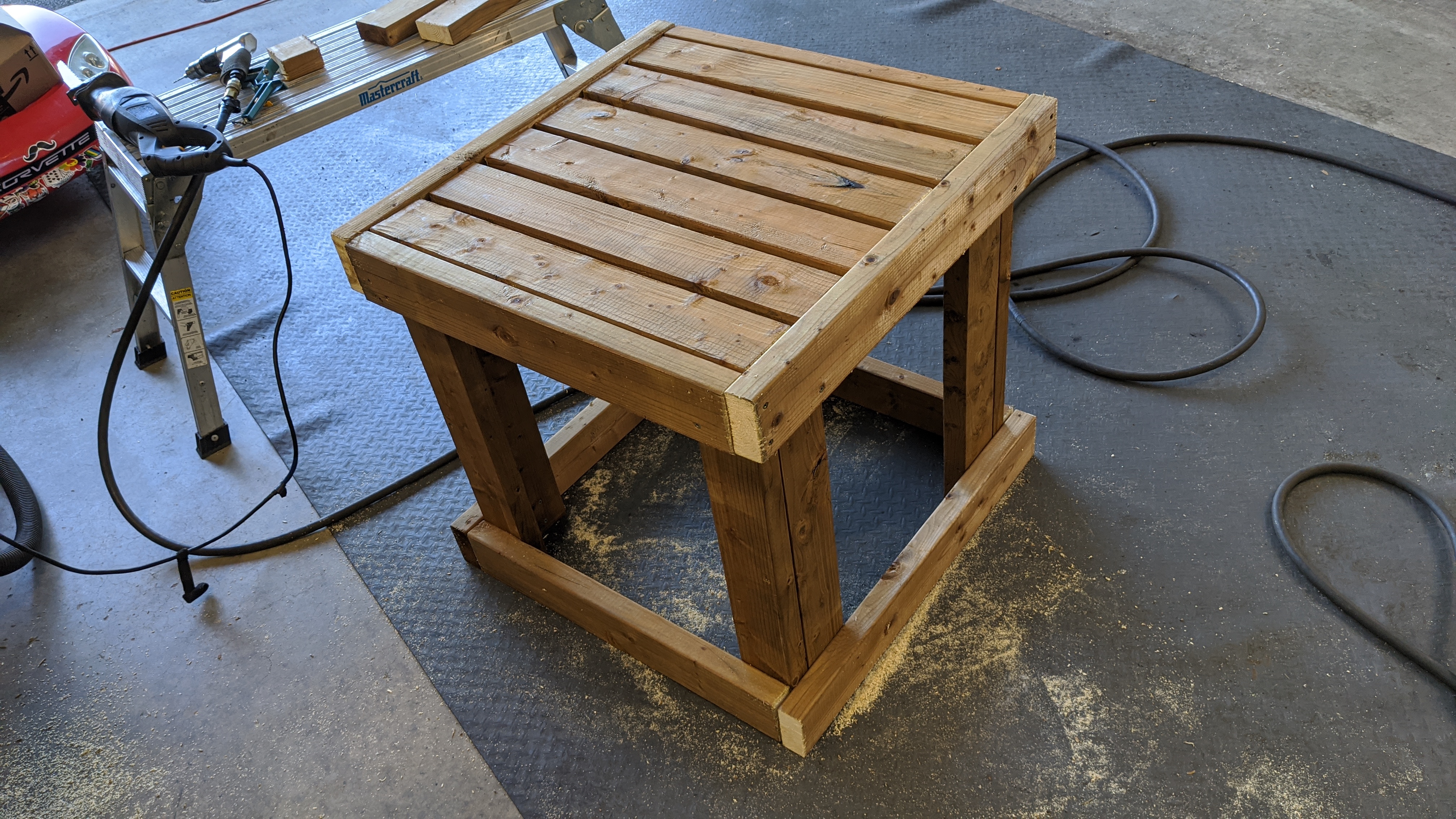

So at some time during the quarantine I opened my big mouth and suggested the Mrs. get a rain barrel for her new adventures in gardening. Well that sumb*tch showed up last week... and well unless we put a pump on it there is no way the water is going to magically rise from the ground into the garden.
So in the face of a pressure treated lumber shortage (because every MFer is building a COVID deck right now) we managed to get our mitts on some 2x4s. And I built a stand for the water buffalo.
View attachment 152544View attachment 152545
I am not a carpenter by any means, but not bad for a sawzall with a wrecking blade and the wife's 18V Borscht.
I can live inside it the next time I piss her off.

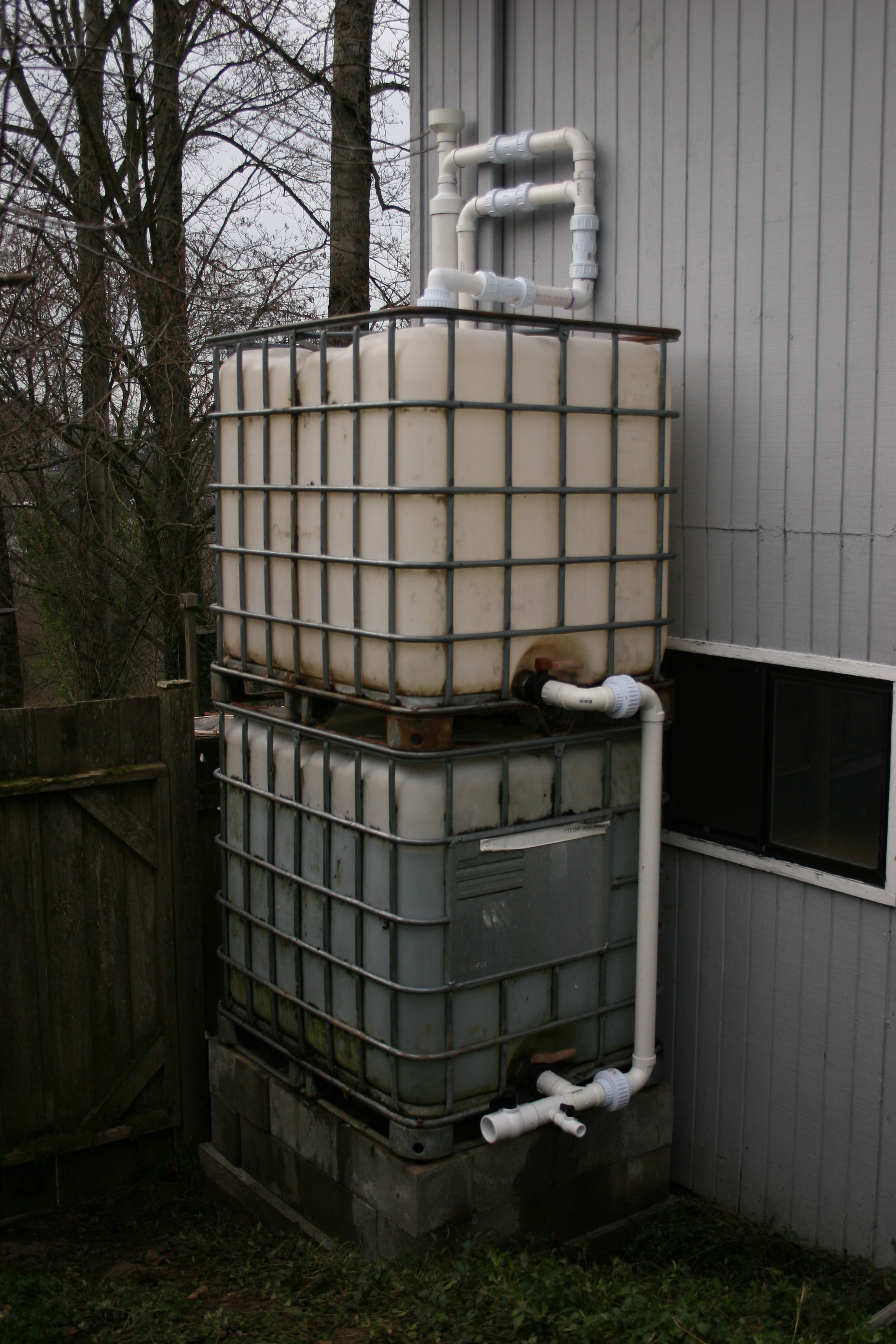

Your rain barrel stand looks good and sturdy. It should handle a 450 pound barrel of water easily. Before you set it in place, pour a small concrete pad to support it, and to avoid sinking into the ground and tipping. If you are going to use a 55 gallon barrel, you will soon find that the water doesn't last very long. I have four 275 gallon cubes that run dry if I am actively gardening. This is a double stacked set-up that I created. My other two cubes are single set-ups.
The down spout was redirected to the 6 to 2 inch reducer, which expands again to 6 inches. the lower 6 inch is where the first flush of dirty roof water goes. I have an empty Gaterade bottle inside that rises to the 2 inch neck to keep the dirty water from the cleaner water, which flows across and down into the cubes. the lower cube has a vent hose that connects to the overflow pipe just above the upper cube inlet. If we get a deluge that fills faster than the vent escapes, there is a 2 inch overflow routed into the original down spout drain. Not shown is the hose bib outlet glued in place later, and the clean-out for the 6 inch pipe on the other side of the stack.
Your rain barrel stand looks good and sturdy. It should handle a 450 pound barrel of water easily. Before you set it in place, pour a small concrete pad to support it, and to avoid sinking into the ground and tipping. If you are going to use a 55 gallon barrel, you will soon find that the water doesn't last very long. I have four 275 gallon cubes that run dry if I am actively gardening. This is a double stacked set-up that I created. My other two cubes are single set-ups.View attachment 152598
That's quite the set-up!
I've been collecting rain water since about 1994 or '95. I started with a couple of 55 gallon barrels, and found that they were not enough. I acquired three 275 gallon cubes that I connected side by side for my first large installation. They worked well for several years until we had a hard freeze that broke one of the small hose bib pipes. I built this double stacked set-up when I was laid-off late 2013-early 2014, thinking that I might try to start my own business setting up systems like this, but before I got most of my business licenses and permits, I got called back to my regular job.
