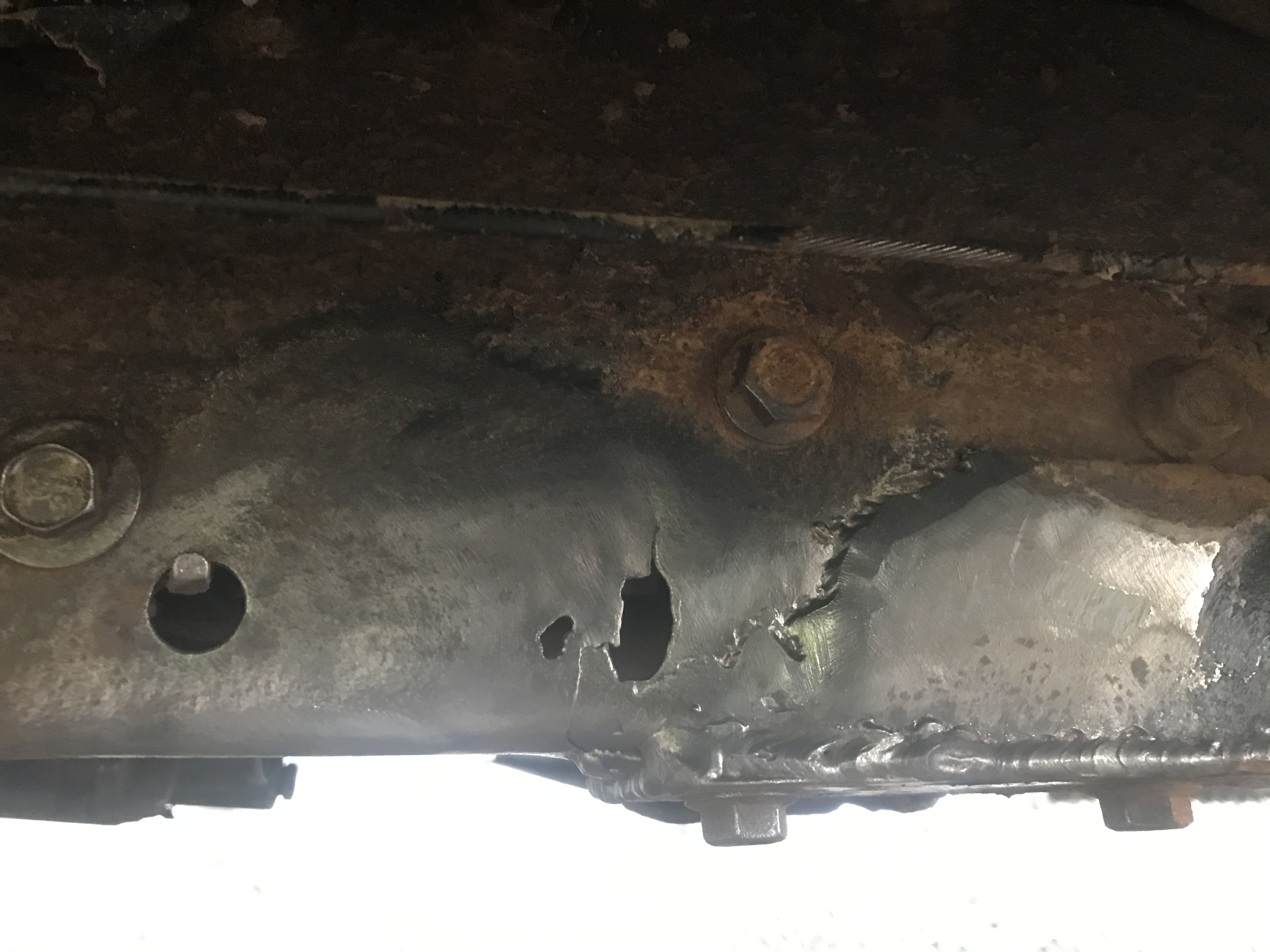

Welded more stuff. I didn’t have the time, nor materials to do this the way I wanted, but it should work for now. Another crack had formed right in front of the torsion bar crossmember, thankfully it was only partial, but this is due to rust. I have had it repaired in the past:
I tried to weld some of the crack back together, and was just shotgunning the frame apart. Made a few pieces out of some 1 inch wide stock since I only had that and the 4 inch piece I used yesterday.

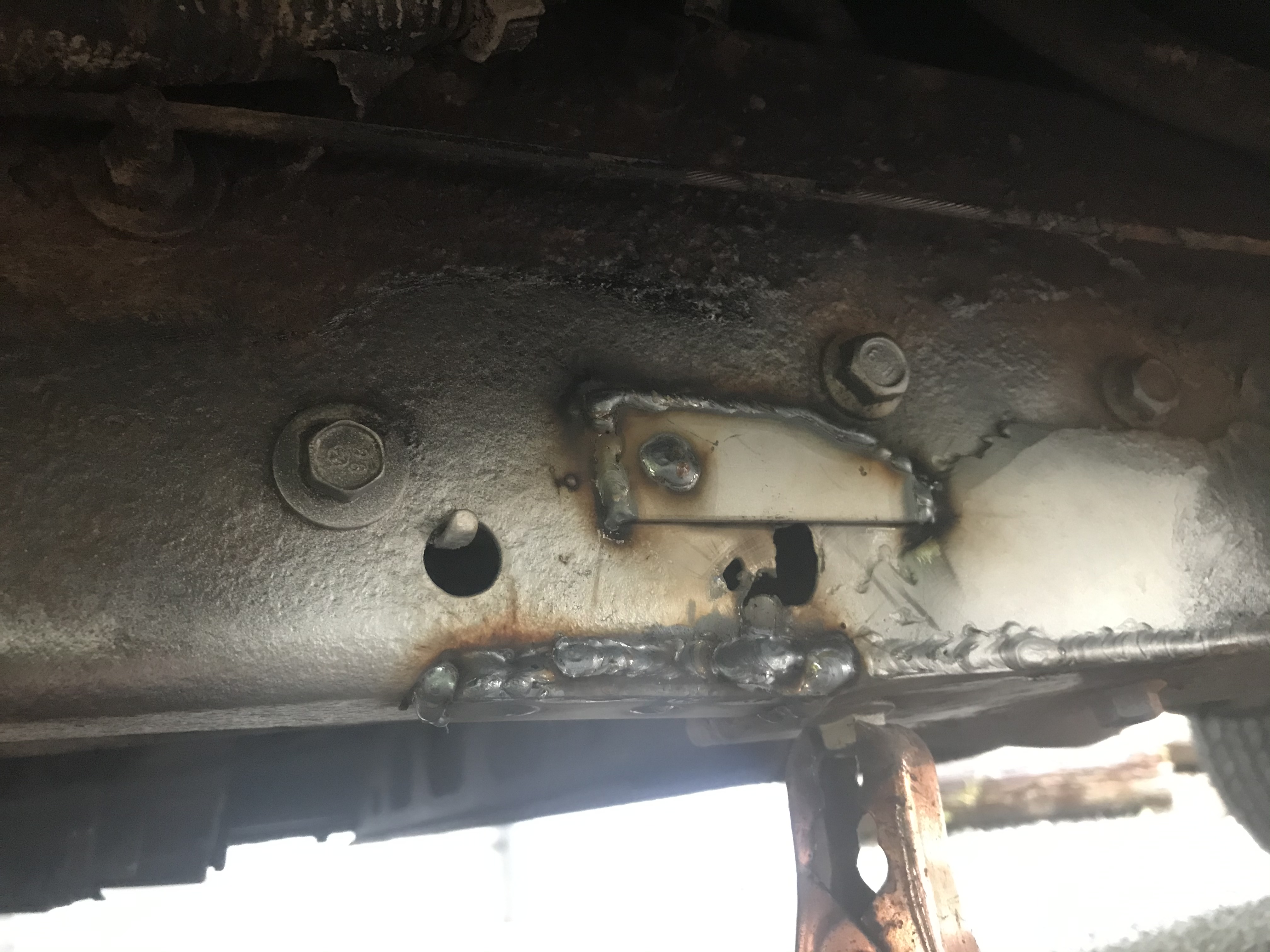

First two pieces welded in:

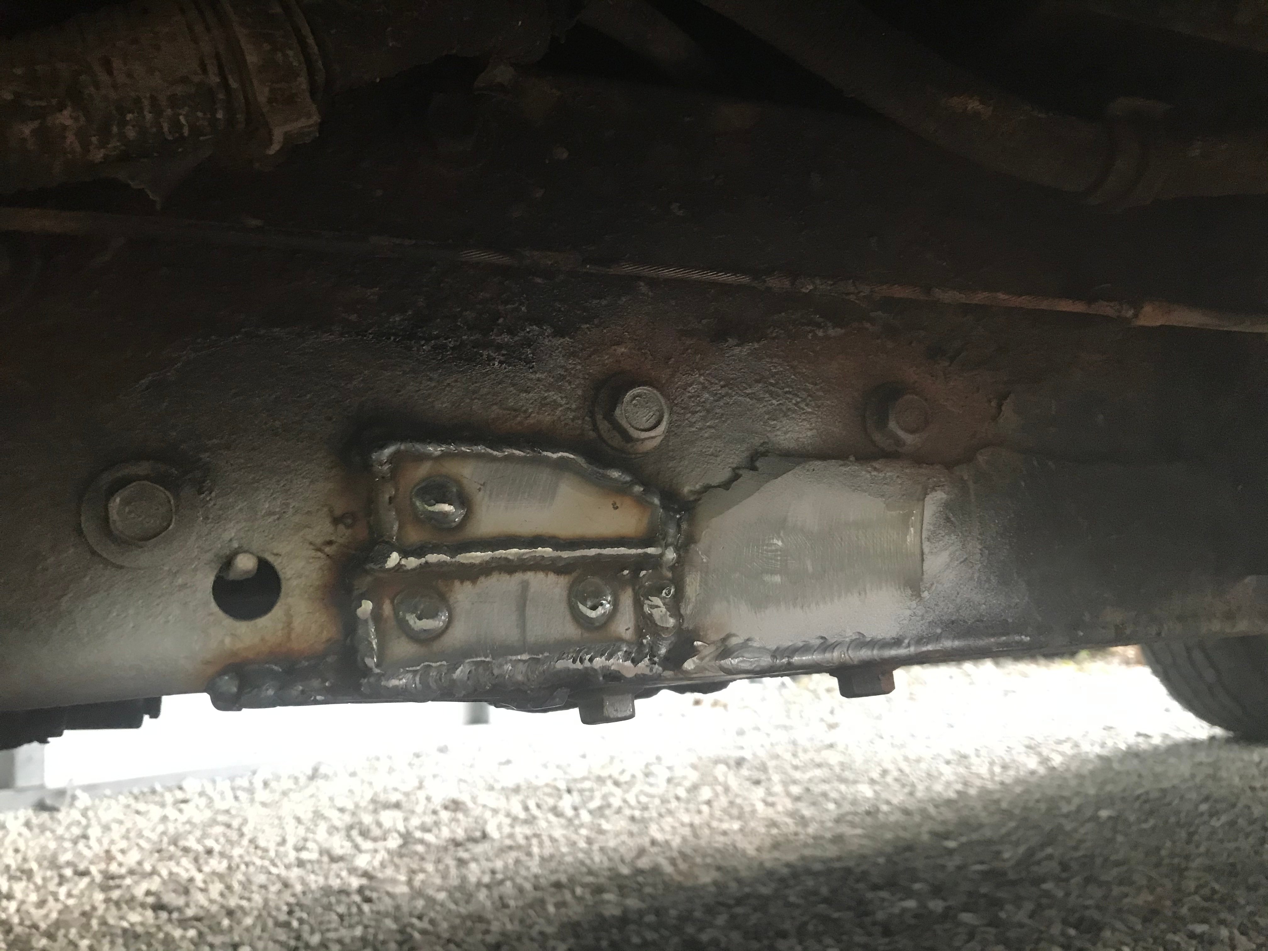

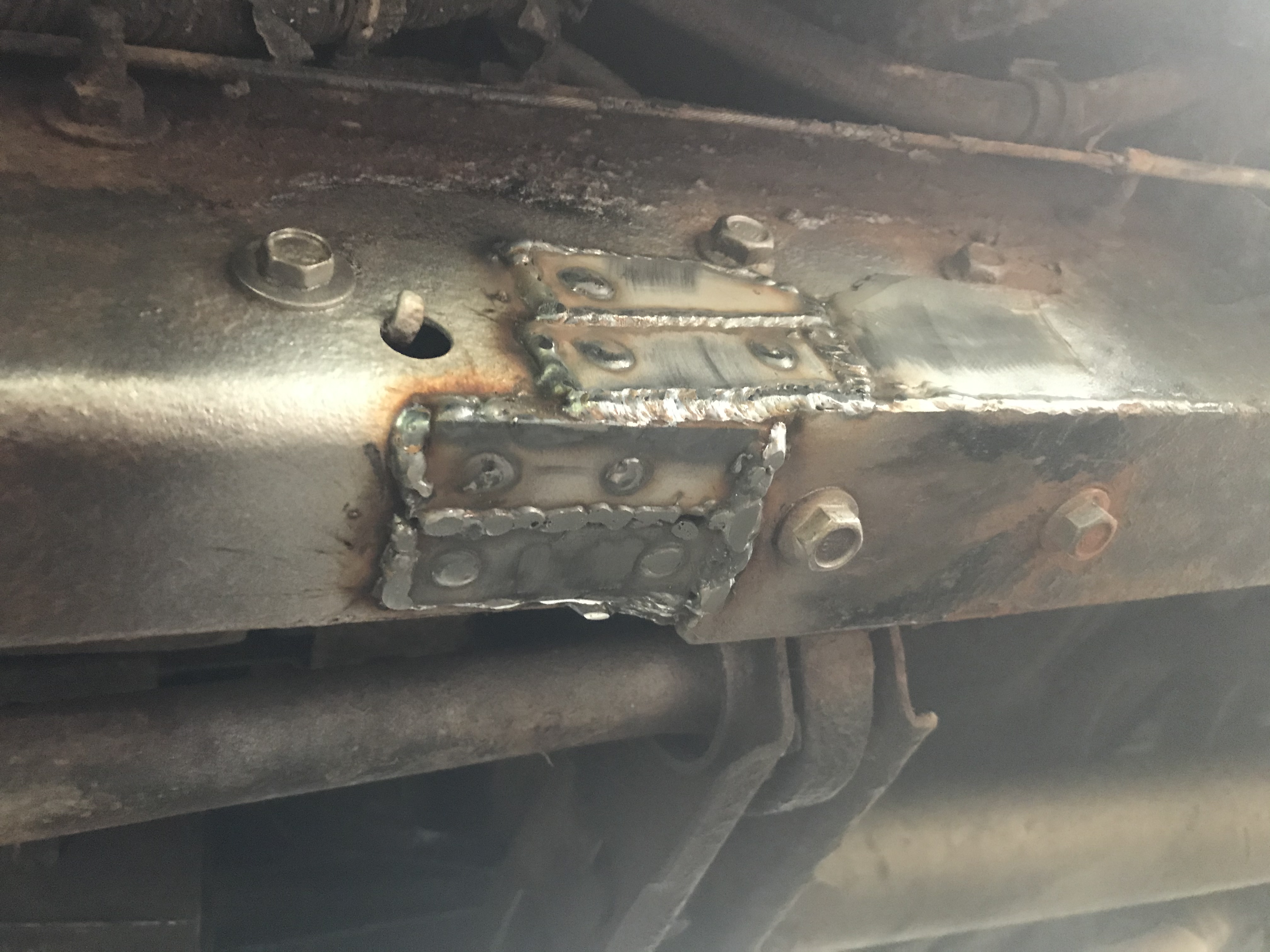

And the last two welded in:

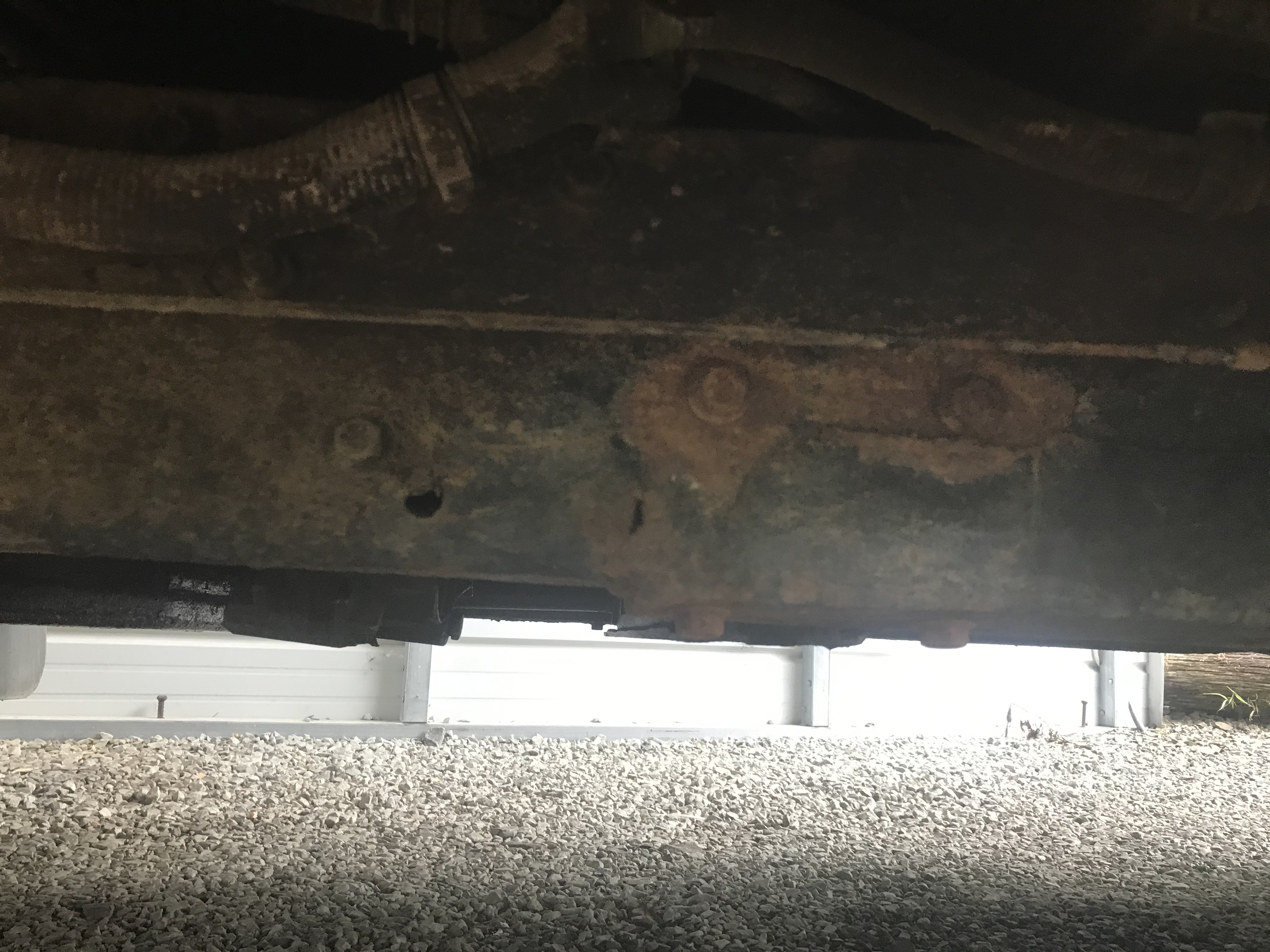

Don’t have any pictures, but this got the same treatment as the passenger side, VHT and Fluid Film snot. Took a bit of time to spray inside the frame and the cab mount brackets.
