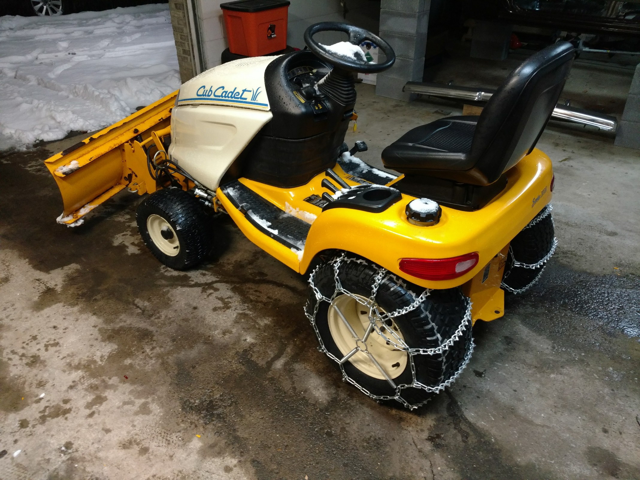

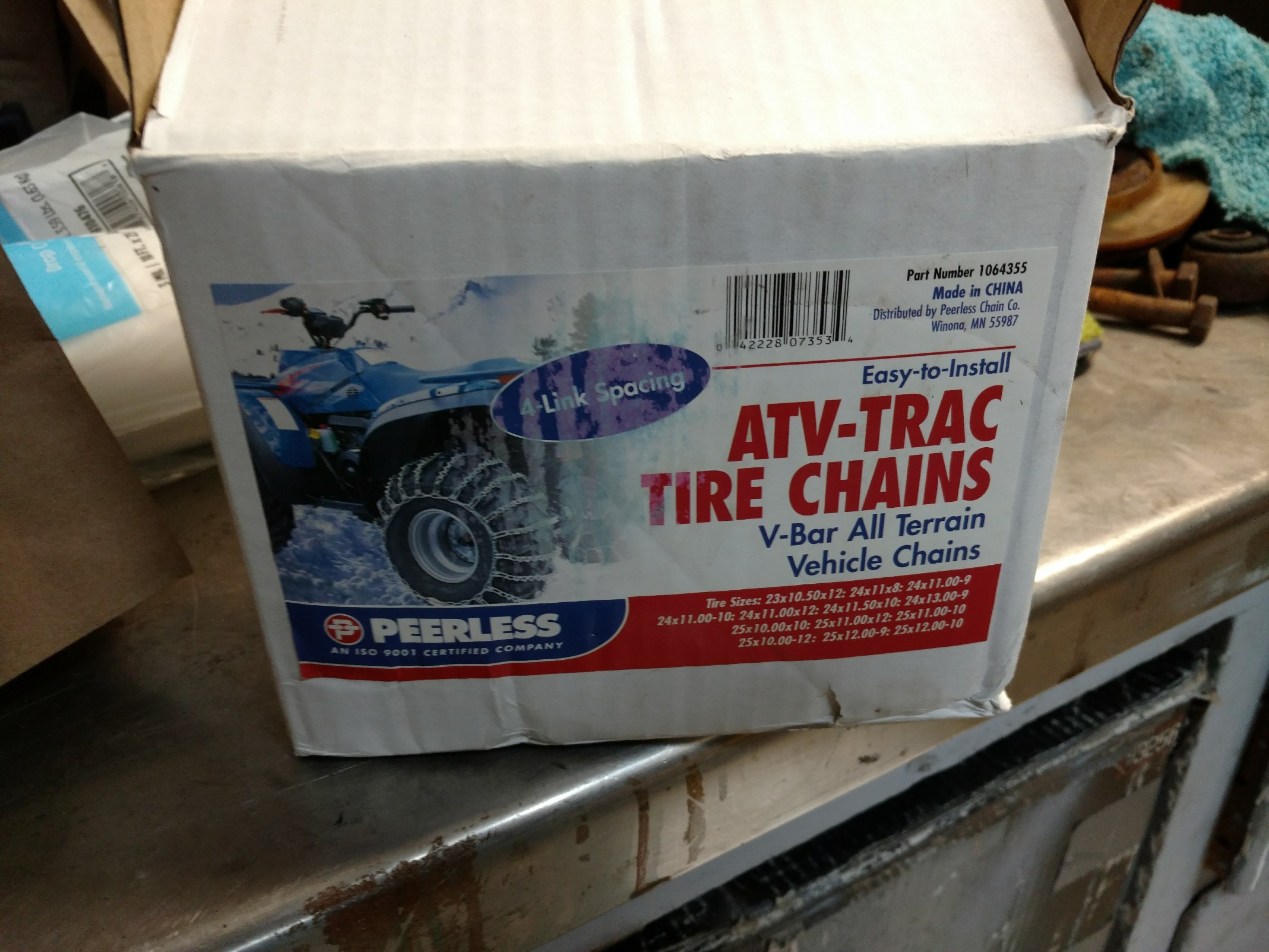

Got my *ss whooped by the snow. Tried to plow without chains, that was a disaster. Ran out and bought a set of chains then got the tractor hopelessly stuck in the yard trying to get it to the garage so I could chain up. Eventually I got it out and got it in the garage, got chains on it and was actually able to move instead of spinning tire.

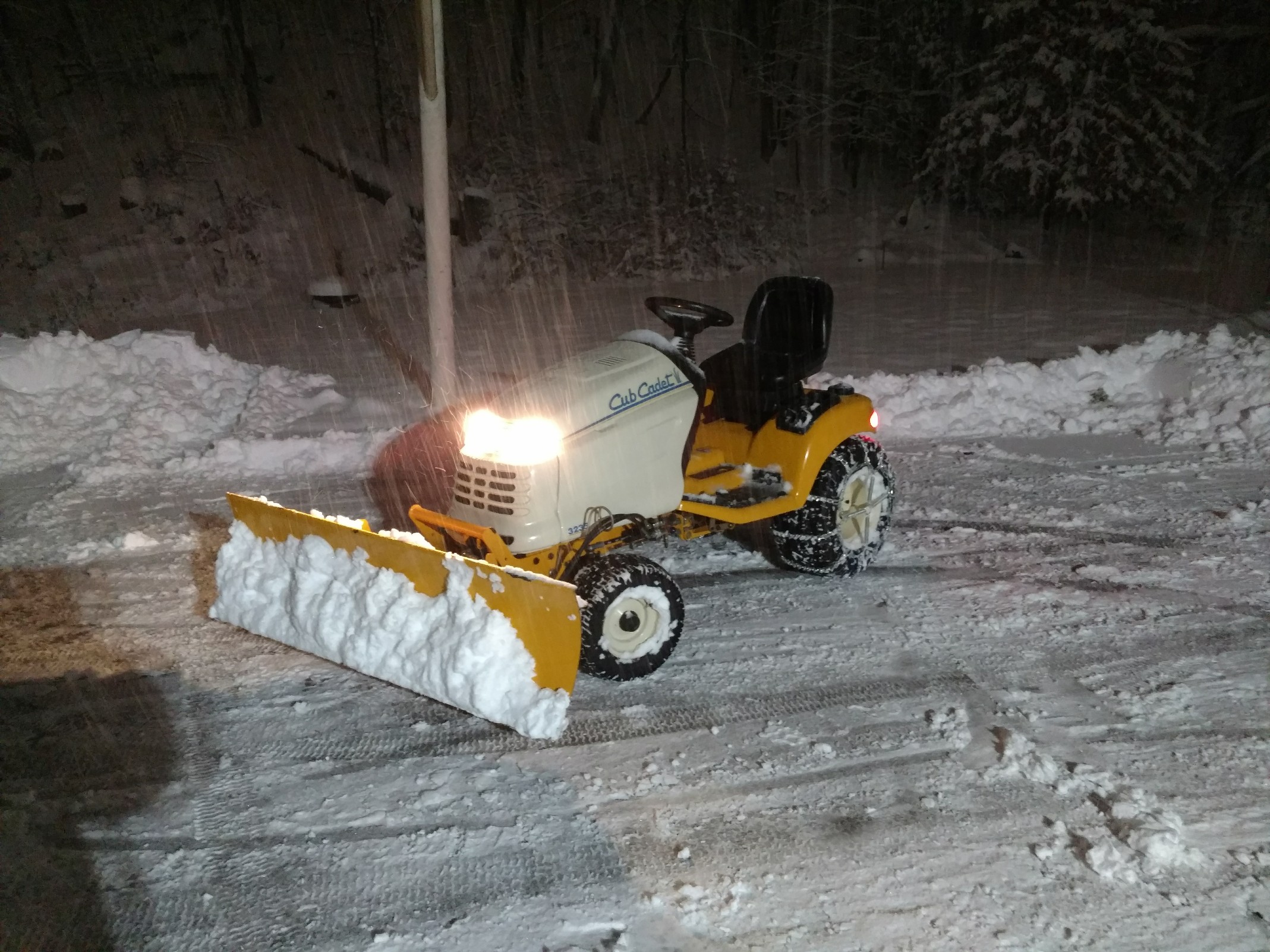

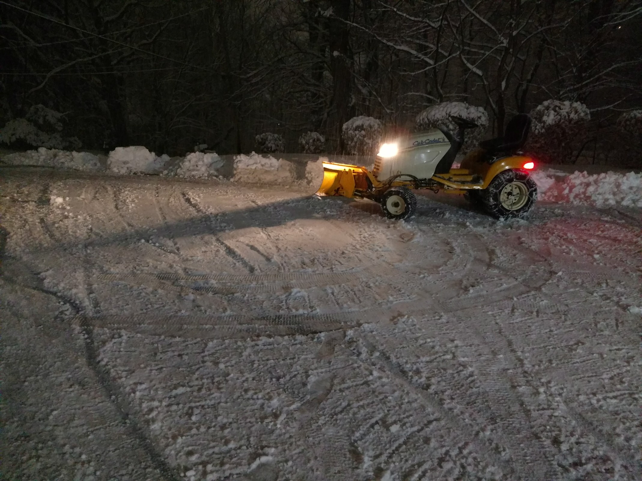

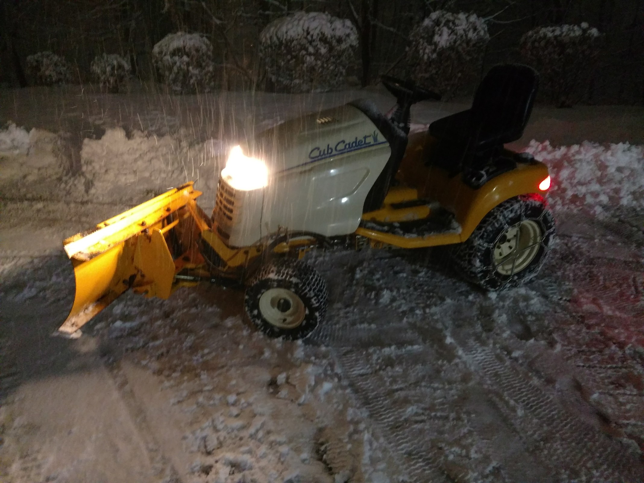

Plowed my driveway and the neighbors. There is easily 8-10" on the ground right now.

Next you need to get the wheel weights, they make a difference.
I'm at work, can't wait to see how much I have at home tonight.
Be very careful about wheel weights. If it has the tuff torque or hydrogear transmission, they REALLY don't like the extra rotating mass on the axle shafts. You'll end up snapping an axle, then junking the tractor. It might be better to make a hitch of sorts and hang the weight off the back instead.
