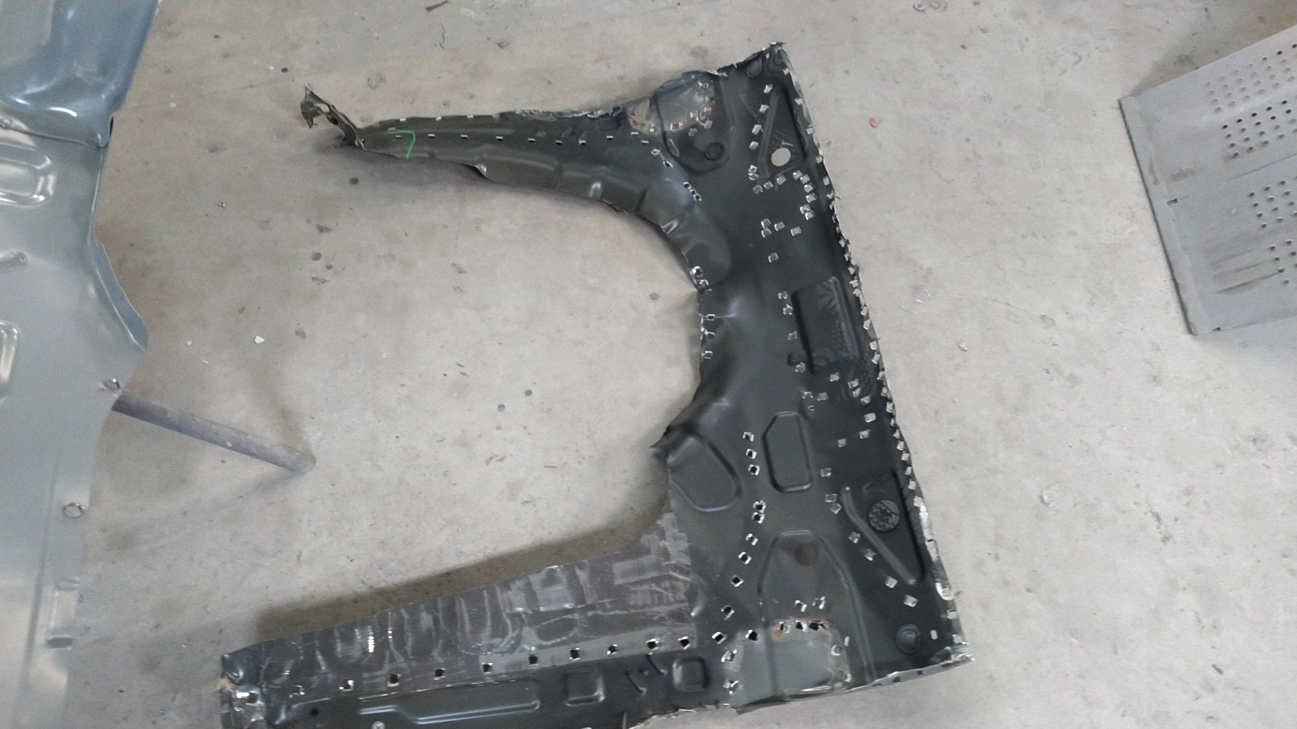

Just another day I did thisView attachment 138470
And no I didn't take it apart someone else did so I had to figure it out
That's what it looked like when I figured out I had no clock spring so I moved on to a Hyundai, pulled it and cut it up
View attachment 138473View attachment 138474

What type of bit are you using to drill out the spot welds? I never have any luck with the mini-hole saw type cutters.
When I'm cutting a panel for removal I use my belt sander when I need to drill out a spot-welded for a plug weld or rosette weld I use a. Spot weld bit that looks like a bullet bit or pilot point bit both of which are available at Lowe's or Depot but the ones I use are from an auto body supply they're shorter for getting in tighter spaces.
