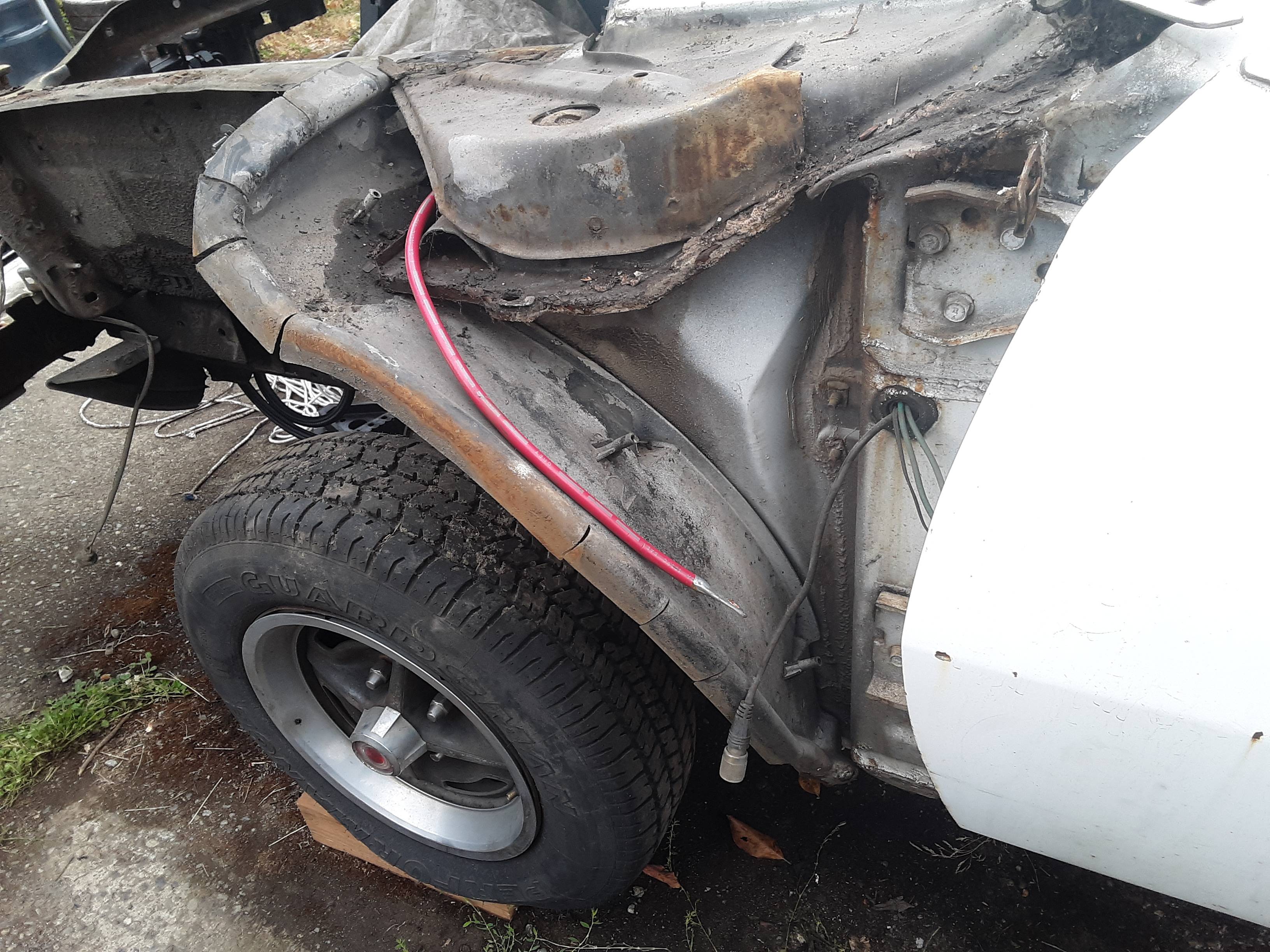

Yesterday, along with some time working on the Caballero, I was able to do some parts shopping, and scouting for a location to mount a battery cut-off switch on my Pinto. To get access, I pulled the driver side front fender. Years ago, I had drilled a hole and mounted a CB antenna. At the time, I was too young to realize that I should have reinforced the metal in the area of the antenna, so the vibration caused metal fatigue and damage, then add an additional 25 years of rusting away. My plan now, is to grind the rust away, weld on a reinforcing layer, re-drill for the antenna, and also mount the cutoff switch beside the antenna. It probably sounds like a goofy idea to mount the cutoff switch through the fender, but I don't want to drill the dash, or have to pop the hood open every time I want to use the car (which probably won't be often anyway).View attachment 183695
I am thinking that I will move the antenna back toward the windshield about 1-1/2 inches, then add the cutoff switch about 1-1/2 inches forward of the current antenna location. The new battery cables are in place. View attachment 183696
The top of a Pinto's fender, for those who haven't seen a Pinto since forever, has almost the same curvature as the Earth's surface. An exaggeration of course, but so near to being flat that I should have no problem fitting a piece of metal to reinforce the location for the switch and the antenna holes.
Might want to check a marine supply shop to see if they have water proof versions of that switch. Out on the fender like that is kind of exposed to the elements, unless this Pinto is only going to be a sunny day tripper.
Good idea, and being in the Seattle metro area, there are no shortage of marine supply stores here.
It also occurred to me that you could put that switch back on the rear tail light panel ala gasser rules and throw some pin striping around it for overkill. Being back there offers the switch a little more protection than your front fender and having it there will make people wonder just what you have stashed under the hood for a mill. Oh, those mind games.
