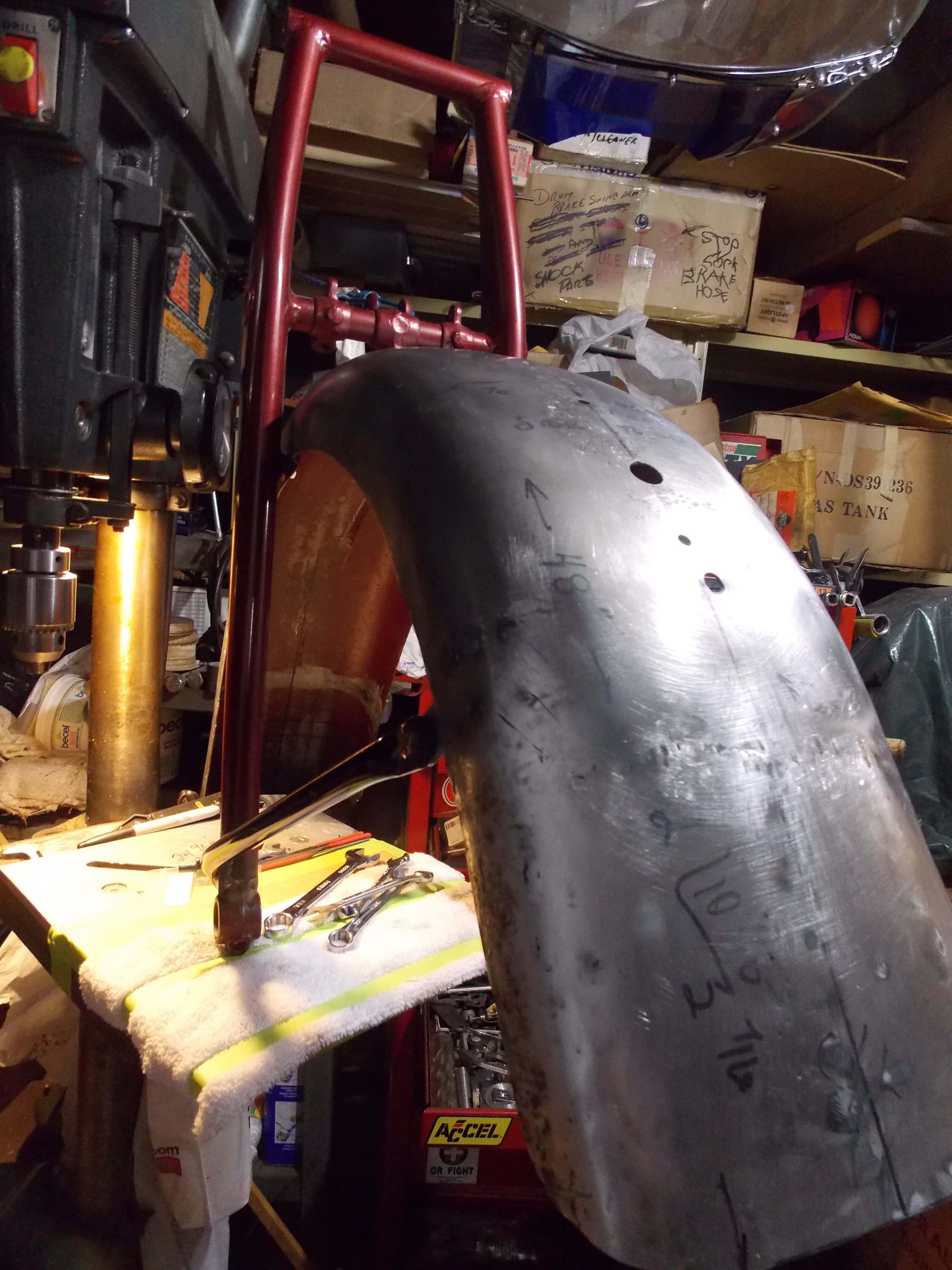

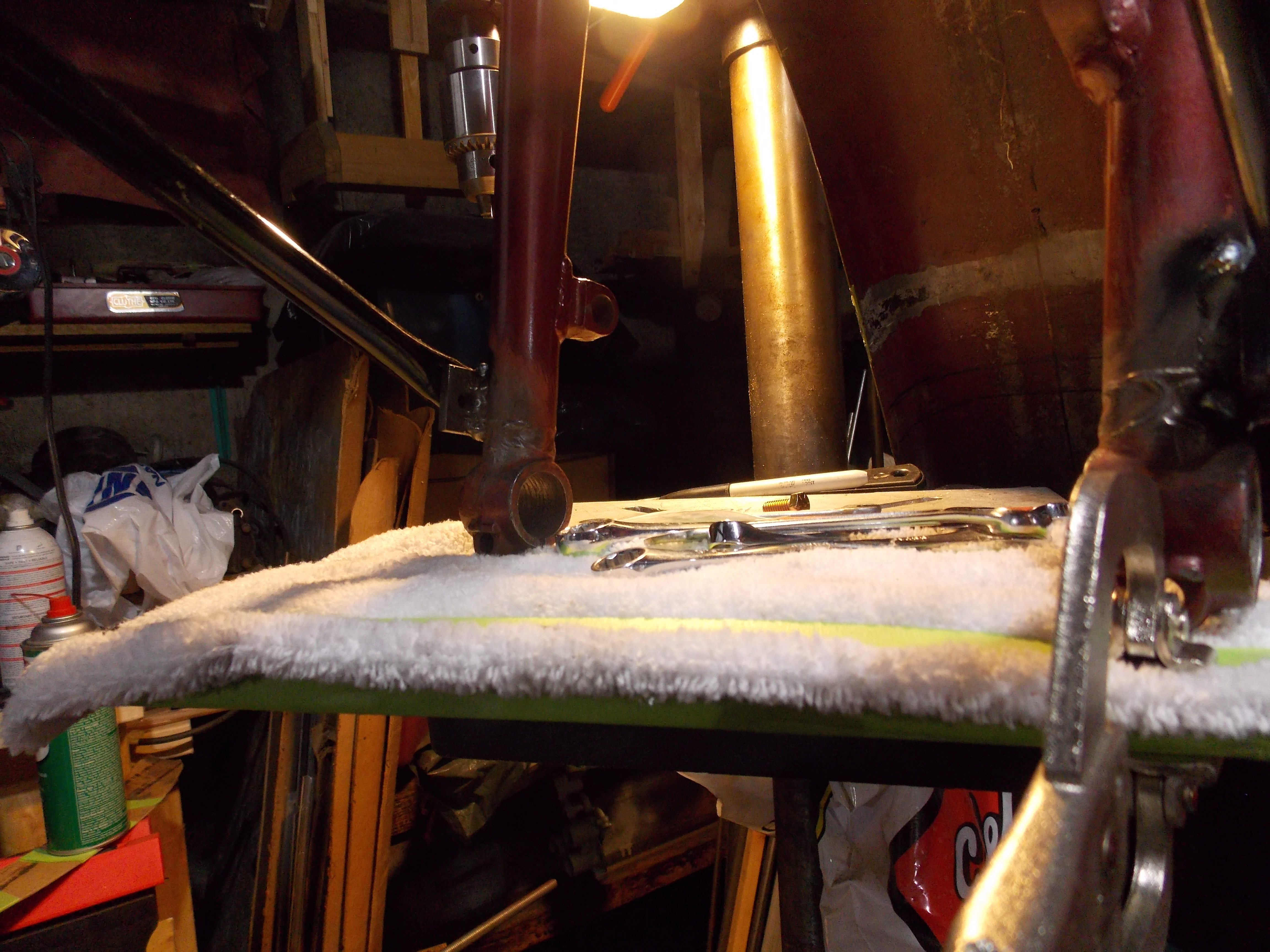

So these are the two new lower front fender mounting tabs, c/w their studs, that I just welded into place on the main legs of my 47 Indian Chief. Some of the welds have already been kissed by my Dremel, the rest await their turn. The ends still have to be radiused; changed from straight ends to curved ones. When checking for straightness and position, flat edges are easier to work with for the tape measure.

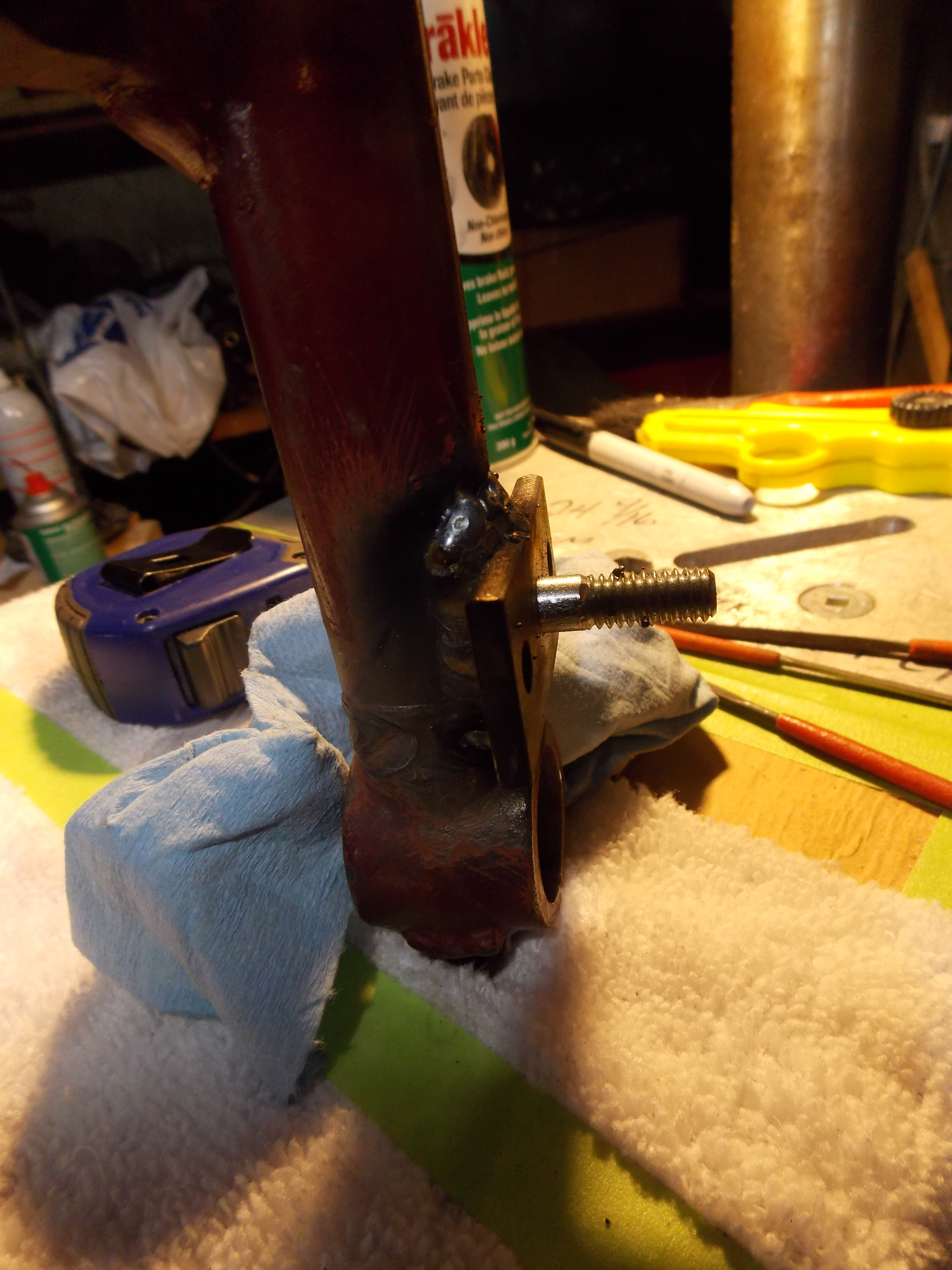

Just a detail shot of how the fender brace lands and interacts with the new mounting bracket. Like I noted above, it still needs to get its finished shape but this gives a better idea of what needs to be fed to either the 4.5 or the Dremel. Right now the Dremel is the crowd favorite because it can get into tighter places than my DeWalt. The only drawback to my Dremel is that they seem to come with a built in suicide protocol that encourages them to drop dead from time to time. They are supposedly rebuildable but the cost for parts just about adds up to a new one; and I am no watch maker; that was my Dad.

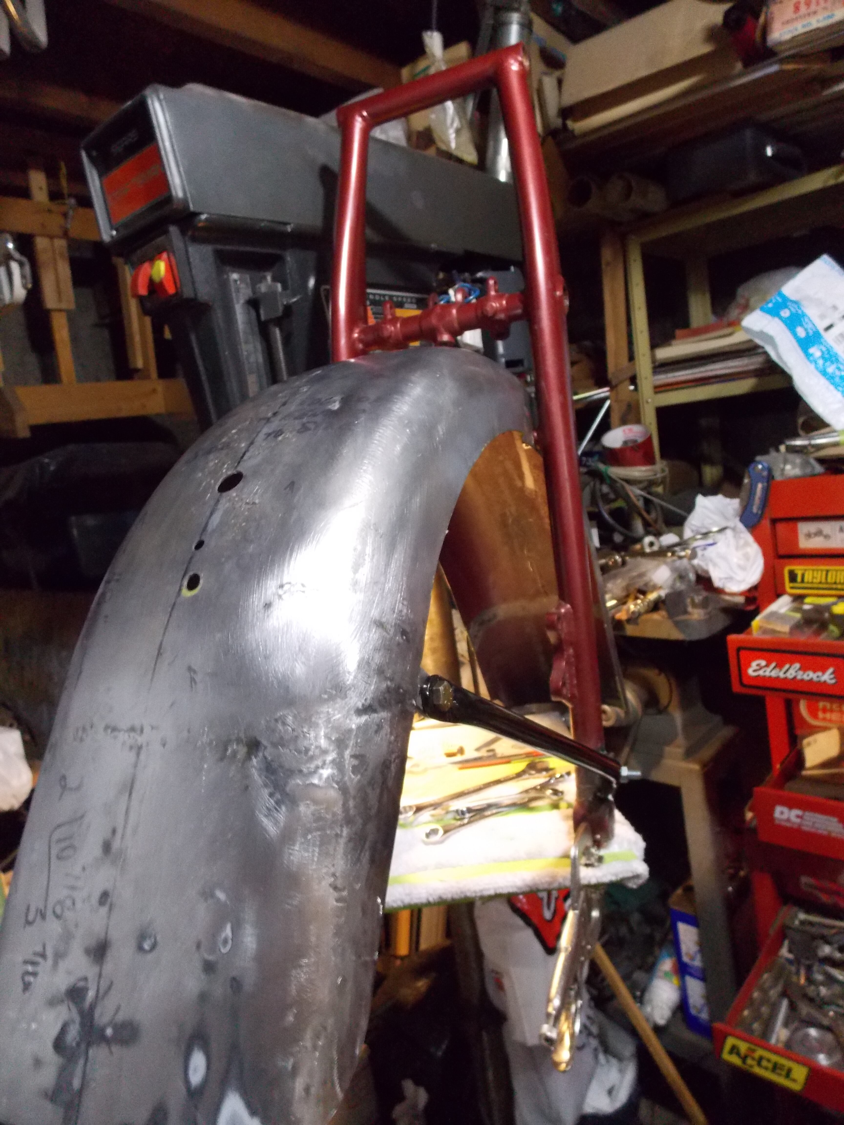

And finally a pair of profile shots of how the fender and the front legs interact, as seen from the front of the bike. For those who have been keeping track (WHAT?? Aintcha got nuttin' better to do?) This is the fender that I have been practicing my body and fender beating skills on. Do be aware that this is old metal geting more old metal attached to it. The 47 metal was actually in better shape than the graft that I added to it. The big catch from the get-go was that the old metal was thicker by .010 than the thickest piece that I could lay immediate hands on. To obtain new .060 sheet metal I would have had to have purchased a complete sheet, assuming availability and paid in blood for it. What I have here will work and by the time I do an epoxy sealer coat,then a skim coat of filler and get it all sanded down and shaped to what I want, it will look like it should and all the sins will be hidden until future eyes get nosey.
