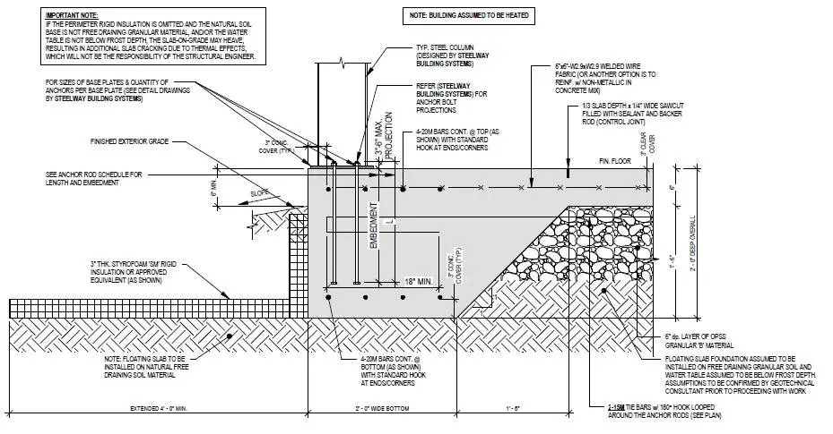

The included drawings are pretty good and give detail of all the connection and all the parts are labelled. Just that some of the bits are quite heavy. I'll probably get the guy with the telehandler to come back to help with putting up the roof structure.
My original intention was that I'd do all the foundation work myself with the exception of the pour and finishing. I've done a bit of concrete work but nothing of this size. Just don't have the confidence to try and do it myself and then have to stare at it forever. But the building vendor gave a pretty good price on doing it for me and then it would be done in under a week. Problem is, they went from telling me they'd only need 2-3 days notice, to 2-3 weeks and now, I gave them the go ahead 3 weeks ago, and they still don't even have a start date for me. I get a feeling that with the trades being so busy around here and the fact that they're sub-contracting the work, they're just not going to make that much money off it and have lost interest. But if that's the case, just tell me. But every time I call the Project Manager he just tells me he needs a couple more days.
For the floor/foundation, around here, anything over 600 sq ft needs to be stamped by an engineer. The floor/foundation is a monolithic slab, 6 inches thick and thickened to 24" around the perimeter. Plus there's concrete 'beams' (the floor is thickened to 10") each 10 ft, running the length of the building. It's 3600 psi concrete with fibre mesh and there's rebar and wire mesh. Those concrete 'beams' have rebar in them as which needs to wrap around the anchor rods. And those have to be 24" rods cast in place with a minimum of 18" embedment. The building manufacturer did sent some Red head anchors, but I can't use them - at least not according to the engineer. Final is the frost protection, 3" rigid insulation veritcally around the perimeter of the slab, and then extended horizontally a minimum of 4' around. And since I'm doing in floor radiant heating, I am insulating the entire underside of the slab.
The only real issue I've had with the building department so far was them wanting a 'drainage plan'. I'm within the city limits and it makes sense in the urban area to make sure that there a plan to make sure that you're not going to end up flooding an adjacent property of something like that. But I'm in the rural part of the city and zoned Agricultural and there's nothing around me but corn fields and woodland. I ended up having to pay $1500 for a civil engineer to come and do plan which in the end basically just said, "make sure to slope the grade away from the building" And it caused a month delay in getting the permit. I've already talked to the inspector assigned to my file just to clarify a few things about at what exact points he needs to come out and inspect etc. and he seems like a pretty reasonable guy. He basically said that since it's a garage and not a residence, they're not too worried about stuff. Typically they would inspect just before the foundation is poured, once the frame is up, a rough in inspection and then a final inspection. But since it's an engineered metal building, he wants to check it out before I pour and then since all the connections etc are exposed on the interior, just a final inspection.

The foundation of your building looks the same as mine. We haven't had the slightest issue with shift in over a decade after pour.
