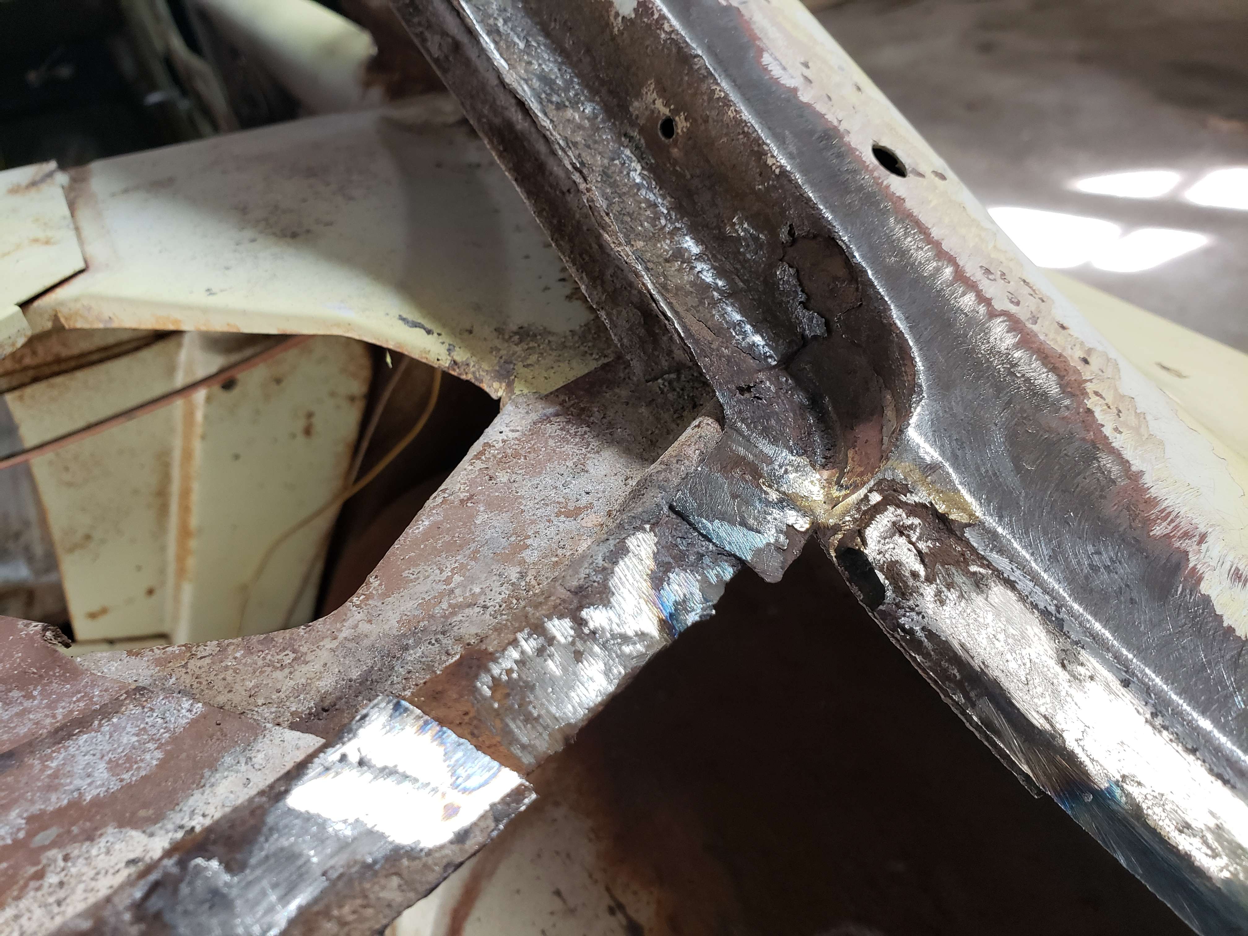

Hard to know when to say when.
I just want to be a little more cognizant of it. I don't want to be revisiting a rust issue down the road but I'm not going to obsess over perfection.
Must of been the same guy who put in that trunk floor we pulled out of that Regal. Spot welds for days.
Not sure how well you can see it, but there is about 12 spot welds in this ~6 inch section.
I'm generally not a huge fan of POR-15 type products, but this seems like an ideal application for it (or their POR Patch product) and I really want to avoid going down a rabbit hole of sheet metal replacement. Of course if I start poking and it gets any worse, I'm gonna have to weld some metal in.
That's probably one of the few areas I'm not as big a fan of their type products.
They only work if you encapsulate the rust entirely. When there's multiple layers of metal spot welded into a sandwich layer, that's just not really possible. You can coat the front. You can maybe coat the back. But you aren't going to coat all sides of each layer.
And in between the layers it can continue to get moisture, and, that allows it to continue to rust, then swell as it corroded, then create yet another water leak, more rust, so on so forth.
Being a garage queen can help some, but... pinch weld seams and glass channels don't seem like the best location. Maybe if it's just sealing/cleaning up surface rust. That's one thing, to make a solid adhesion surface.
Eh... I dunno.

As for pinch welds and multiple layers, about the only thing I've found is to repeatedly soak the seam with Rust Mort or similar until the stuff starts leaking out the other side/end/bottom, and then apply some more. Literally saturate the area. You can even use a siphon gun and air to push the Rust Mort into the seam under pressure. And have a pump bottle of water handy because Rust Mort will etch your concrete if you don't. Ask me how I know...........................................
About that panel, yeah it sure seems😀 like someone got a little OCD with the installation at one point or another, but the lead is old school for sure. Hope you were wearing gloves and a breather mask when you ground it out; the new fillers are pretty much "lead" in name only but back before Cali Prop 65 became a household word, metal filler was almost all lead and the material of choice for the customizers and rodders.
Are the body panels easily sourced for replacements? Early A bodies, especially BOP's don't get nearly the support 68-72 stuff does.
I put a mask on as soon as I realized it was lead. I was aware they used lead on the pillars but didn't know these were leaded. I didn't wear gloves, but I don't make a habit of licking my fingers.

Skylark specific stuff is tough but anything that interchanges with Chevelle is easy to find. Most inner structures, firewall, core support, and roof are all the same as the other A Body siblings.
When working with the dust, the cleanup, or anywhere else that crops up? Just an FYI, lead is a tricky sucker and absorbs through the skin, not just the mouth.
Orally it absorbs faster to be sure, but, skin does absorb it and it's one of those heavy metals that stick around for a while once in.
