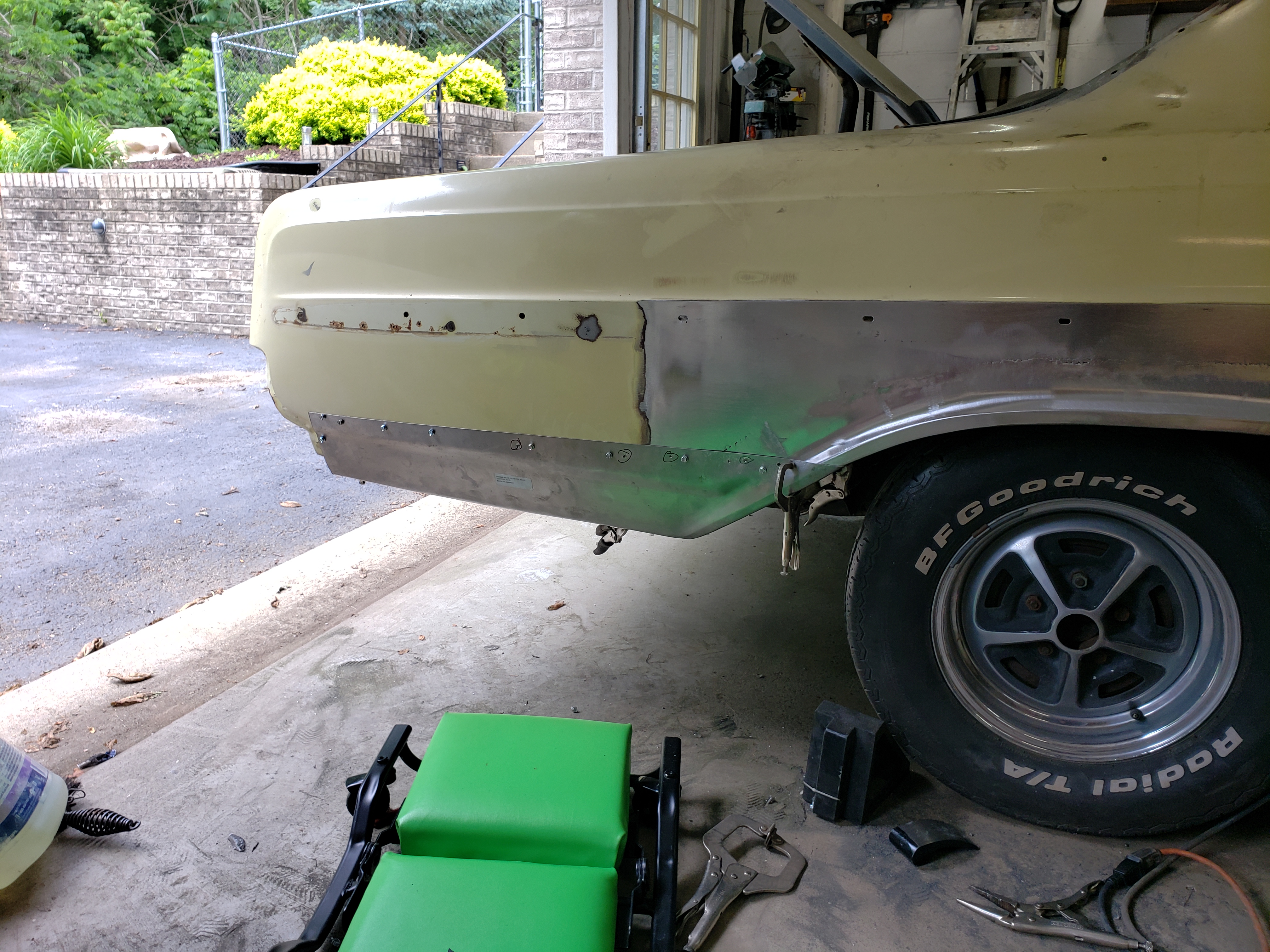

Had a day off with decent weather so I got some stuff done on the car. Finished welding up the wheel arch and grinding the welds down. It's not quite as flat as I'd like it to be, so it'll need some hammer and dolly work and some filler, but it looks good in the picture.

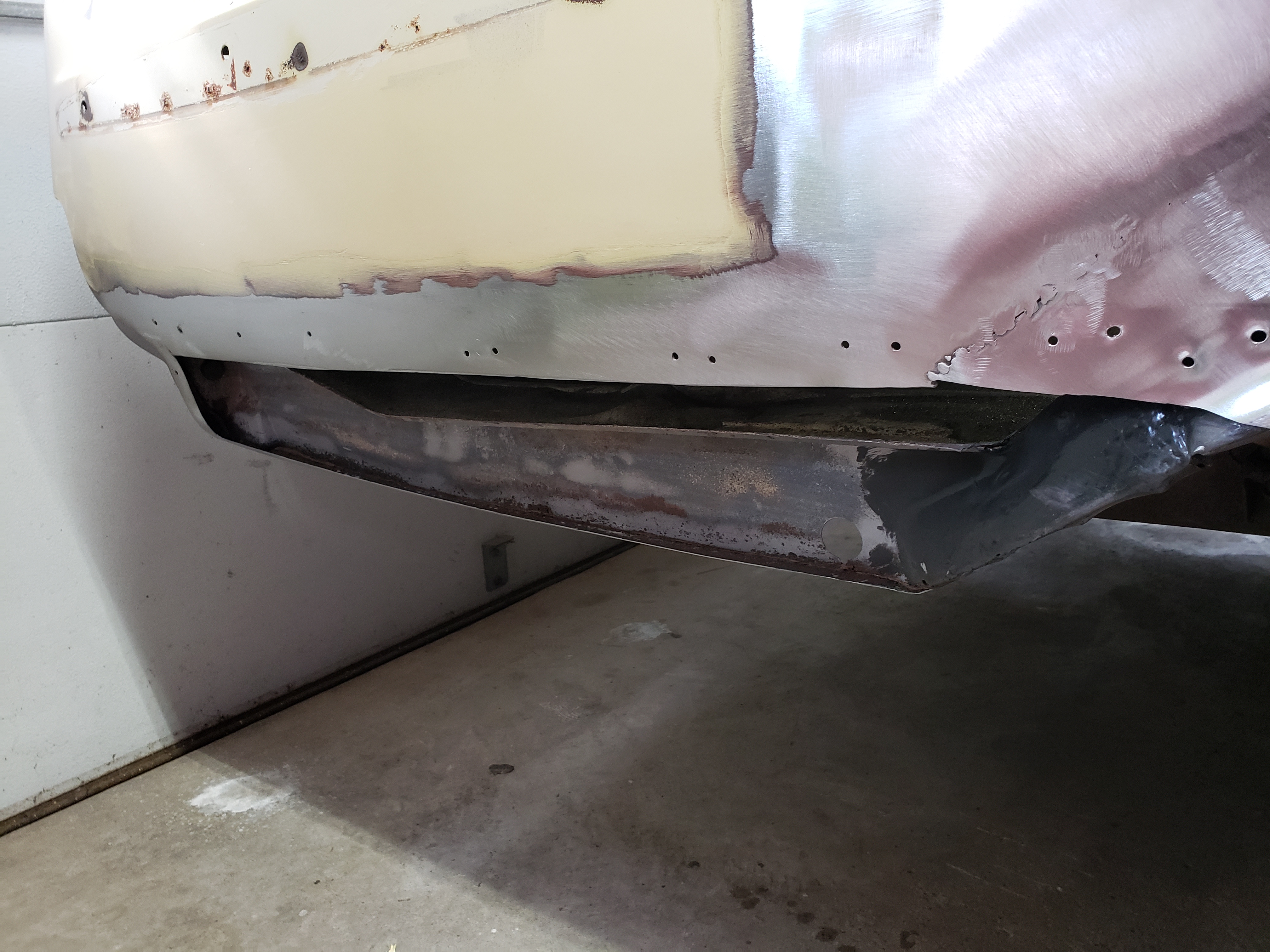

Got the lower quarter patch fit up. I'm going to screw and glue this piece.

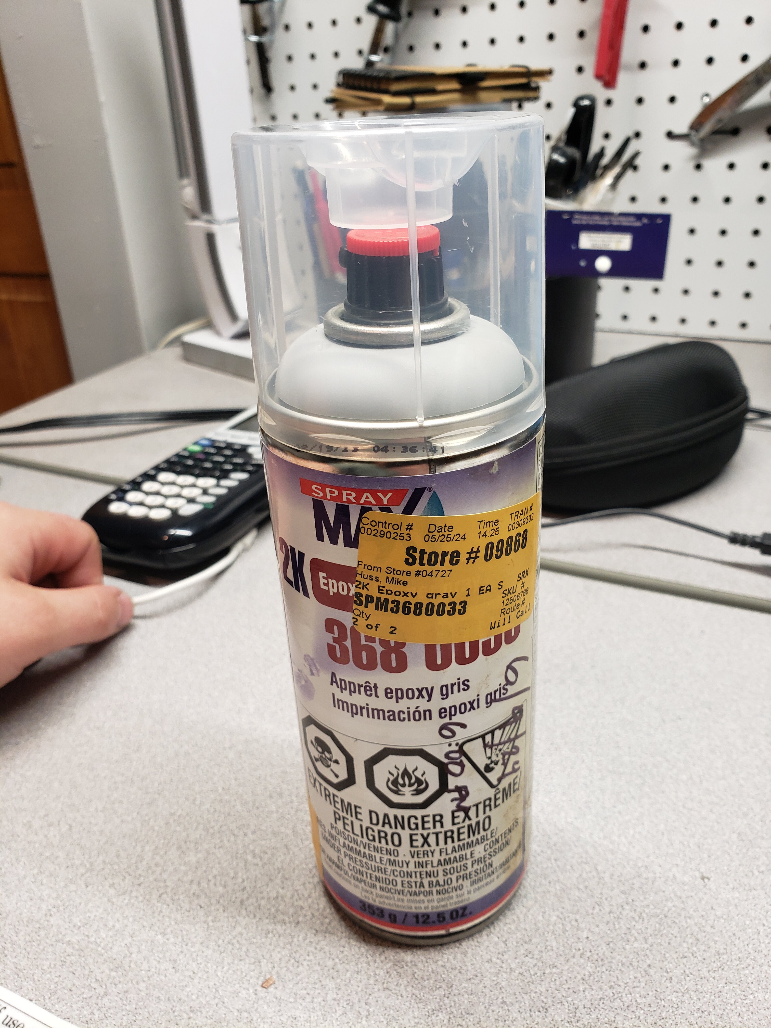

I also blasted and epoxy primed the passenger side window channel. I used this 2K rattle can stuff that I've never used before. Pot life is 48 hours. I figured it would be nice for spots like this so I don't have to get the gun out and clean it and waste product for a small area.

A nice repair.

A nice repair.
Thank you sir. I'm happy enough with it.
