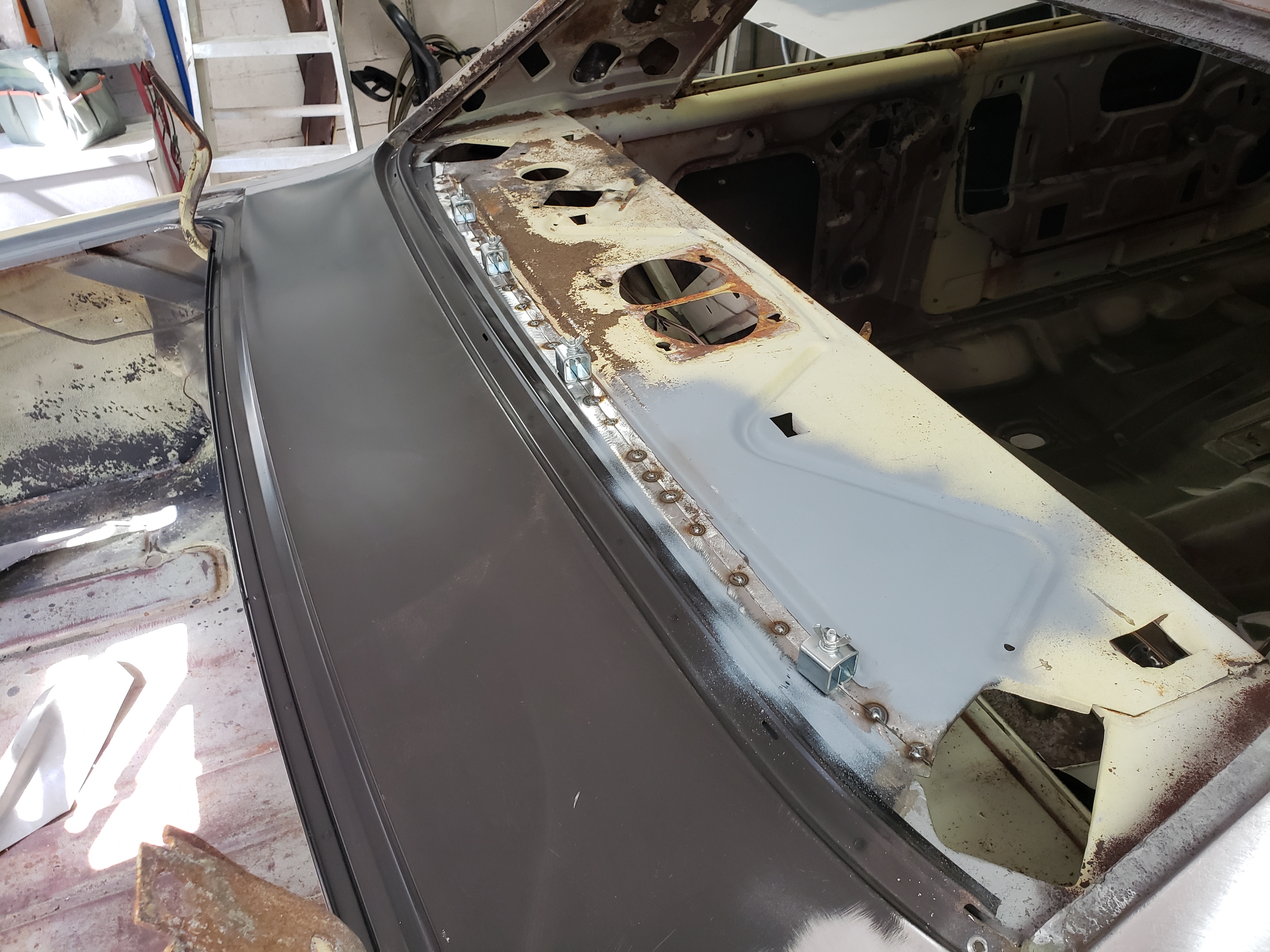

It is insanely hot and humid today but I did get the rear filler panel glued in today. Had my dad help me set it in place to avoid getting glue everywhere. Would've liked to have had a few more clamps but I made it work. It took about a half hour to get in and I was a sweating mess by the time I was done. Time to sit in the A/C and relax for the rest of the holiday.
A bit overdue for an update and unfortunately I don't have a whole lot to report. I do have the rear deck panel pretty much totally welded all the way across, but for the most part, it has been way too hot and humid to be working in garage, especially with autobody. I don't like to sweat all over fresh body work.
