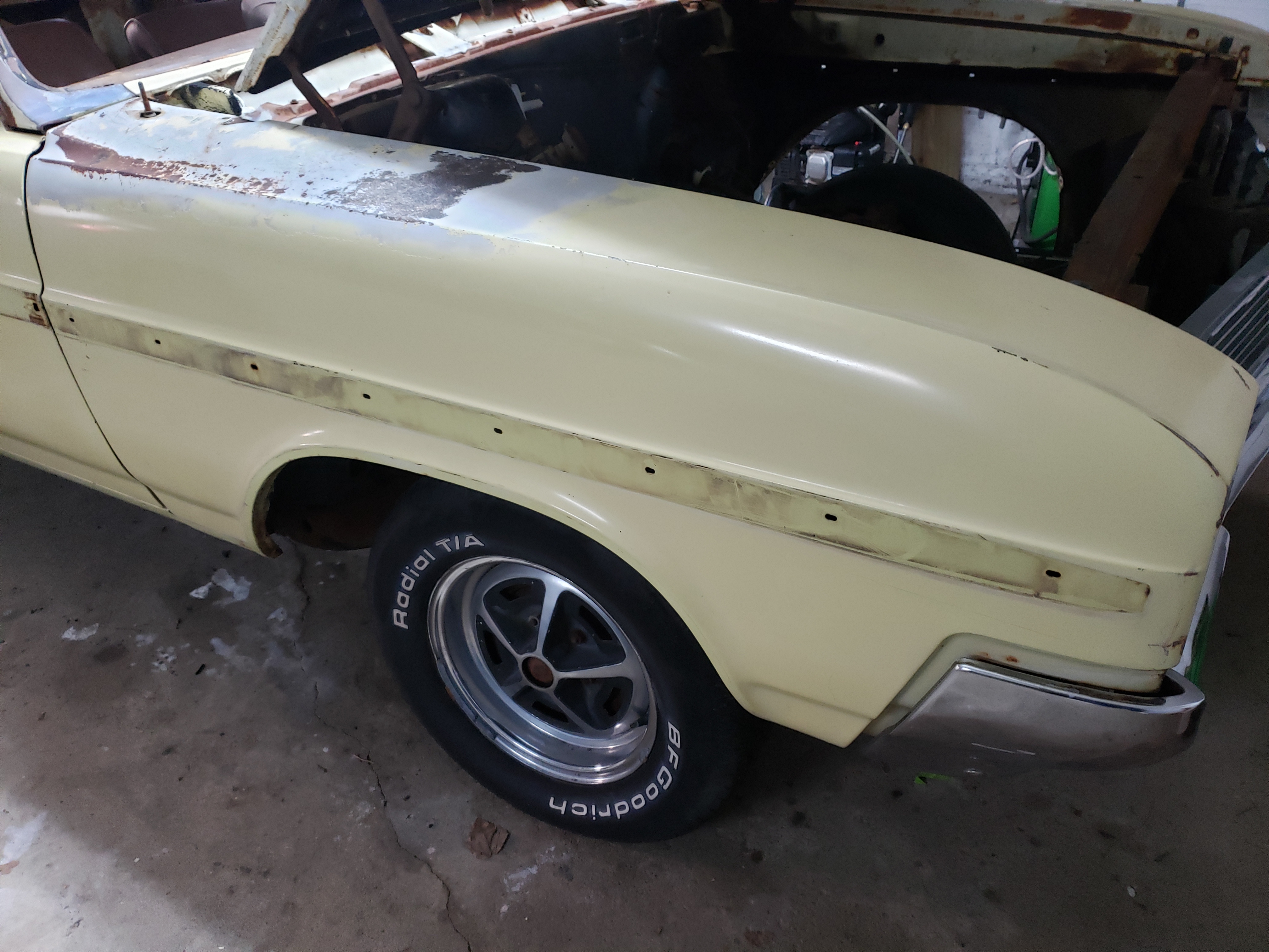

Busy weekend but I still carved out some time for the Buick. I removed the hood letters, the cowl panel, the wheel arch moldings, the front fender side moldings and the rear windows and regulators.

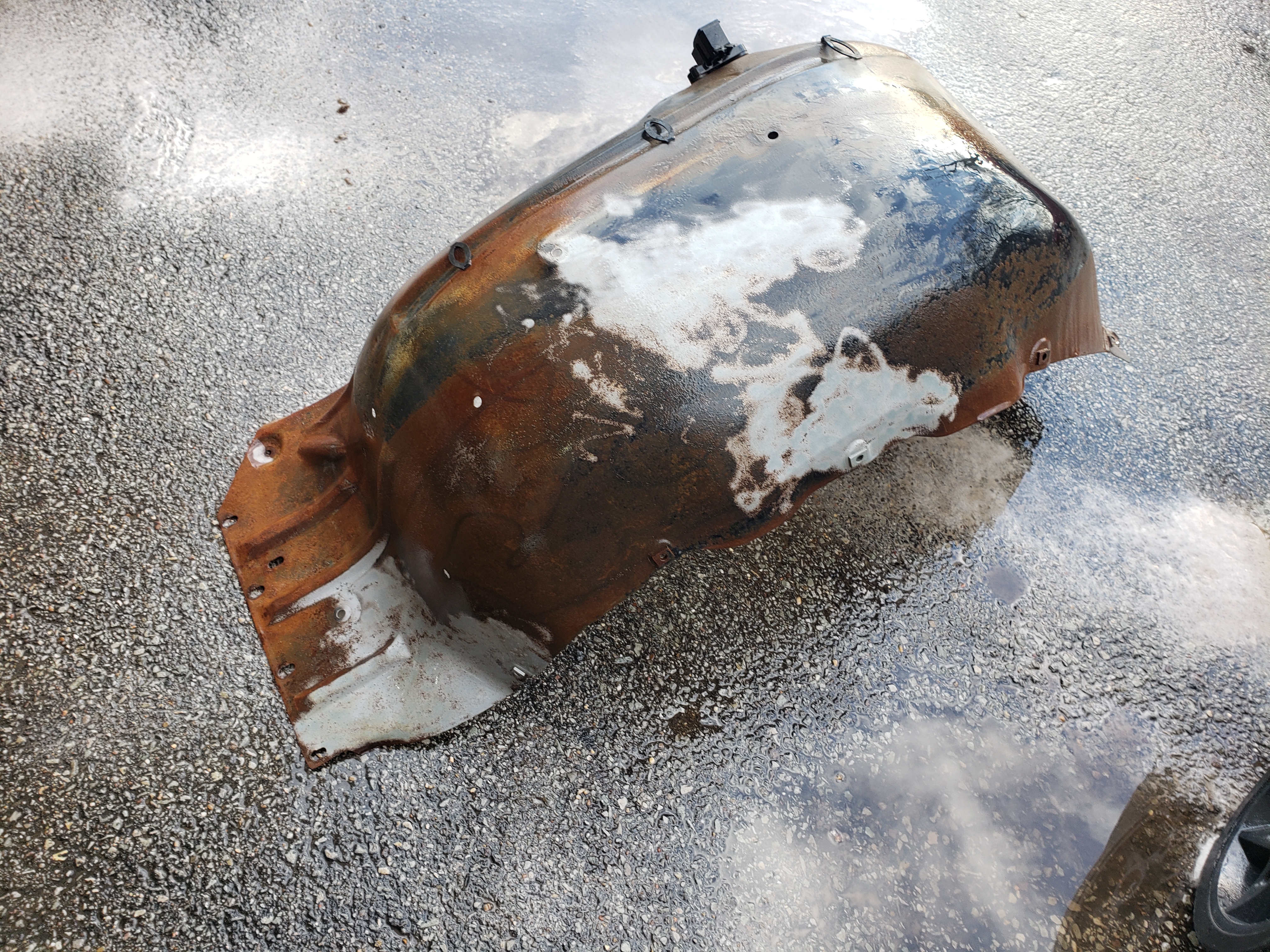

So I began researching different options for cleaning metal. Media blasting is great except it is super messy and I am limited by my compressor. Then I saw this pressure washer wet blasting attachment from Eastwood.
It looked promising but I was hesitant to spend $100 on something that might not work, so I found a $30 knockoff on Amazon. It arrived today and I did a test on one of the inner fenders with some old glass bead media I had sitting around and it works really well. It would probably work even better if I had a dedicated 5 gallon bucket to siphon the media from instead of the cardboard box I was using. I don't know if I'd want to blast a whole car with this setup, but I'd have no problem blasting a core support or these inner fenders.
These spots took me about 10 minutes of playing around. I sprayed them with the phosphoric acid afterwards to prevent flash rusting. I'm going to pick up some coal slag or aluminum oxide media and I should have no issues cleaning any of the hard to reach areas on this car.
View attachment 216465View attachment 216464

Here it is. The hose is short so I'm going to go over to home depot and see if I can find a longer piece of PVC tubing.
Selkie Pressure Washer Sandblasting Kit - Wet Abrasive Sandblaster Attachment, with Replacement Nozzle Tips,Protect Glasses, 1/4 Inch Quick Disconnect, 5000 PSI https://www.amazon.com/dp/B086W4TNQC/?tag=gbody-20

I've used black beauty on heavily rusted parts and it works great. Might be a bit too coarse for that rust, especially on visible body panels.
Yeah I know aluminum oxide is very aggressive. This glass bead i had laying around worked well, I can't even remember where I bought it.
