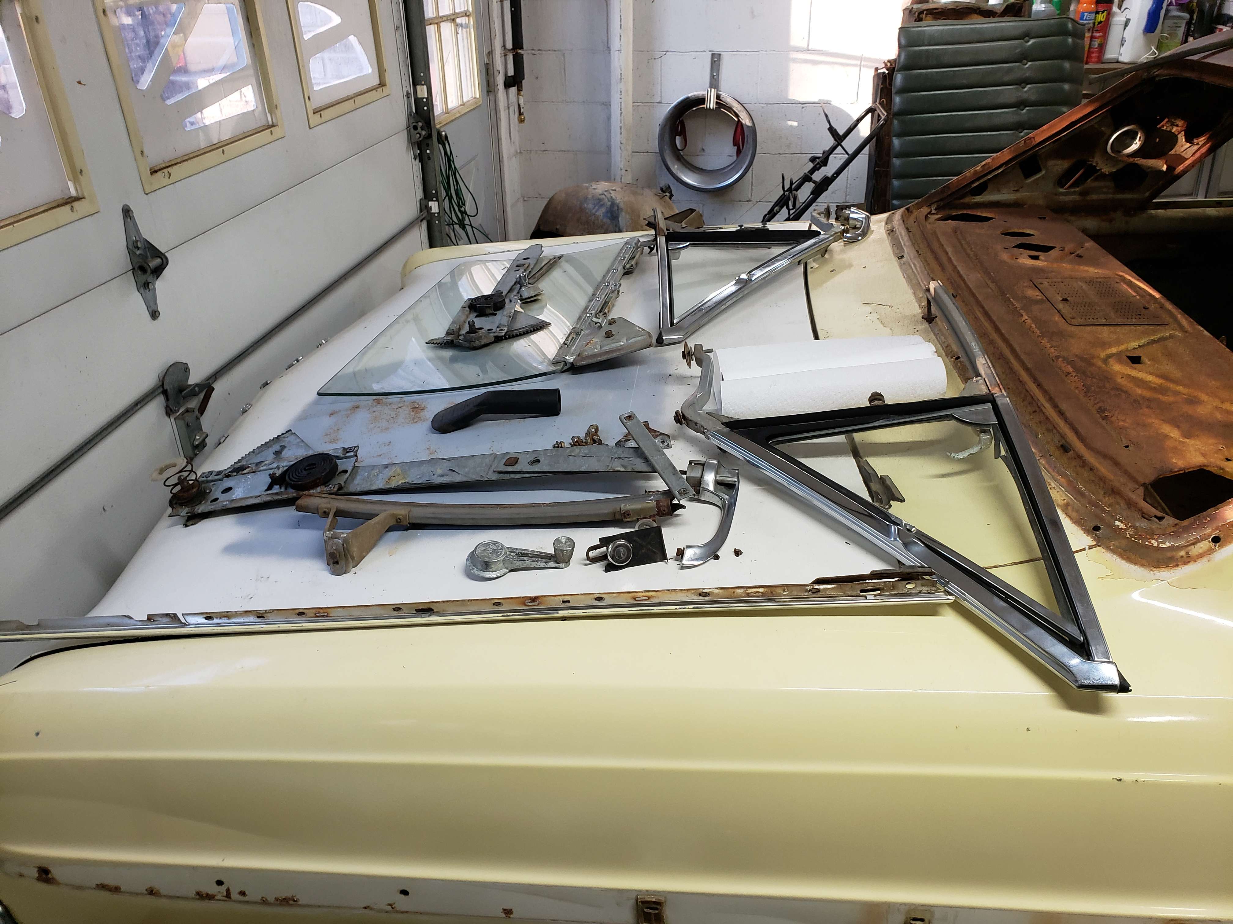

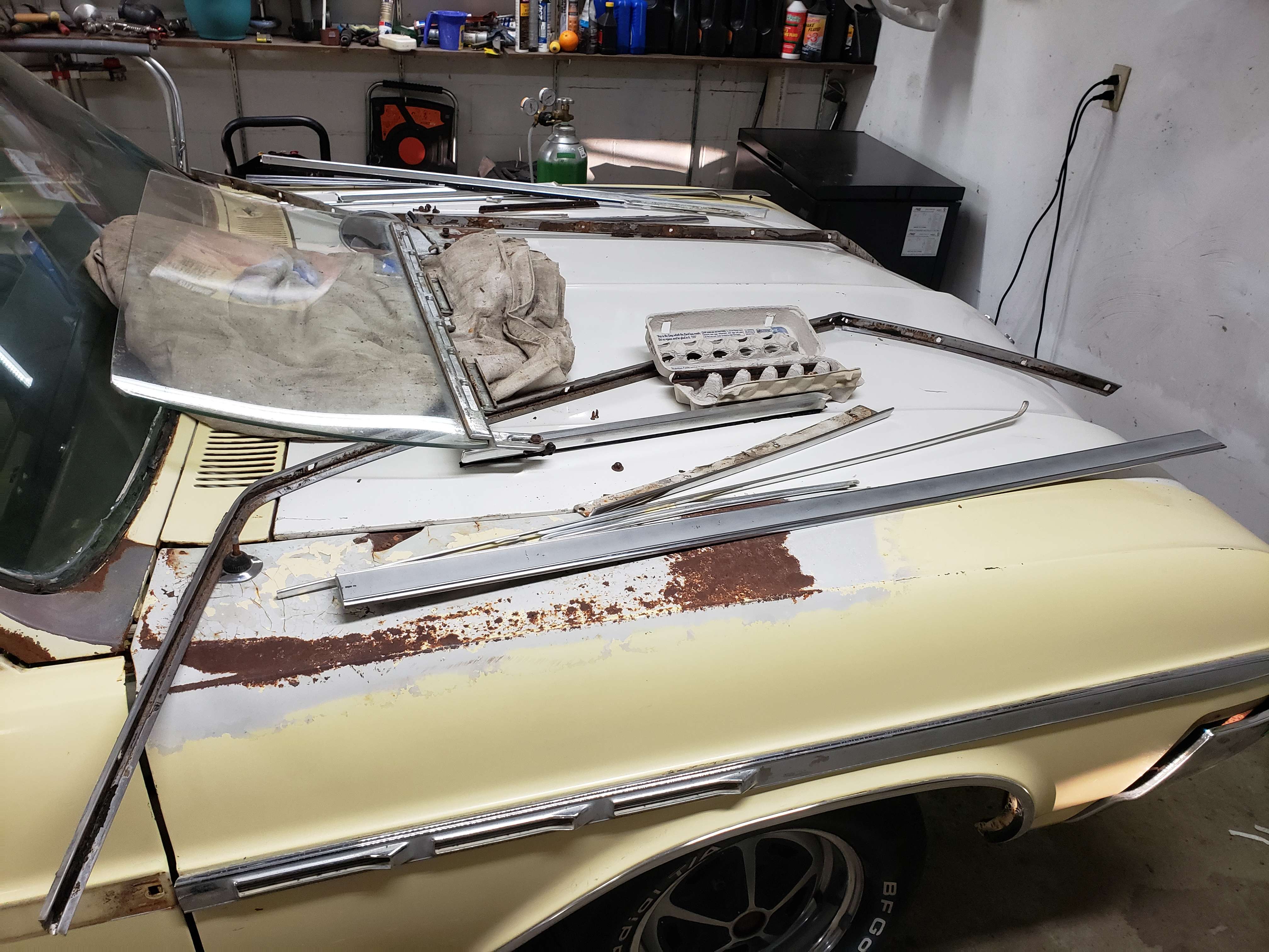

As much as it pains me to, I began disassembly today. Disassembly is one of the least fun part of the project. I removed the front and sides of the "halo" trim around the roof. The sides came off nicely but the fronts weren't salvageable, they were just too corroded. They wouldn't have looked good on a freshly painted car anyways.
The rear window sort of uninstalled itself. As loose as it was, I'm lucky it didn't fly out on the ride home. There is a little bit of channel rust after all. Not horrible but it needs fixed.
With the rear seat out, you can see the worst rust on the whole car.

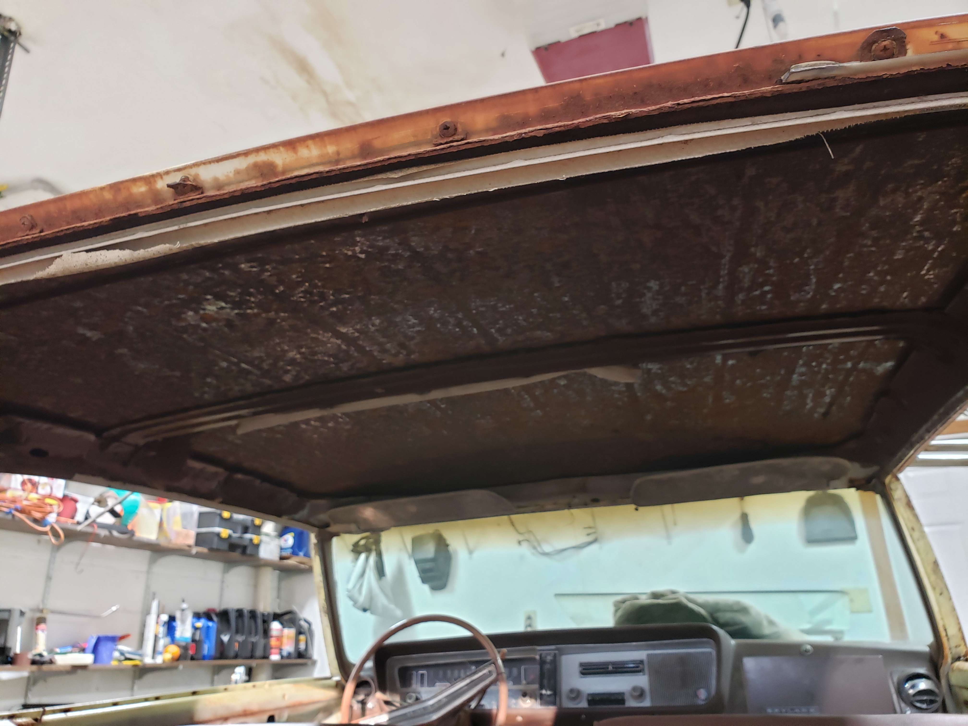

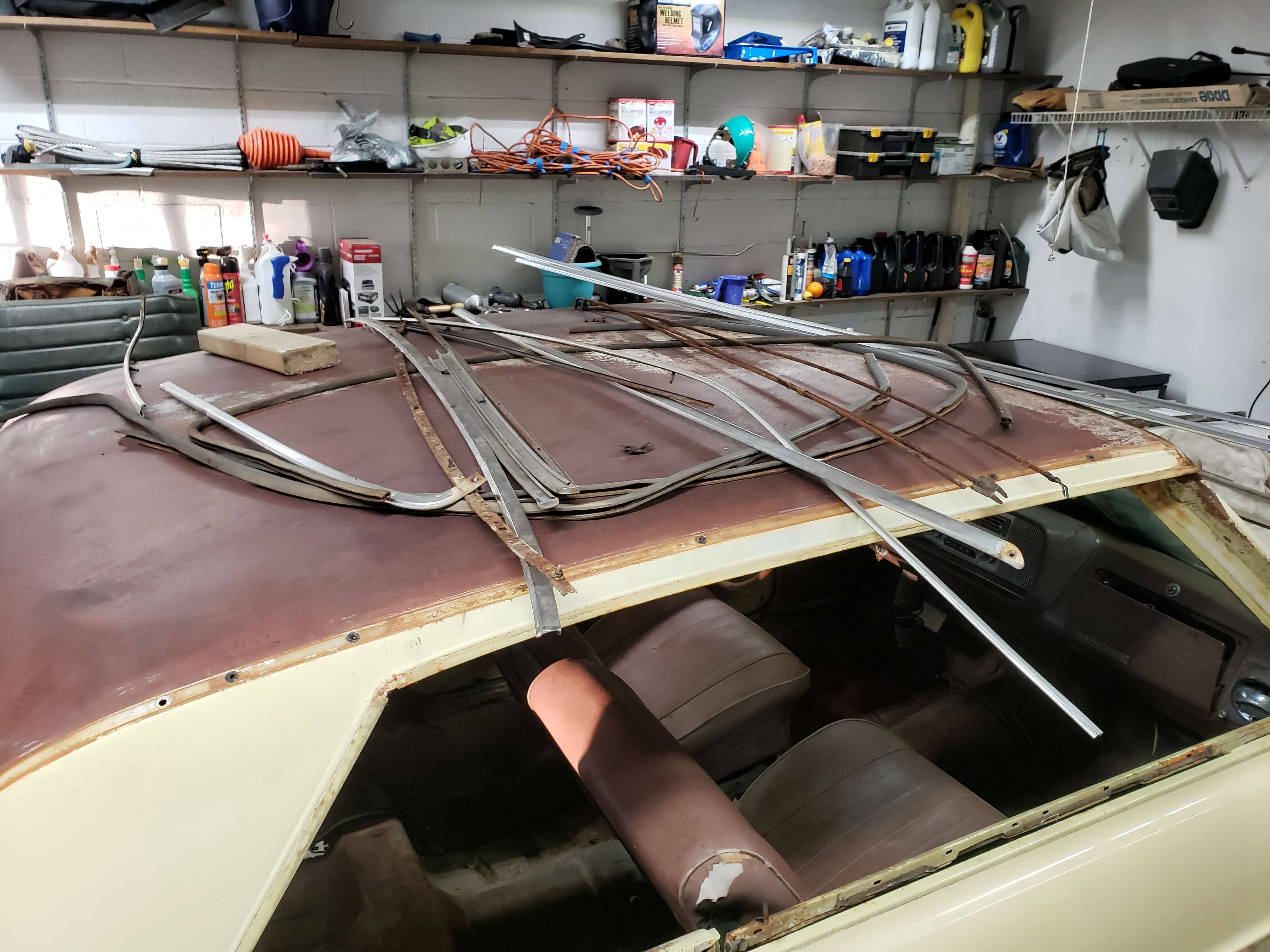

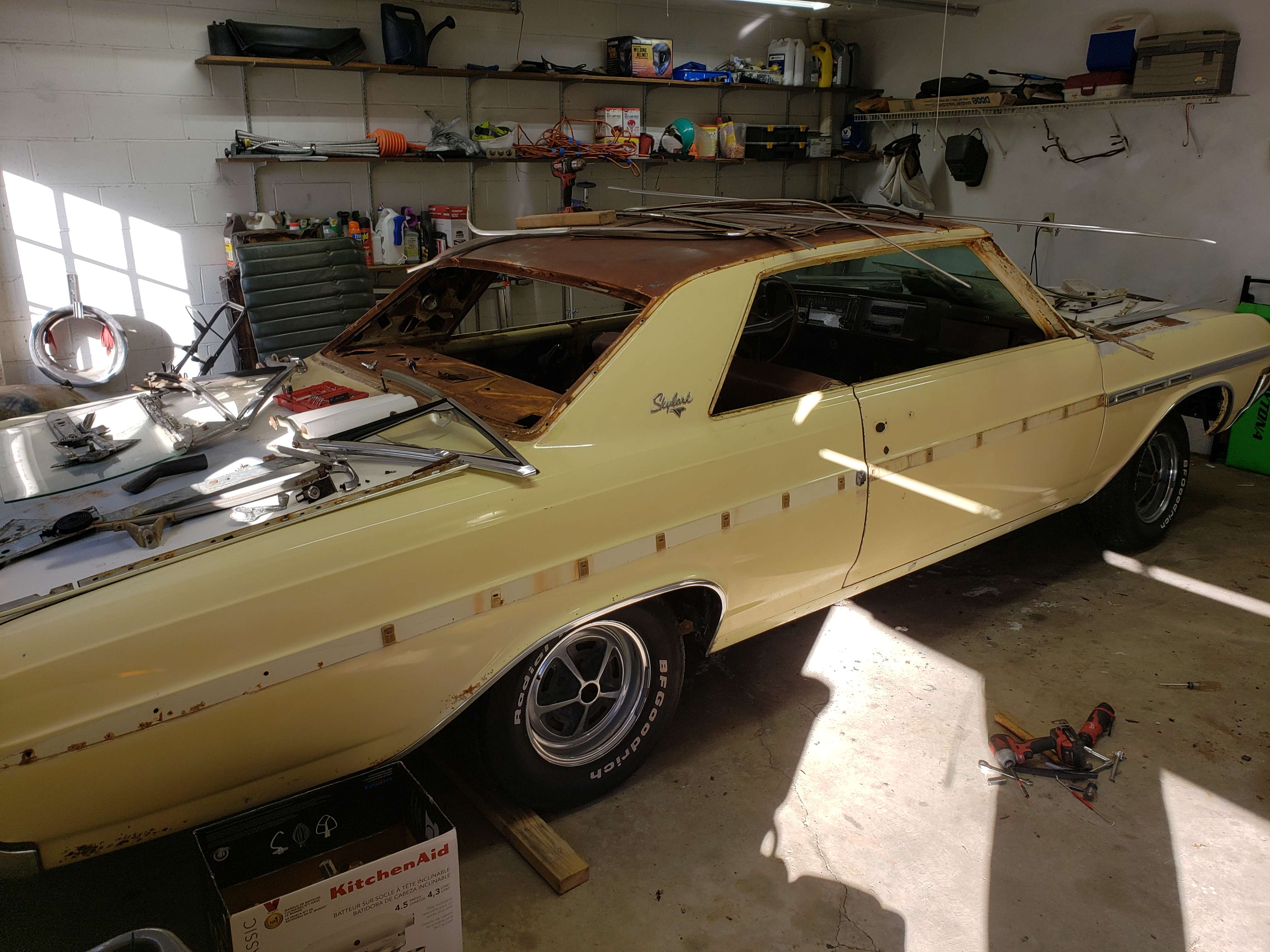

Got a little more disassembly done today. The rest of the halo trim is removed as well as the drip rails, window moldings, and I got the doors mostly disassembled. I also removed the headliner bows and what was left of the headliner as well as the long dead mice who had been living up there. I'm almost amazed at how easy this car comes apart- SAE fasteners, all were easy to get to and very few stripped or were too rusty to remove.

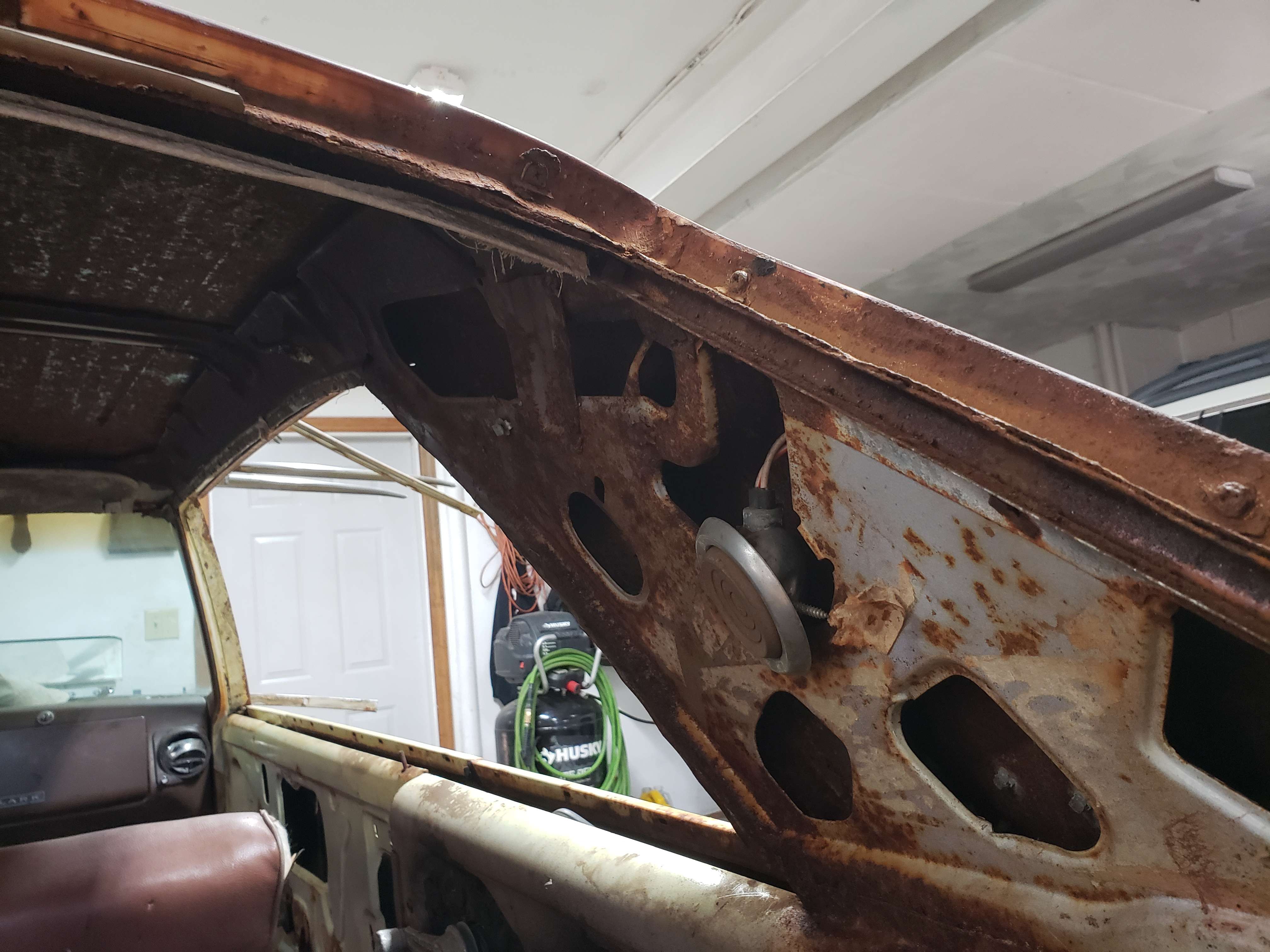

I didn't find any real surprises, however there is a lot of surface rust on the inside of the roof panel and c-pillars, as well as inside the quarters and under/around the package tray. I imagine it is partially from mouse urine, but I also suspect GM spent little, if any effort at all painting these areas.
None of the surface rust is horrible but I think it would be almost impossible to remove it without blasting or chemically dipping the body. It seems like it would be a good application for POR-15 but I've had very mixed results with it in the past and I don't have enough faith in it to use it everywhere in the car, on top of the fact that I don't really like the mechanism by which it works.
I'm curious to hear what ideas some of you may have. Any experience with Rust Bullet or Eastwood products? Or should I treat it with something like Ospho or Rust Mort? I've used Rust Mort for small pits but never for large areas. I've never used Ospho. I'd love to hear any suggestions.
Rustmort was someting I sold a lot of when I was at the body supply store. As for the lack of coating that GM was good for back in the day, it might be better to look at what Eastwood has (or simular) that ca be sprayed into the tight spots.
Not familiar with Ospho, but have used RustMort and had decent success with it. Big issue with Rustmort is cost, but it can be put into a Schutz Gun or undercoating gun and shot into the cracks and crevices that way. Mine to do, I think I would see if Krylon Rust Paint comes in quarts and gallons and top coat the RustMort with that once the rust killer has died. Otherwise, as you say, your cabin might be in for a swimming lesson.
