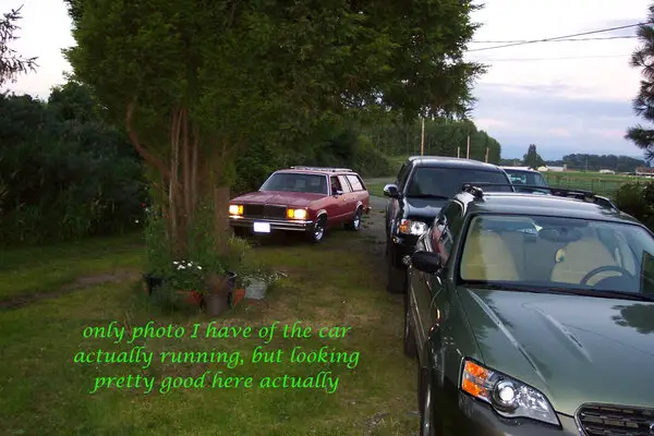

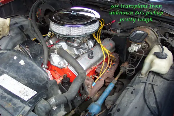

It "bought it" as a V6, however, I found another mechanic who traded me some of the engine/parts from the Nova and for some extra $$$ he put in a 305. I got the car back with the V8 swap and it was a totally fun car. It wasn't blowing any doors off, however, was a lot of fun. It did have a few upgrades, RV cam, intake, and edelbrock 1406 carb. and Th350 trans w/shift kit. I took that wagon all over, went to several concerts at the gorge, and basically cruised all around seatown. After graduating college I moved up North and my fiance kinda didn't want the car around. I had a truck, well you know the rest....

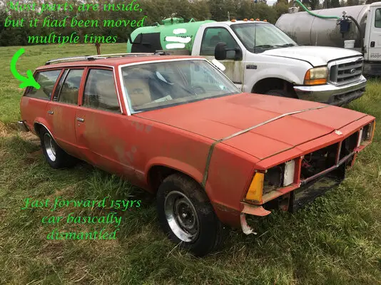

Fast forward 15yrs, my friend Jon, a thinking man, essentially dismantled the car, but along the way also did many upgrades that I had absolutely no care about when I owned the car. Such as improving the suspension. He redid the brakes. Put in larger sway bars up front and added a rear. New shocks all around, quick ratio steering box. I also helped him install headers, which involved modifying the trans cross member, and 3" full dual exhaust w/ flowmasters.

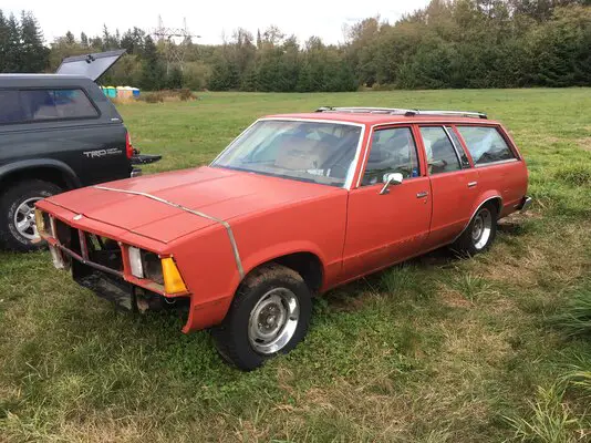

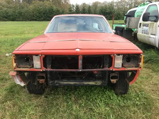

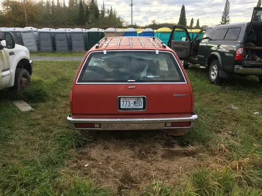

He ends up getting engaged to a wonderful gal, however, in the meantime was storing the car at his parents house. I'm not sure who put down the ultimatum, but it worked in my favor because he calls me an says "how'd you like the malibu back?" So of course I said yes, however I had to pick it up right then or he was going to scrap it. Overall it really felt like deja vu

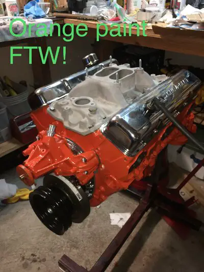

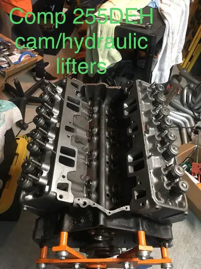

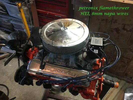

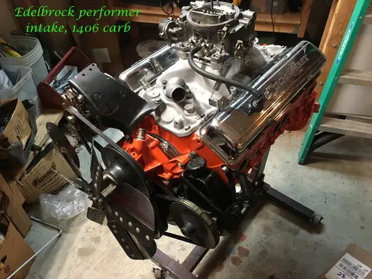

Bottom line is I'm working on getting this ole girl put back together. My new wife has a 14yr old son who is stoked on cars. We've got the motor put together and it should be a runner. My weakness is body work and I'm still trying to decide whether or not to go for full on re-spray or just assume the kid is going to destroy it. I did redo the hinge pin on the drivers door and adjust everything back so the lines almost look good again.

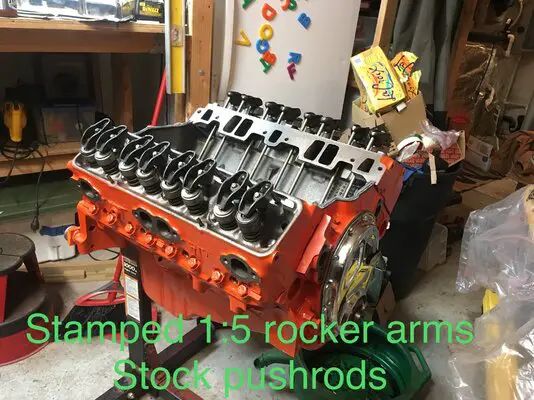

Will post some photos of the engine build. Got that baby dropped in this past weekend. Wont be long and I'll be back on the road ; )

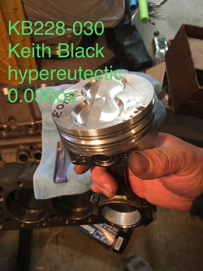

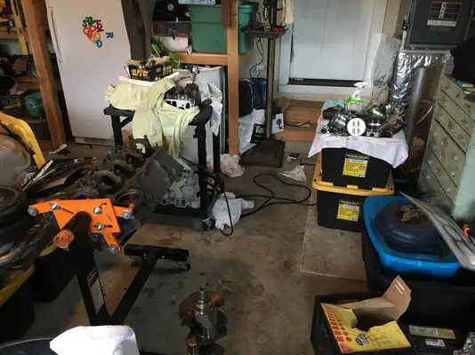

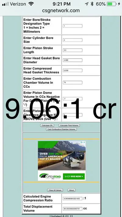

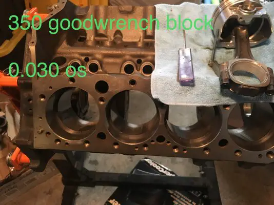

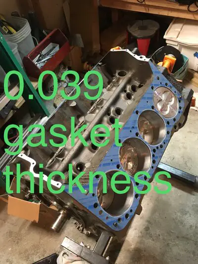

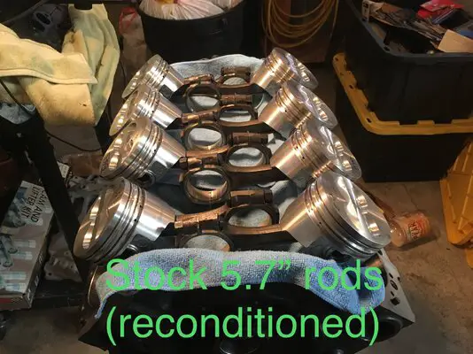

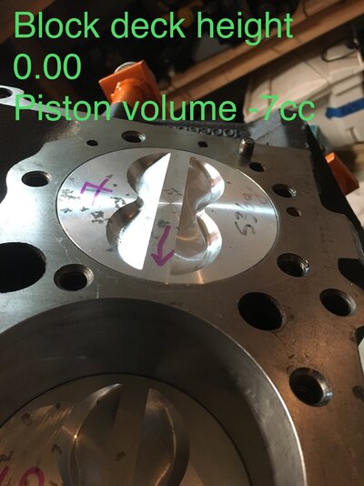

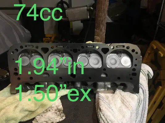

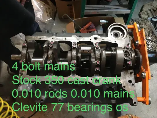

Took a while to get the engine all put together again but with this combo I'd be happy if I could get 300hp. Left huge endgaps on the top ring because may run n2o at some point and those KB pistons are known for binding issues.
