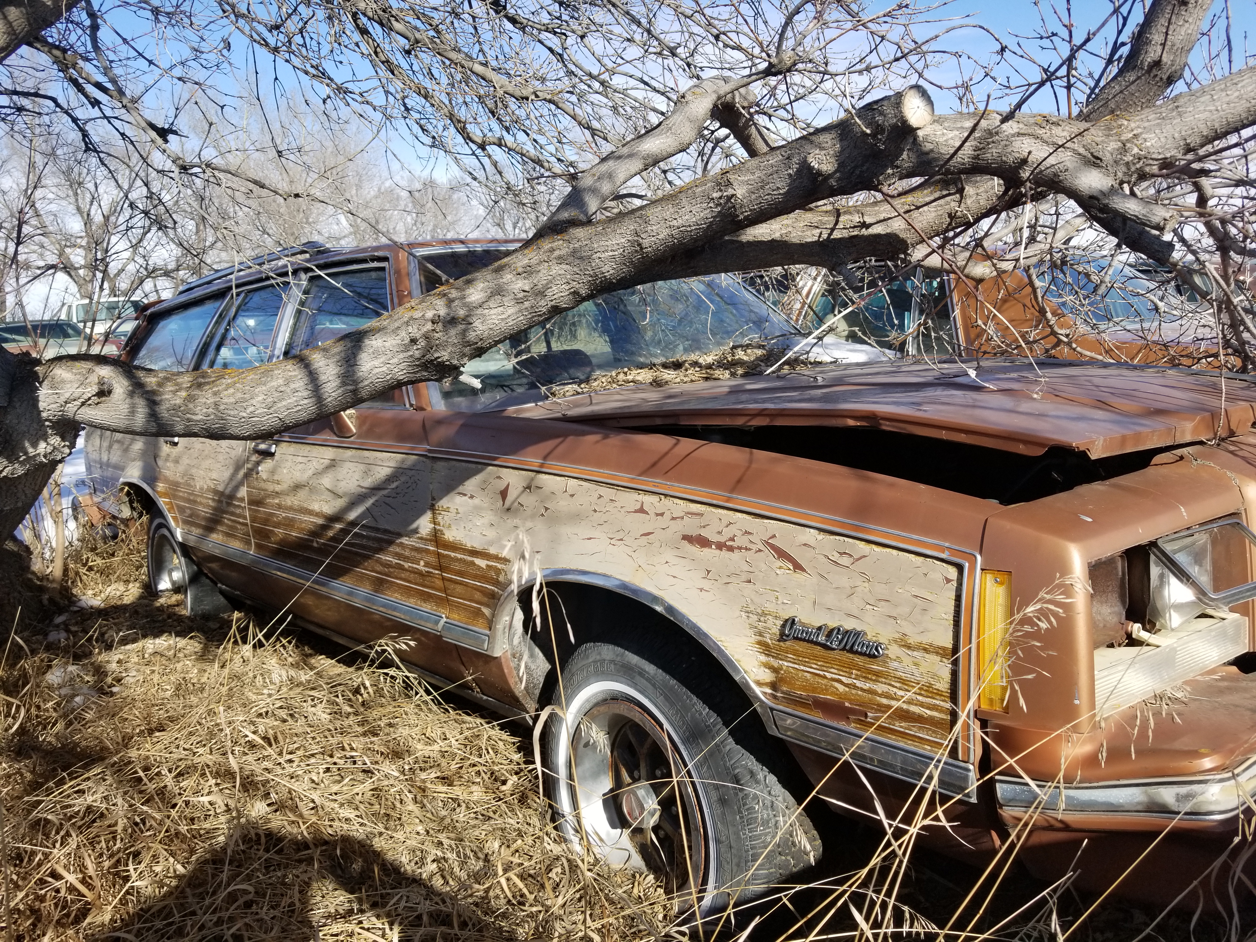

Michael...I've got nothing on hand right now...I do have the interior pretty much gutted on this Pontiac wagon so have easy access to the locks...
We closed the trailer up for the season this last weekend so now I can get back in the yards..could go this weekend.

When you get chance it would be appreciated.
