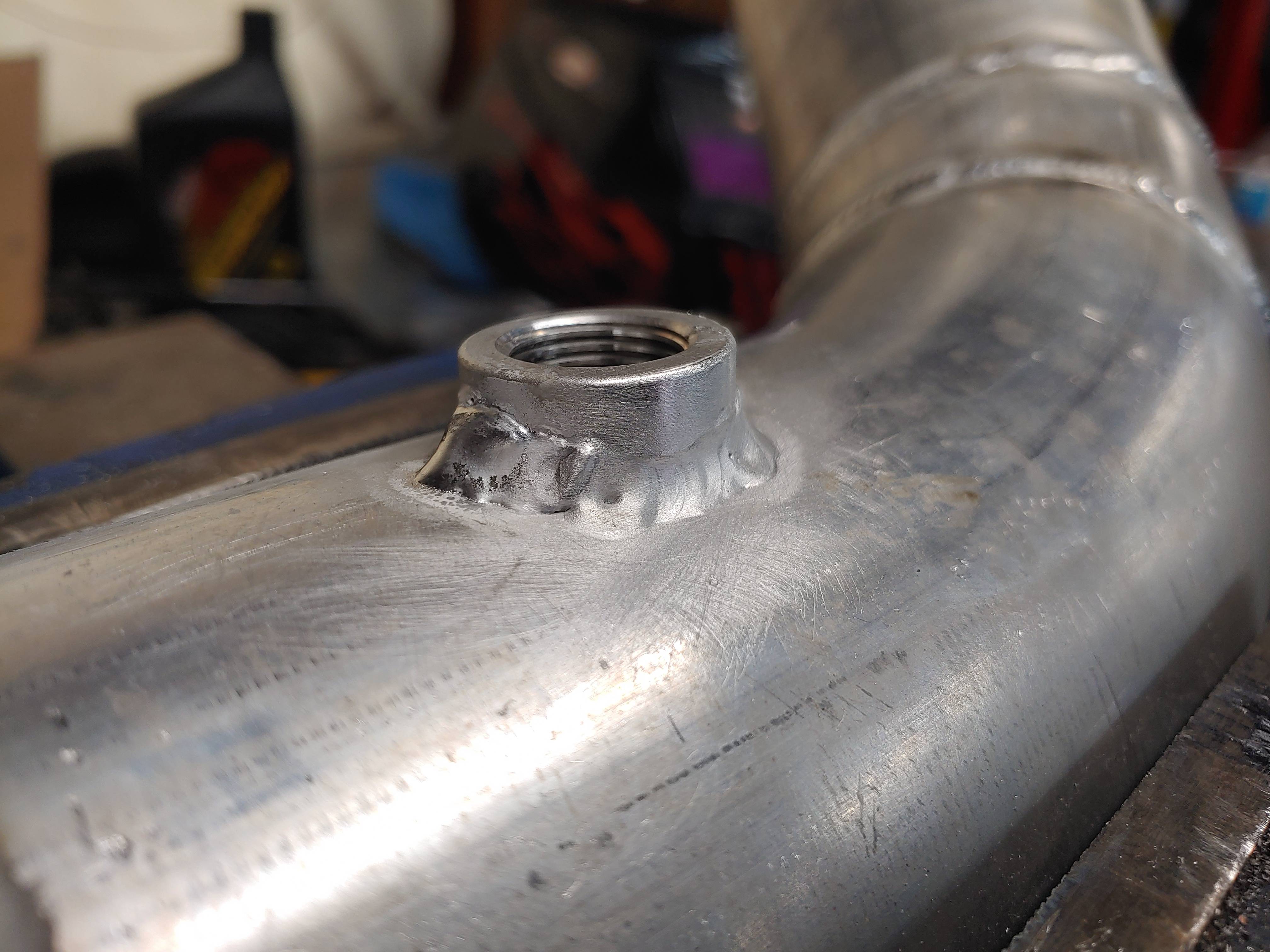

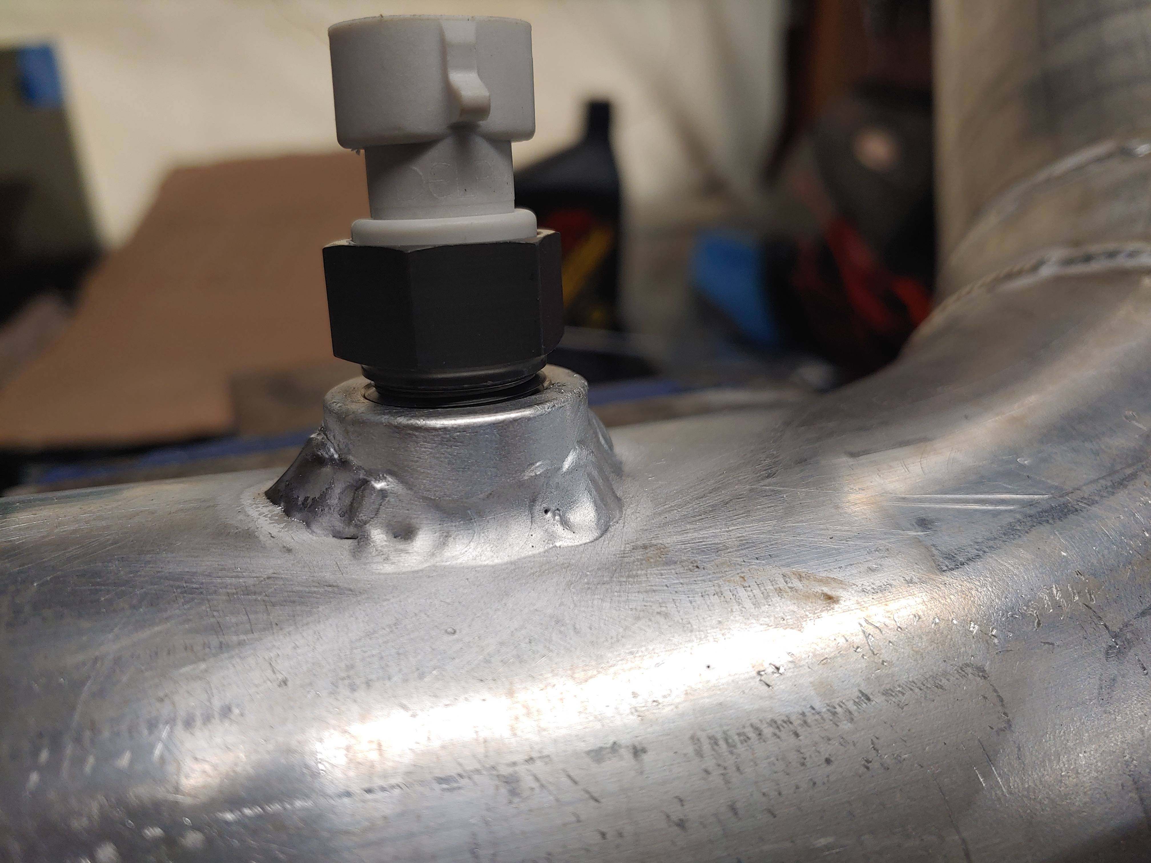

Not too bad. Just remember to work from thick to thin and add more filler rod to the thin side to help control the heat. You can always go back and do targeted penetration passes on the joint. It isn't structural.
I was definitely trying to but I have have 15 mins of tig experience, so having to weld this in my offhand standing up... Wanting to do something and actually doing it are different lol.
There was a couple spots I focused too much on the bung and not enough on the pipe that it didn't wet in to the pipe. I had to go back and go over it with just the torch and no filler to get it right.
