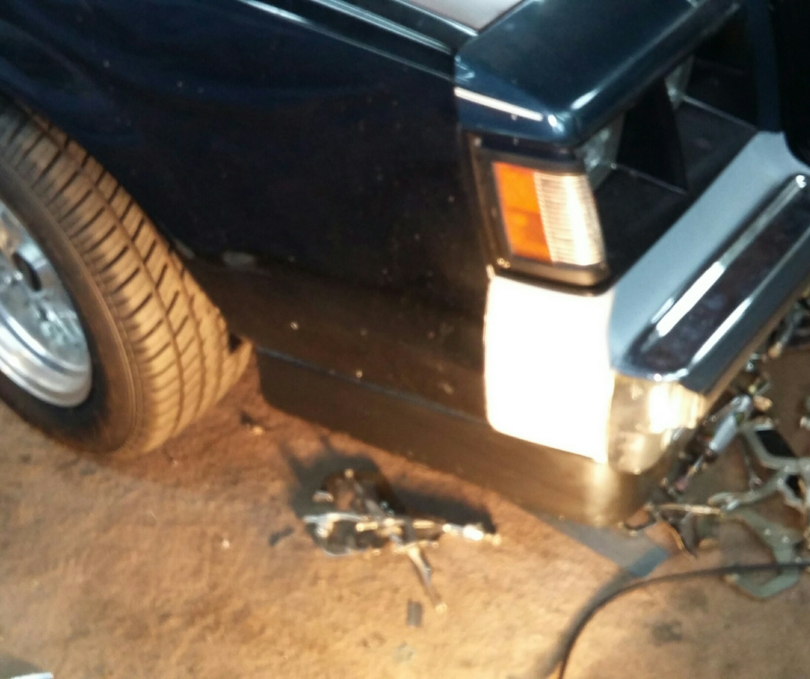

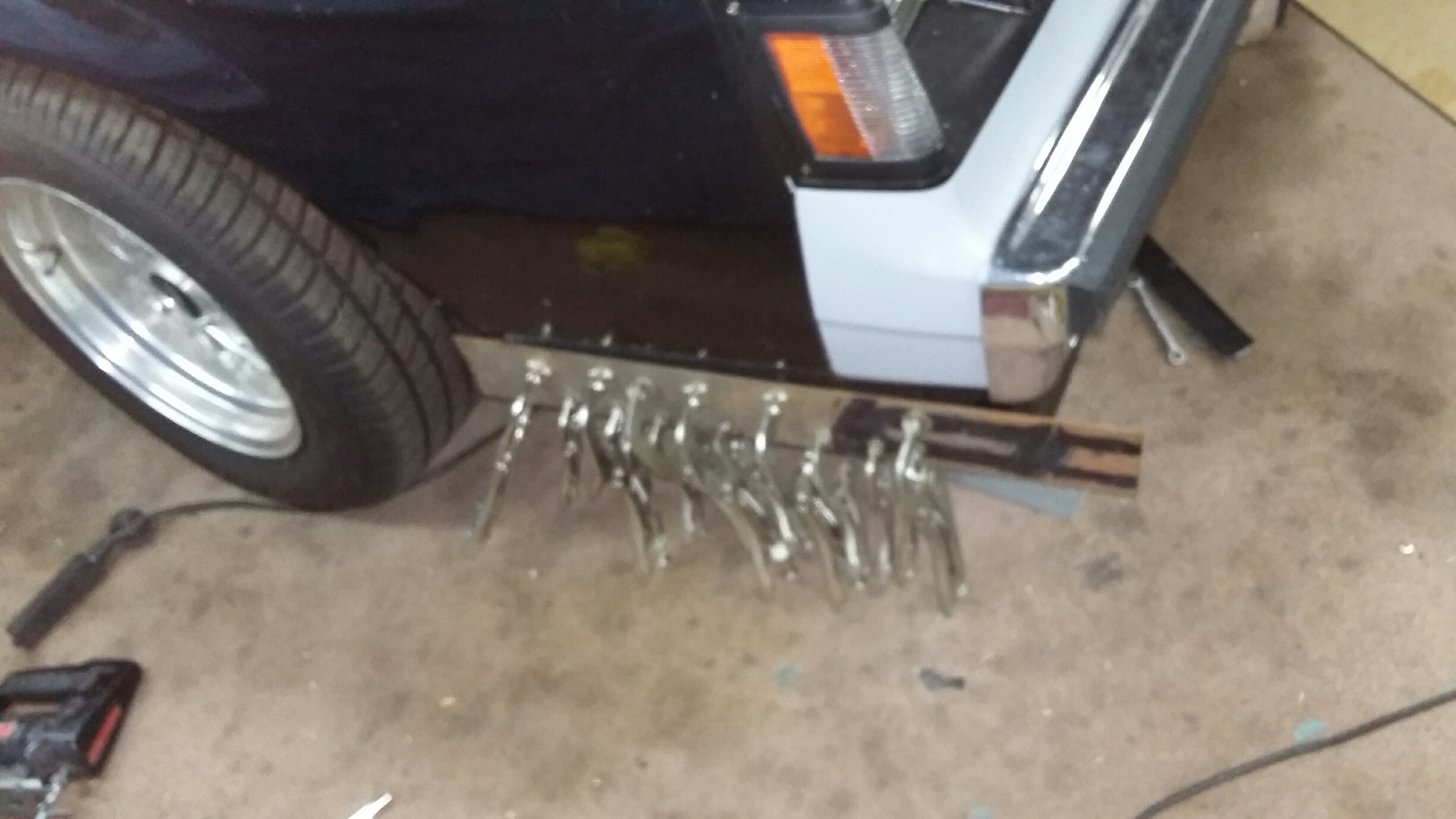

So while bolting up the GbodyParts front spoiler I must have pulled on the cord with the 500 watt halogon light and it rested against the middle of the passenger side of the spoiler long enough to warp it pretty bad so I tried my heat gun on low and spraying it with water to get it back in shape and that didn't work. so my solution was I cut a piece of 1/8" aluminum to match the full length and width of the inside of the spoiler and scuffed both surfaces up and applied 3M panelbond and then used a piece of 1/8" steel to apply pressure from the outside and clamped the crap out of it.
Worked perfectly!
View attachment 78385 View attachment 78386

So I liked how well my fix went on the front spoiler and how much sturdier it feels so I decided to do the same to the driver's side.
