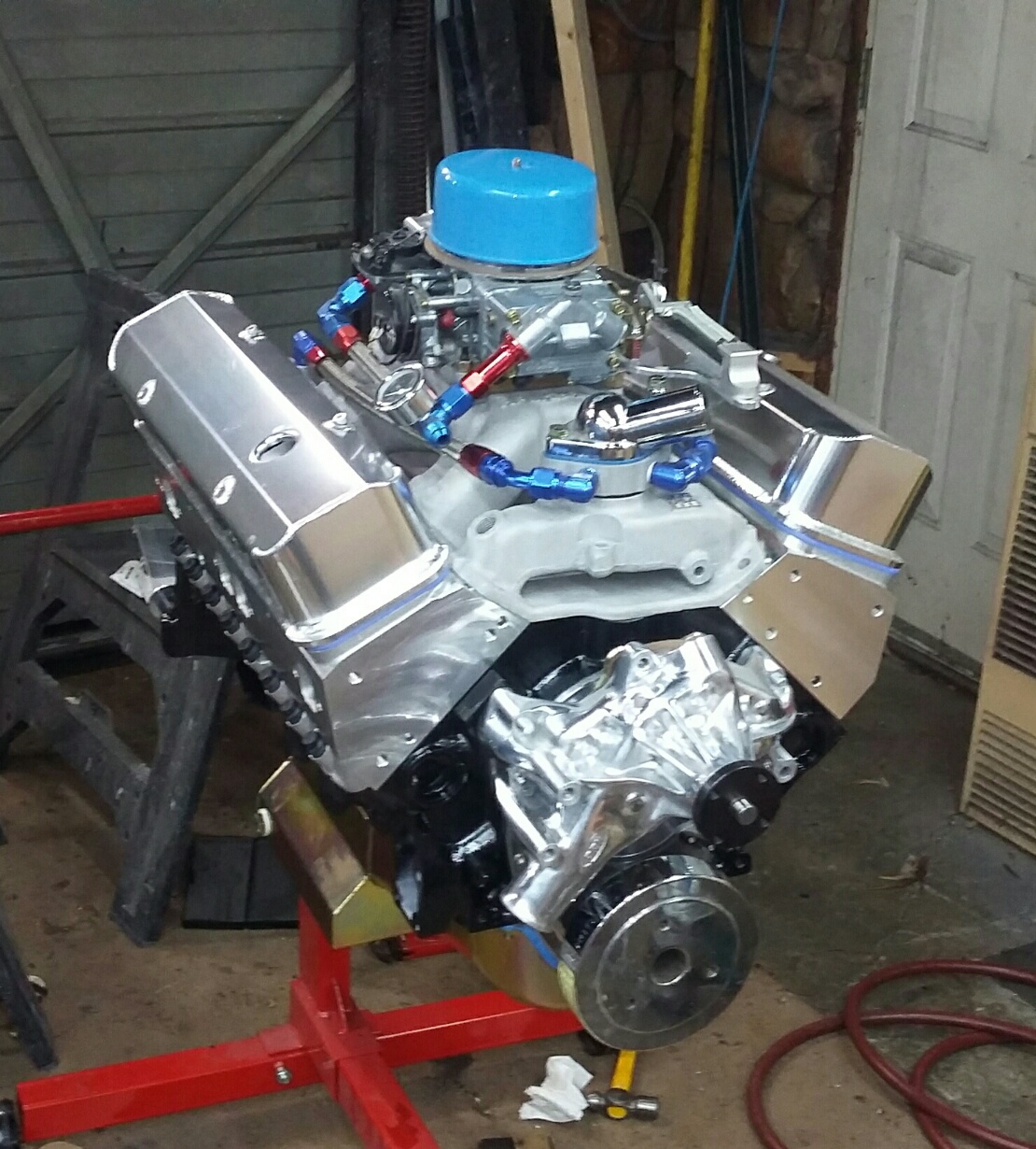

I started doing mock ups on the 355 SBC short block, test fitting the oil pump and pan with the Cloyes timing cover.
I will probably paint it Tomorrow since I used up all of my gloss black engine paint on the Monte engine.
I have the 355 mostly assembled I am just waiting on pushrods and a few smaller items so I decided to throw everything on while I wait to get an idea on how it was going to look. I still have to hone out the harmonic balancer so I can install that next.
