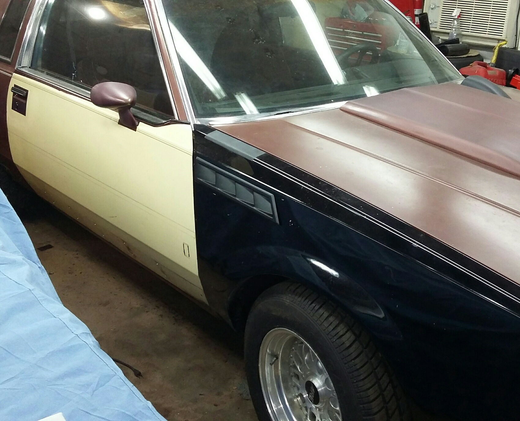

I considered the flares but I have the same stage 1 Lauren Engineering ground effects as my Monte to install so I bought the black wheel well molding instead to work better with them.
Reactions: Texas82GP and TURNA
Looks nice! Where did you get the vents?
I believe I bought those new on Ebay from ThePartsPlace same place I bought my hood tach.

So while bolting up the GbodyParts front spoiler I must have pulled on the cord with the 500 watt halogon light and it rested against the middle of the passenger side of the spoiler long enough to warp it pretty bad so I tried my heat gun on low and spraying it with water to get it back in shape and that didn't work. so my solution was I cut a piece of 1/8" aluminum to match the full length and width of the inside of the spoiler and scuffed both surfaces up and applied 3M panelbond and then used a piece of 1/8" steel to apply pressure from the outside and clamped the crap out of it.
Worked perfectly!
3M Panelbond is great stuff, that was a pretty slick fix.
