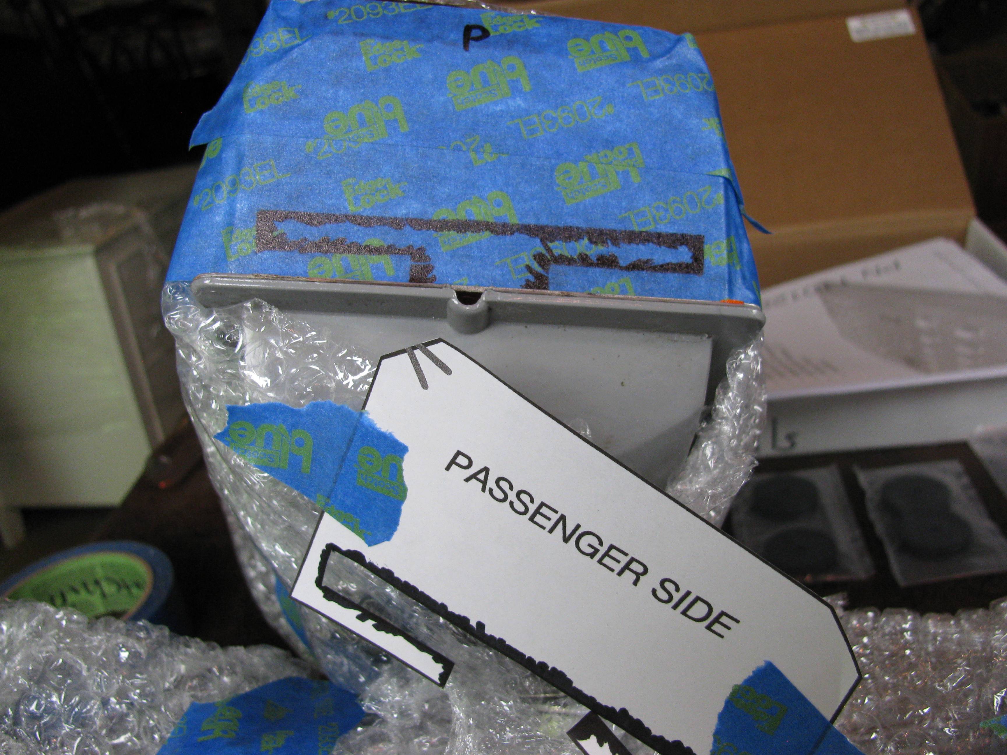

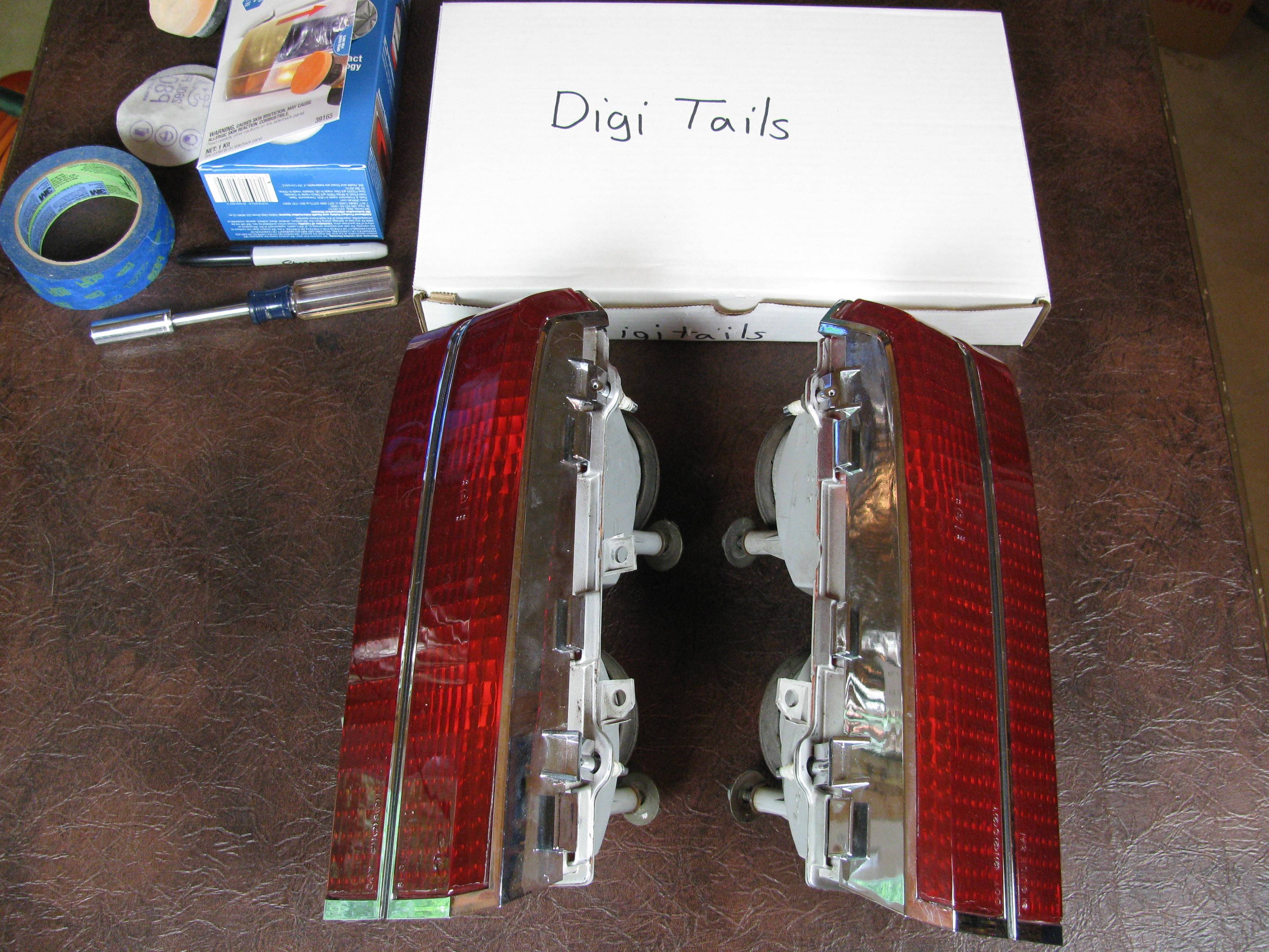

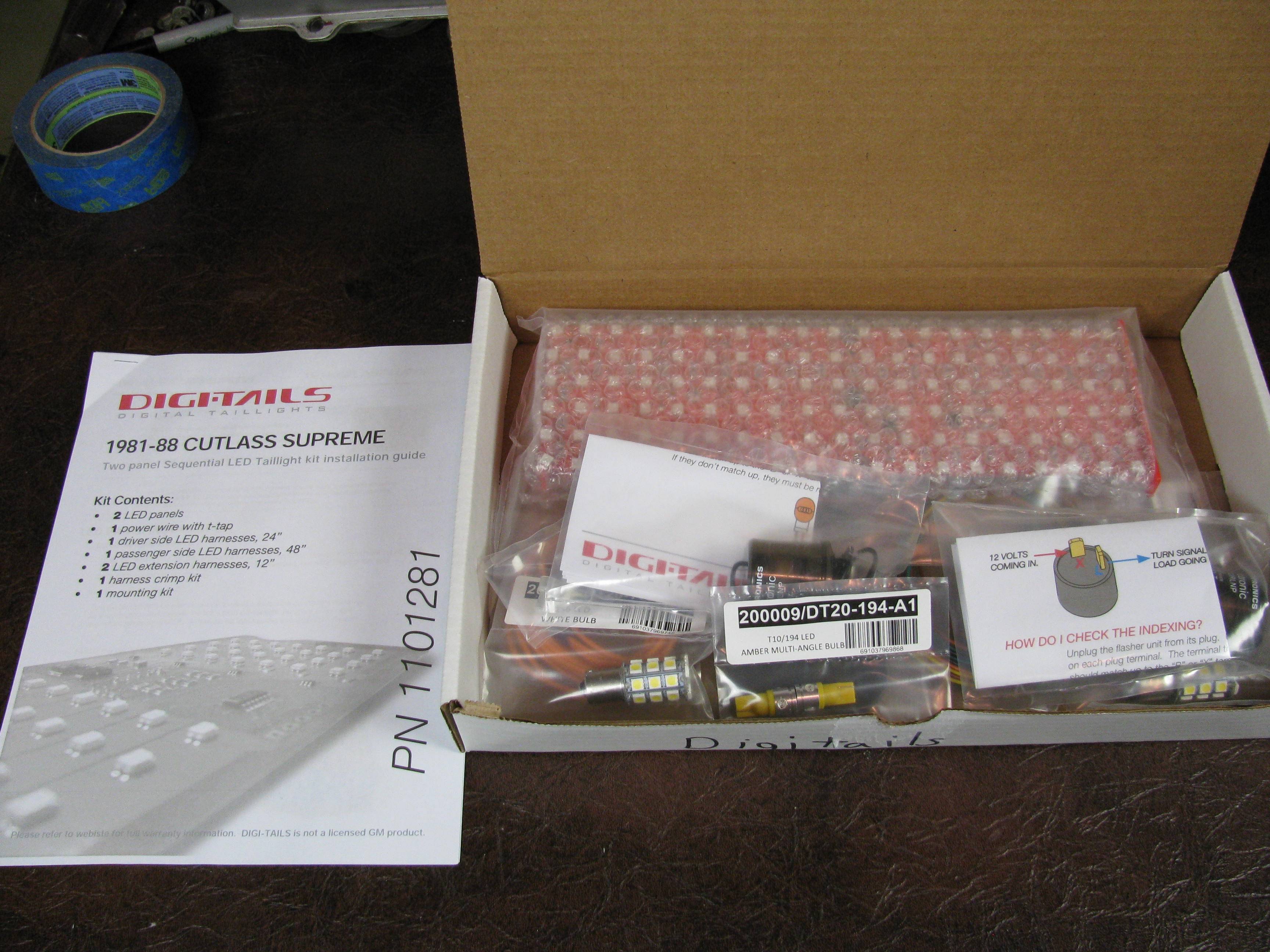

Just started my Digi-Tails conversion of my 81-83 Tail Lights.

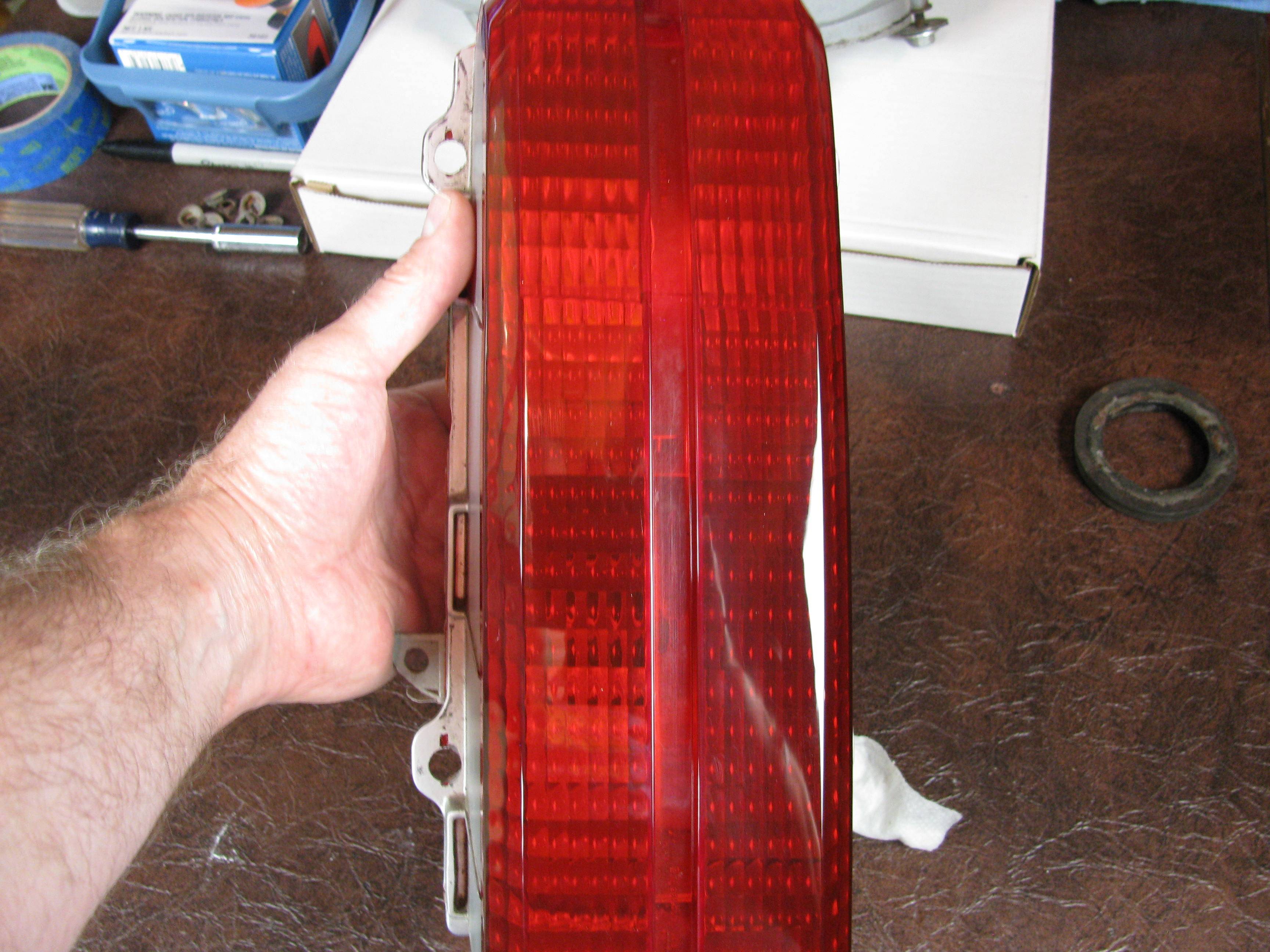

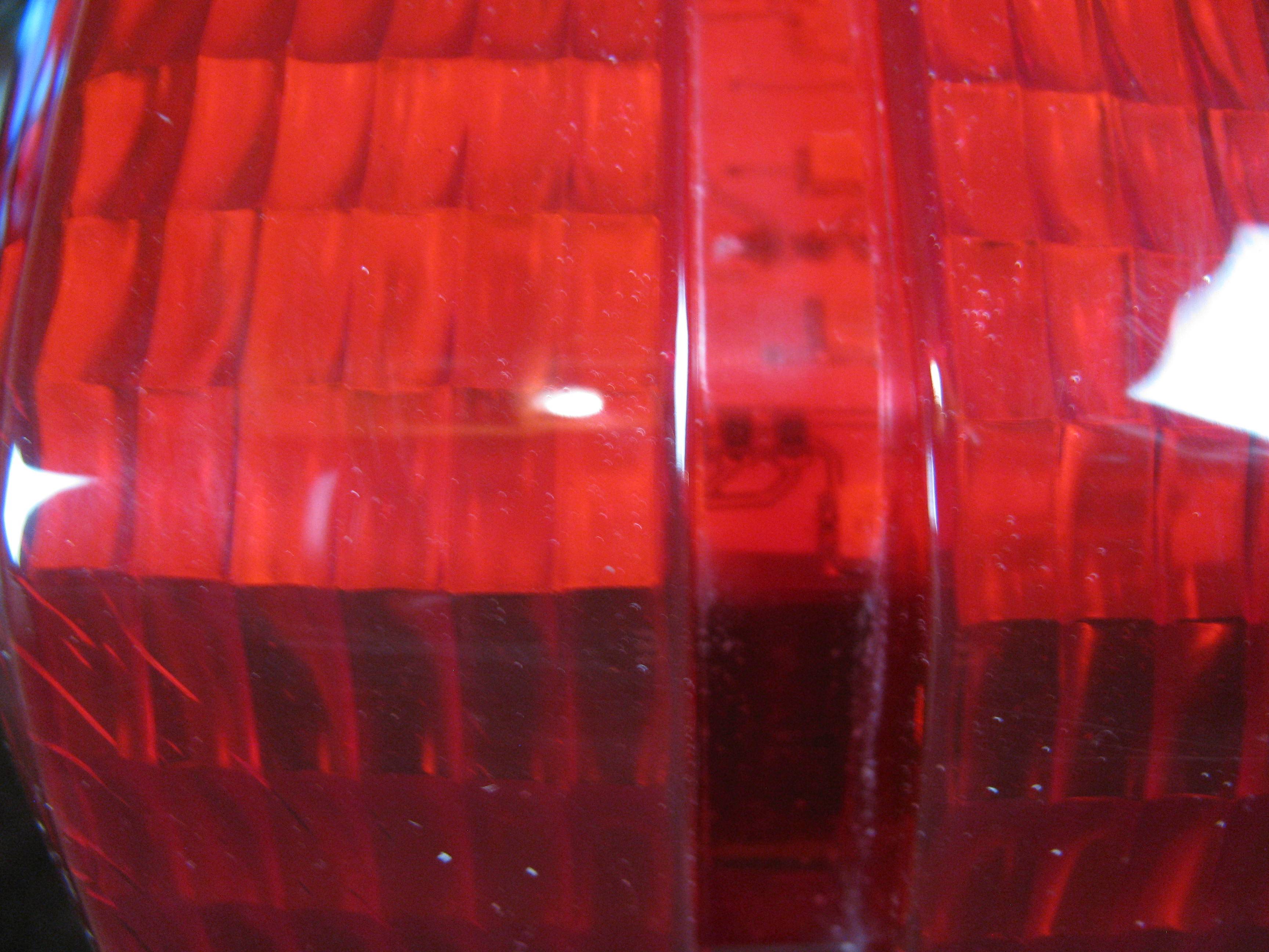

First I sand and buff the writing off the lens and polish the plastic chrome.
The instructions are very detailed.

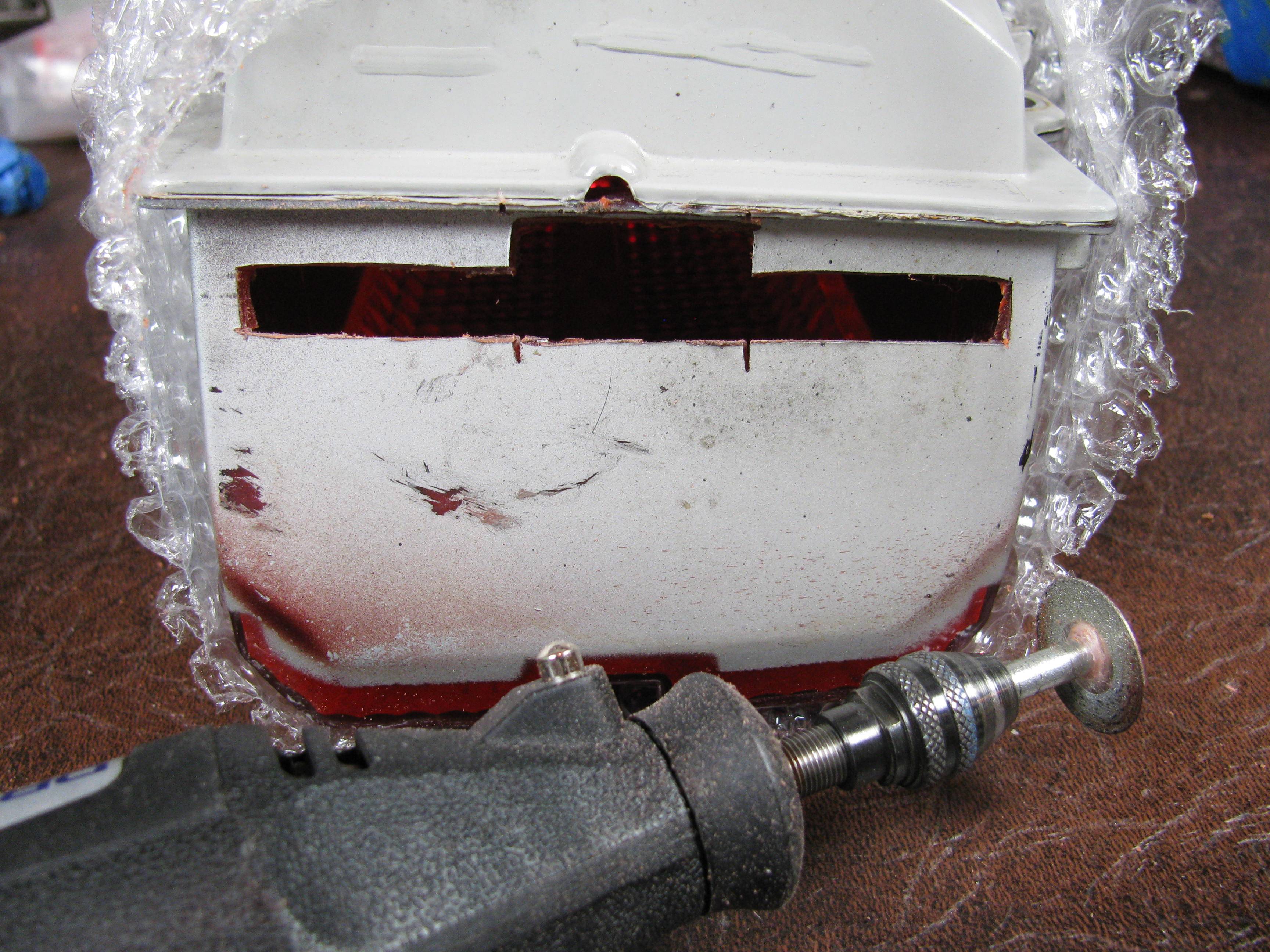

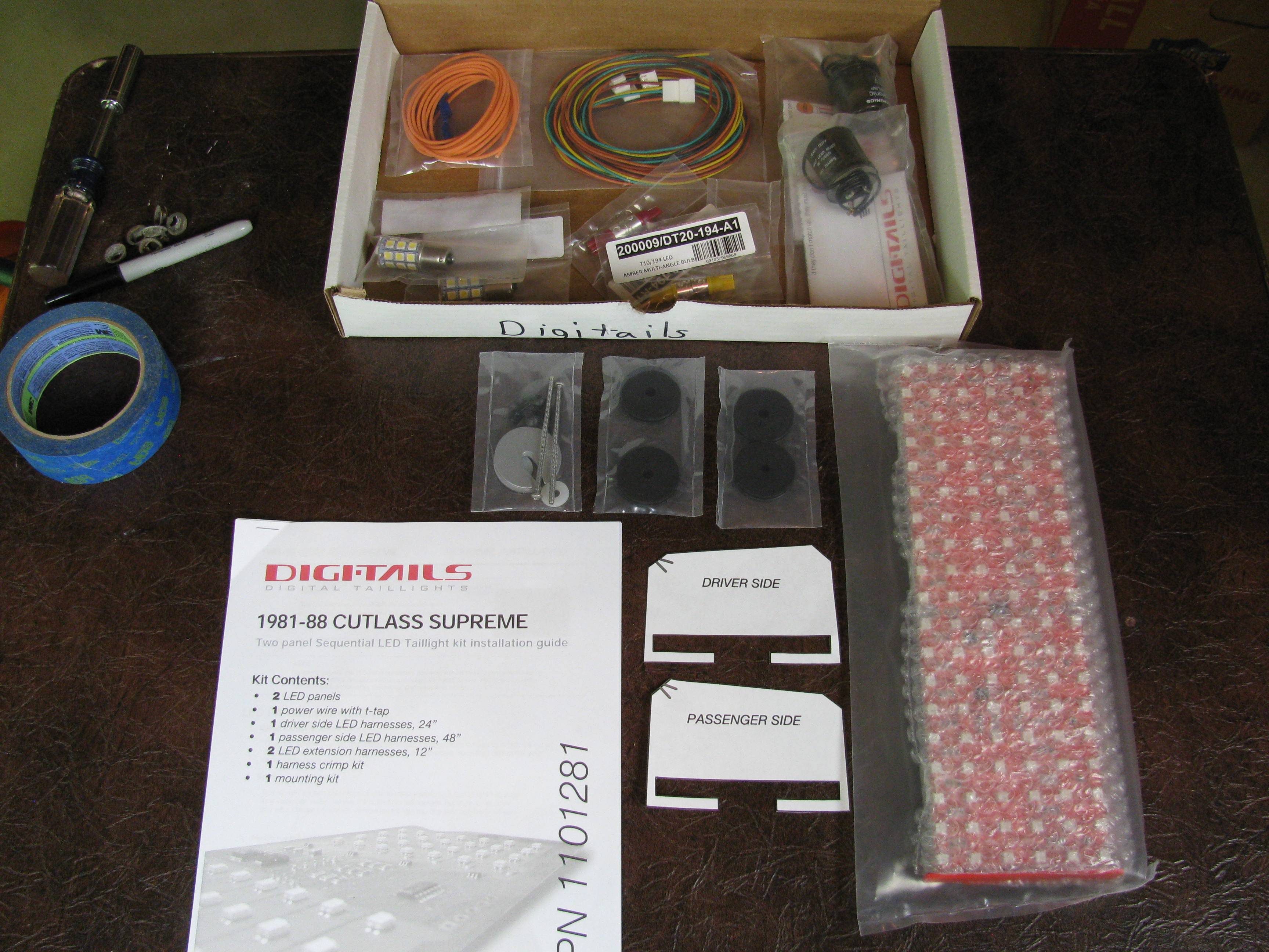

I photo copy the templates and cut them out to trace the cut out areas.

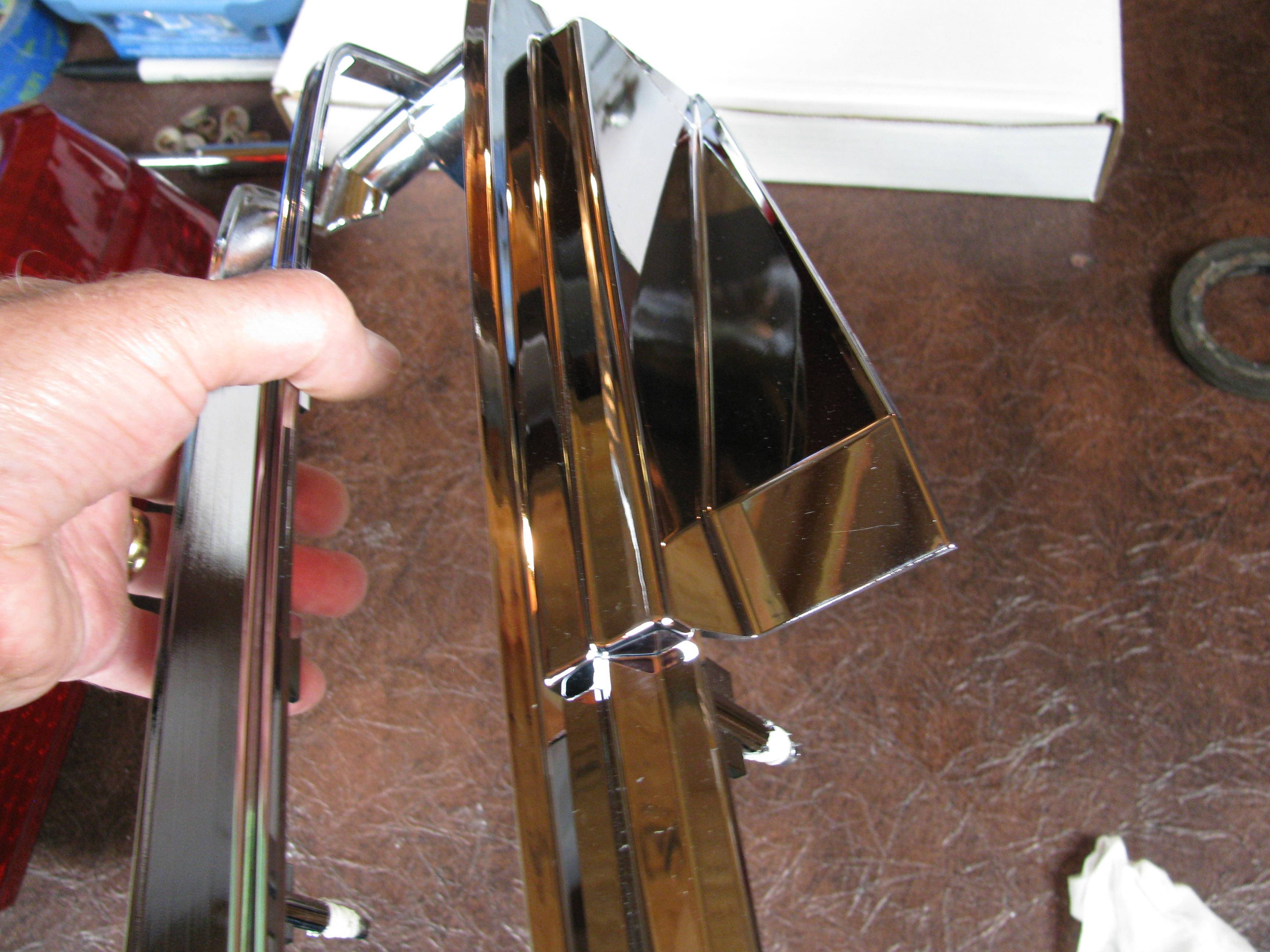

Aaaaand this happens

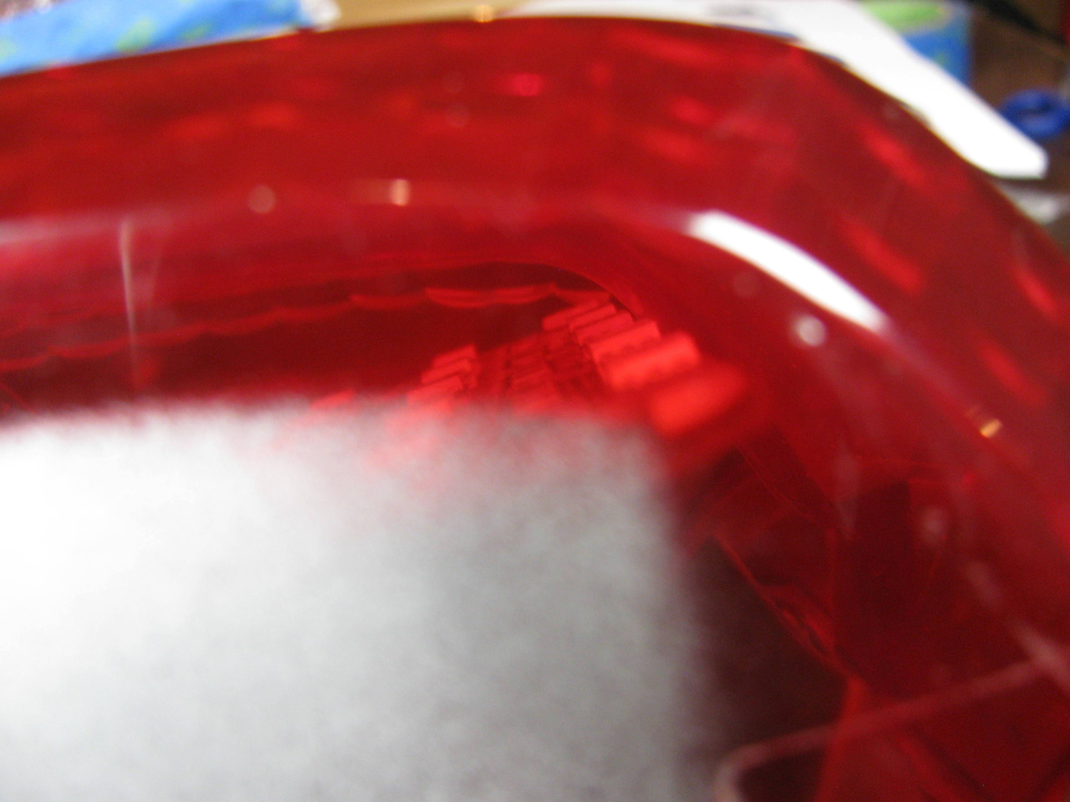

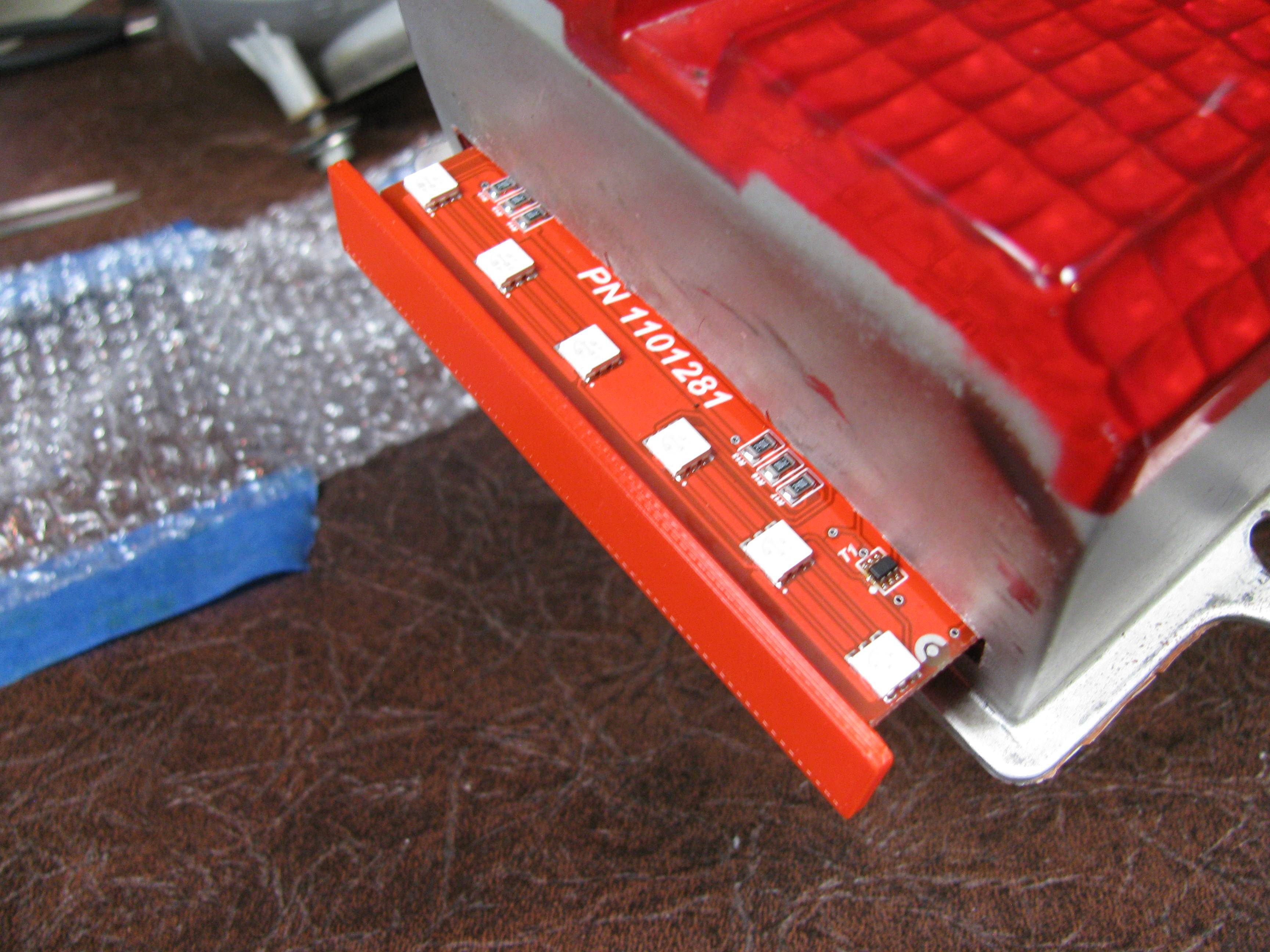

So the recess in the center of the lens is preventing the light board from going all the way in and seating on the internal silver reflectors. 😡
I'm going to stop here and e-mail Digi-Tails to get some input and guidance before continuing. They say they fit 81-88 tails. I hope they have an answer that I'm missing.

Oops. Did you sell the 87 tail lights? Time for Plan B
