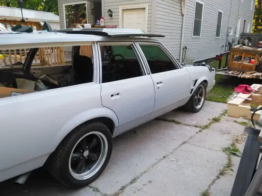

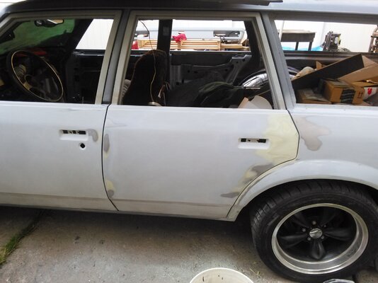

Small update, had a few nice days here so I got the entire passenger side blocked out, in epoxy then 2k, then put back on for final fitment. I started on the drivers side and had some issues with panel alignment at the rear door and quarter. So out came the stud gun with the shrinking tip and a block of wood and body hammer.

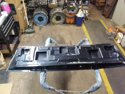

Then I decided to paint the jamb side if the tailgate so I can get the guts in it.
