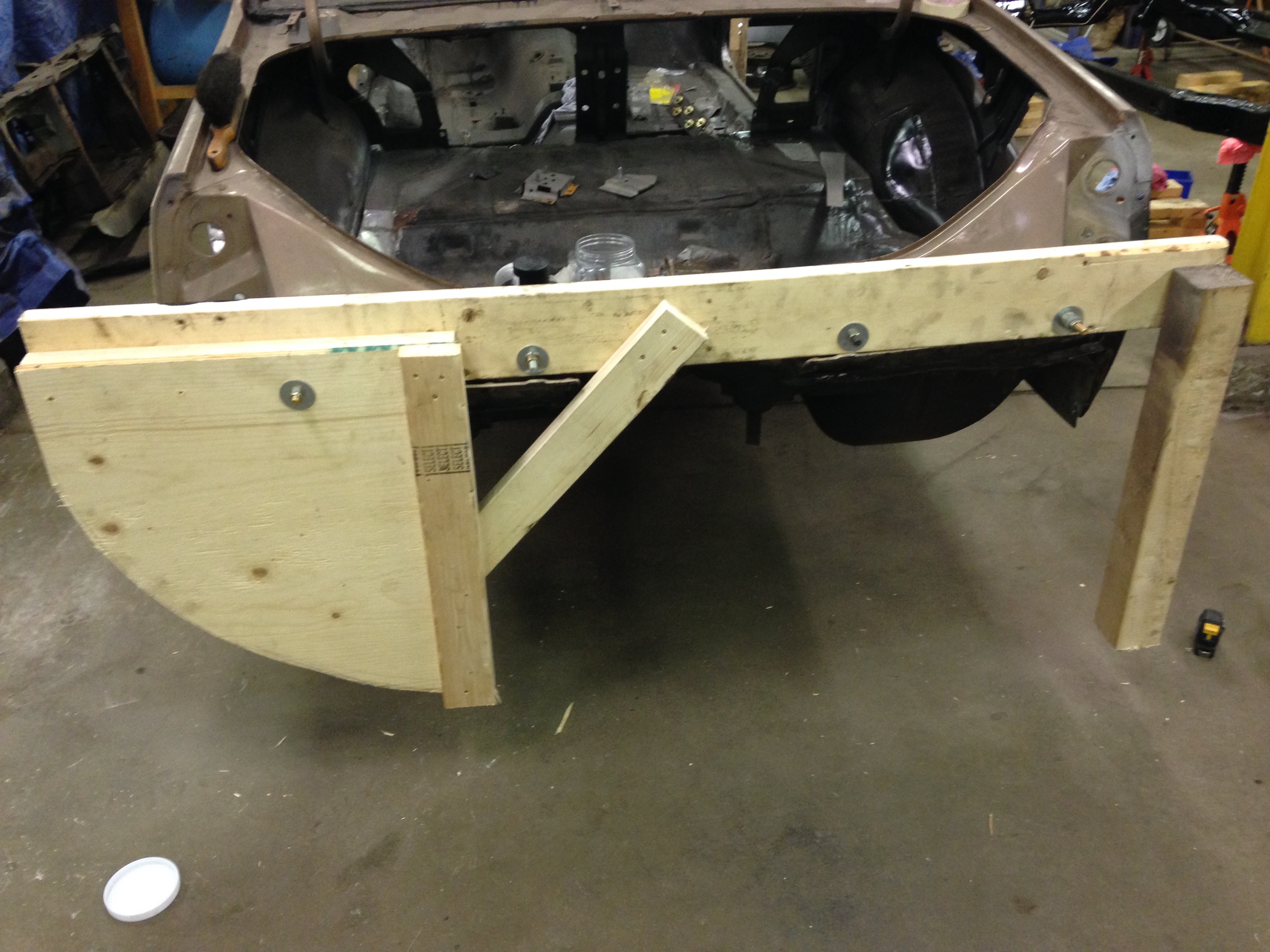

Since I needed more parts and fuel line, and I wasn't getting paid any time soon I found some inspiration online and started to build the tip over jig to keep busy. For less then $40 I was able to build this redneck rotisserie so i can clean up and paint the under side of the floors.
Front
Back
Top support to keep it off its side
View attachment 53052 View attachment 53051

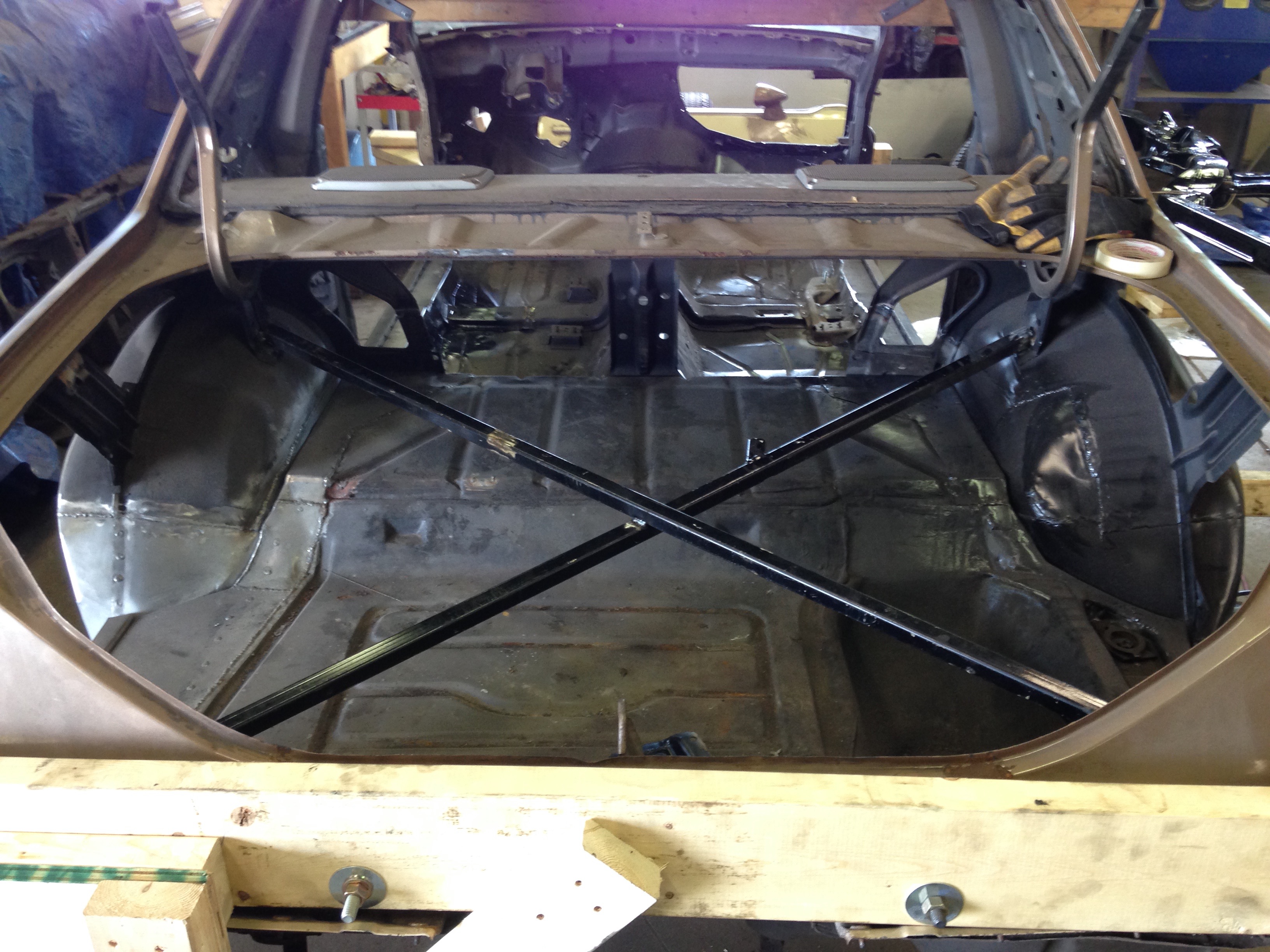

Some trunk bracing since its missing the quarters and i didn't want it to shift

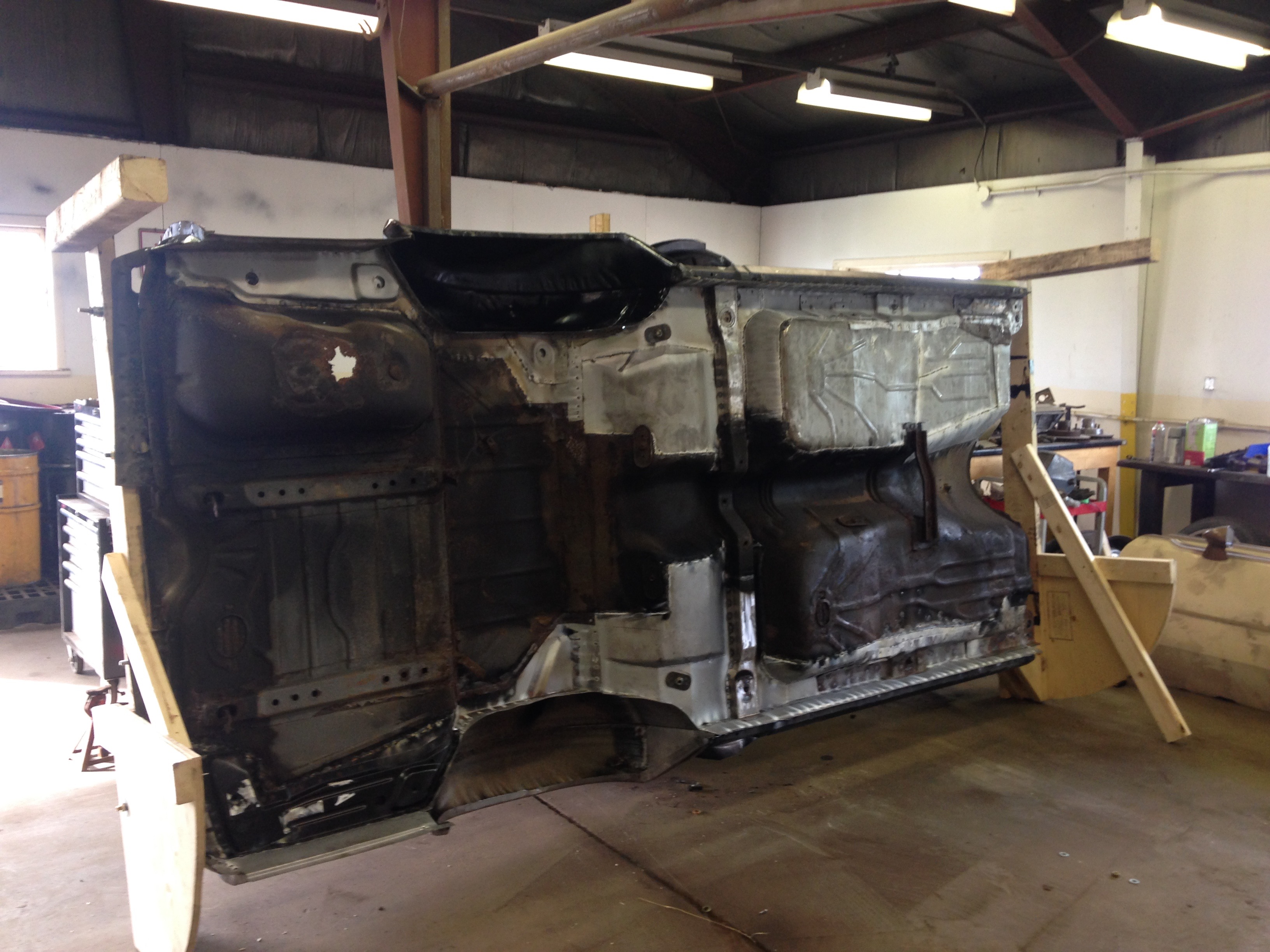

And with the help of some friends
Now the fun can start, scrapping off all the years of grime and under coat. Thanks for all the support from you guys and gals on this forum. Sometimes the fun part is coming home and uploading all this hard work to share with everyone.

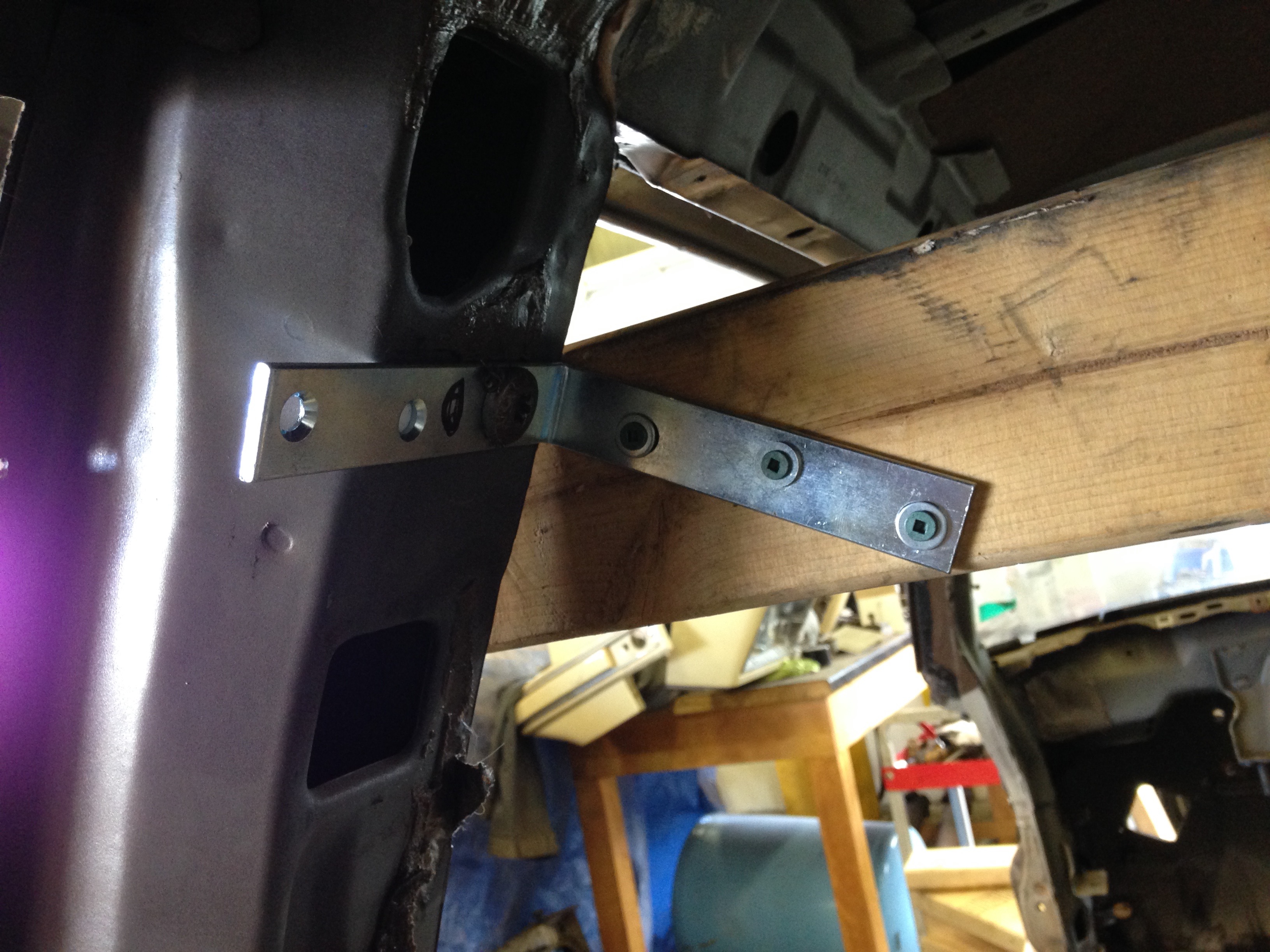

That rotisserie is awesome. I would love to have plans for that when I get the body off of my cutlass. Is the wood all screwed right to the body?
EME_Mack
Greasemonkey
Ya she was a little creeky and nerve racking when it went over, but it feels pretty solid when I shake it. When its back right side up ill take some better pics of how I mounted it. Its attached to the lower door hinge mounts on the front and bolted through the reverse light holes in the rear, seen it done that way with a cutlass on a rotisserie. So figured it was good enough for me, and it allows access to paint the rear body mounts.

So After what felt like an eternity wire wheeling and grinding, I managed to remove all the paint and under coating from the floor of the car. Which by the way kudos to any of you that have done this on your back under a car, I was covered head to toe in metal dust and grime. To have that fall on me if I was on my back under neath the damn thing, Im too soft to do it that way. After the wire wheel thrashing I found some more spots that needed to be replaced. So I rolled in the parts car to cut it up.
