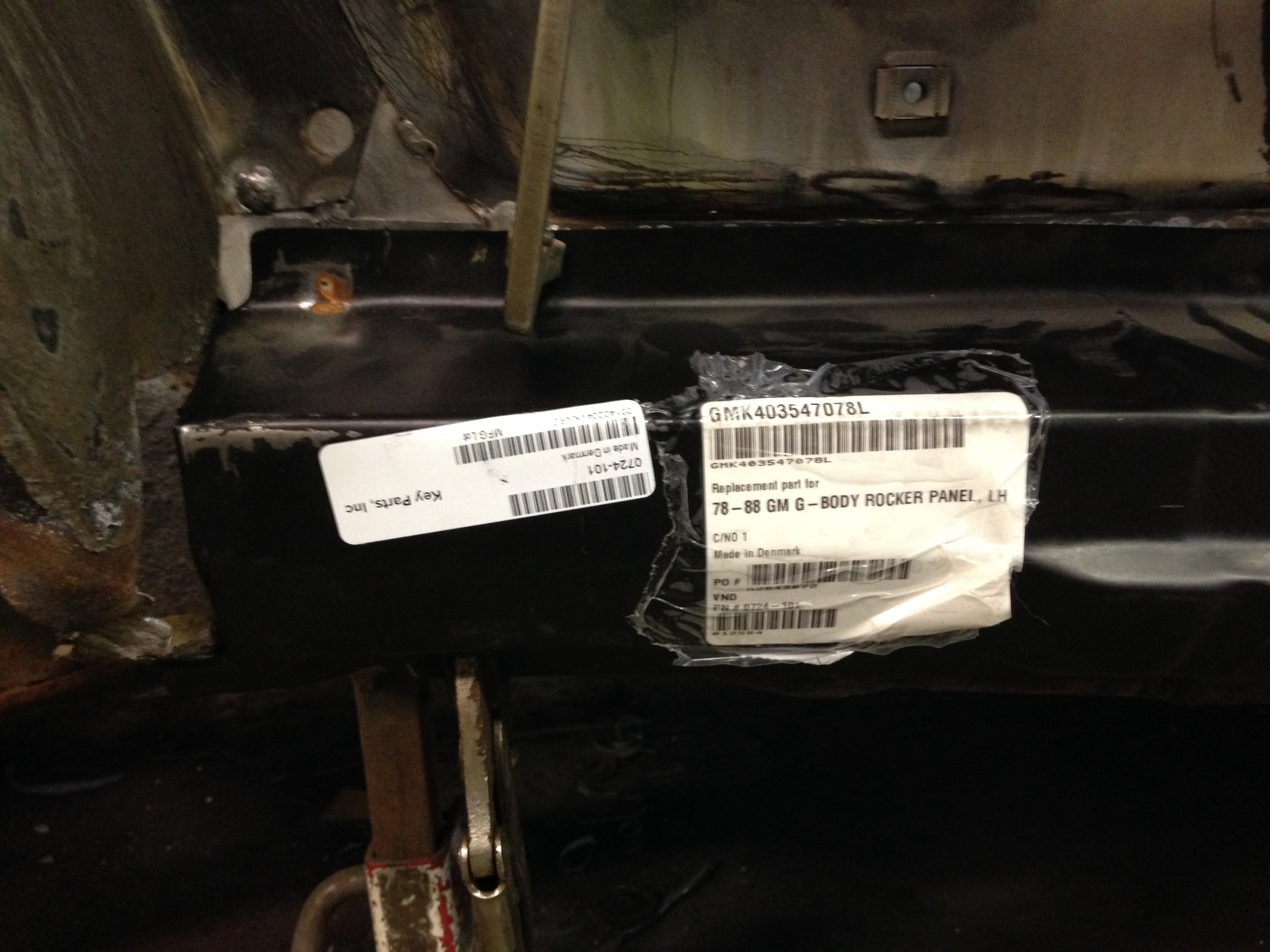

So after ordering the passenger rocker 3 different times and reciving driver side ones, then ordering a left instead. the rocker I have been waiting on for 2 months finally showed. It is labeled as left hand, but its a passenger side rocker

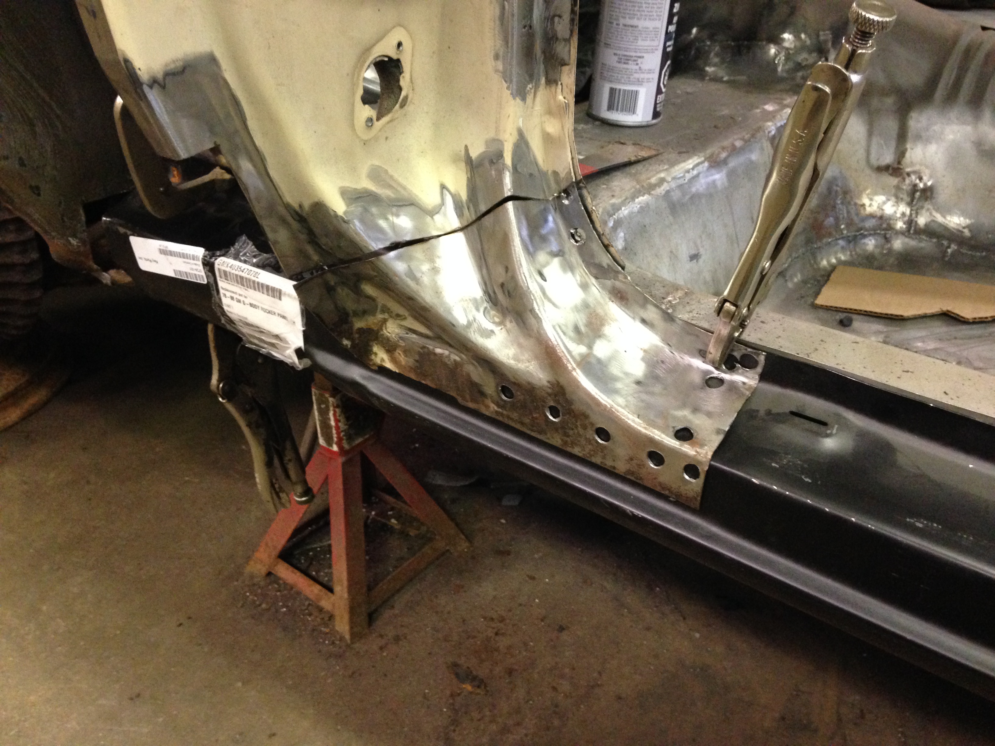

Here it is fitted on the car. Checking to make sure all the work I've done lines up and fits

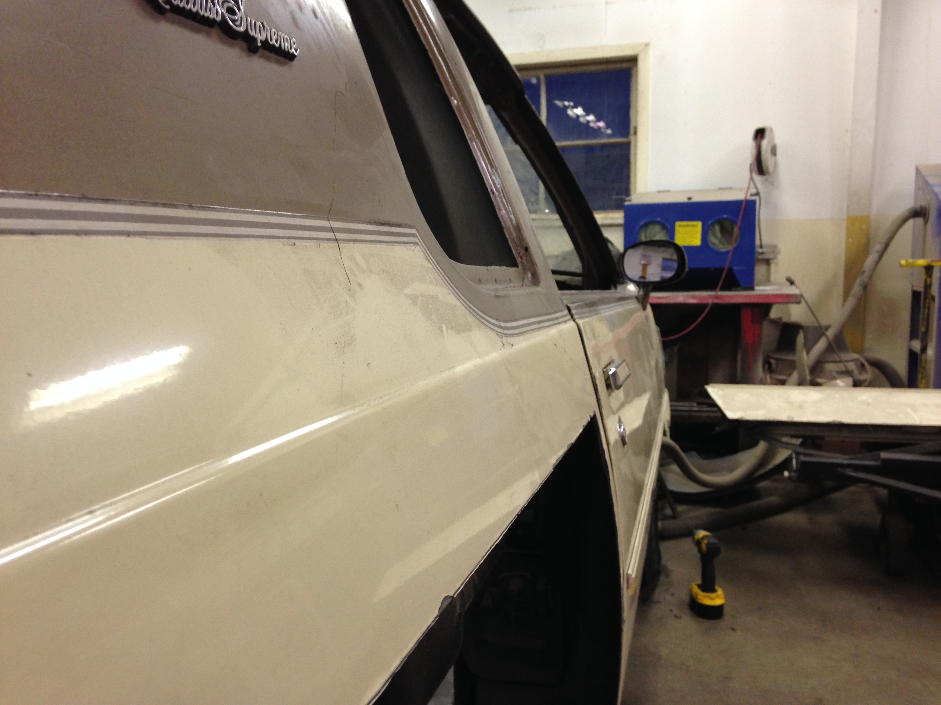

I mounted the door to make sure the body lines match up and the gap between the door and rocker is even front to back. The door bottom is pretty much crafted from bondo, so its not exactly flat but the gap looks good.
Now I can start to fabricate this little corner down here then weld her up.
I pre drilled the inner and outer rocker to be plug welded together, but Im not sure on what im going to do for the inside cavity of the rocker. Should I remove the EDP coating or scuff it and paint it with some sort of sealerIll have to consult a body guy. I'll prob end up using a urethane primer or epoxy to seal it. If anyone has any ideas im all ears.
View attachment 43899 View attachment 43900

As far as what to do in your questioned area, the EDP primer is strongly recommended to be left on by most manufacturers for corrosion resistance. A thorough scuff with a red scotchbrite pad followed by a couple coats of a quality epoxy primer is all that should be required in that area.
Hope this helps you out, keep up the incredible work.
