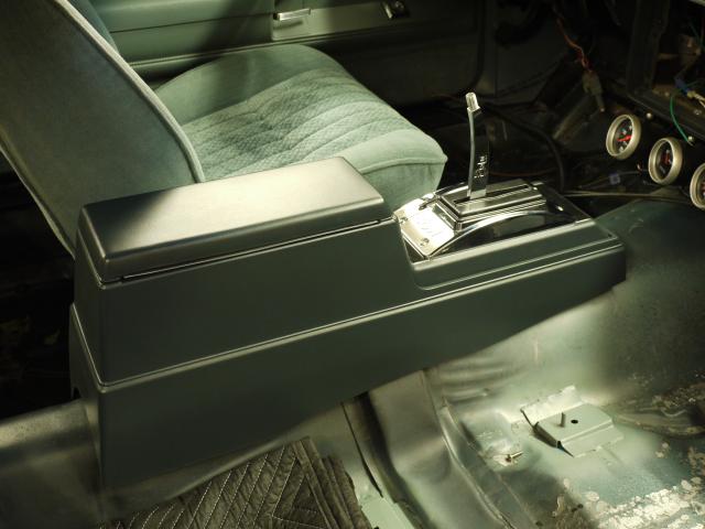

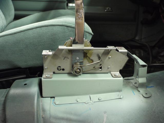

I also used to have the Hurst V-matic 2. I liked it...it was a good dual action shifter that could be shifted normally, or ratchet mode. I went back to a stock shifter.
Here's an old pic of my interior with the Hurst V-matic shifter and modified newer Grand Am console.
I didn't use the linkage from the column to the shifter. I locked the column in park and just used the cable....and of course, connected the neutral safety switch and backup lights to the 2- micro switches on the shifter.
