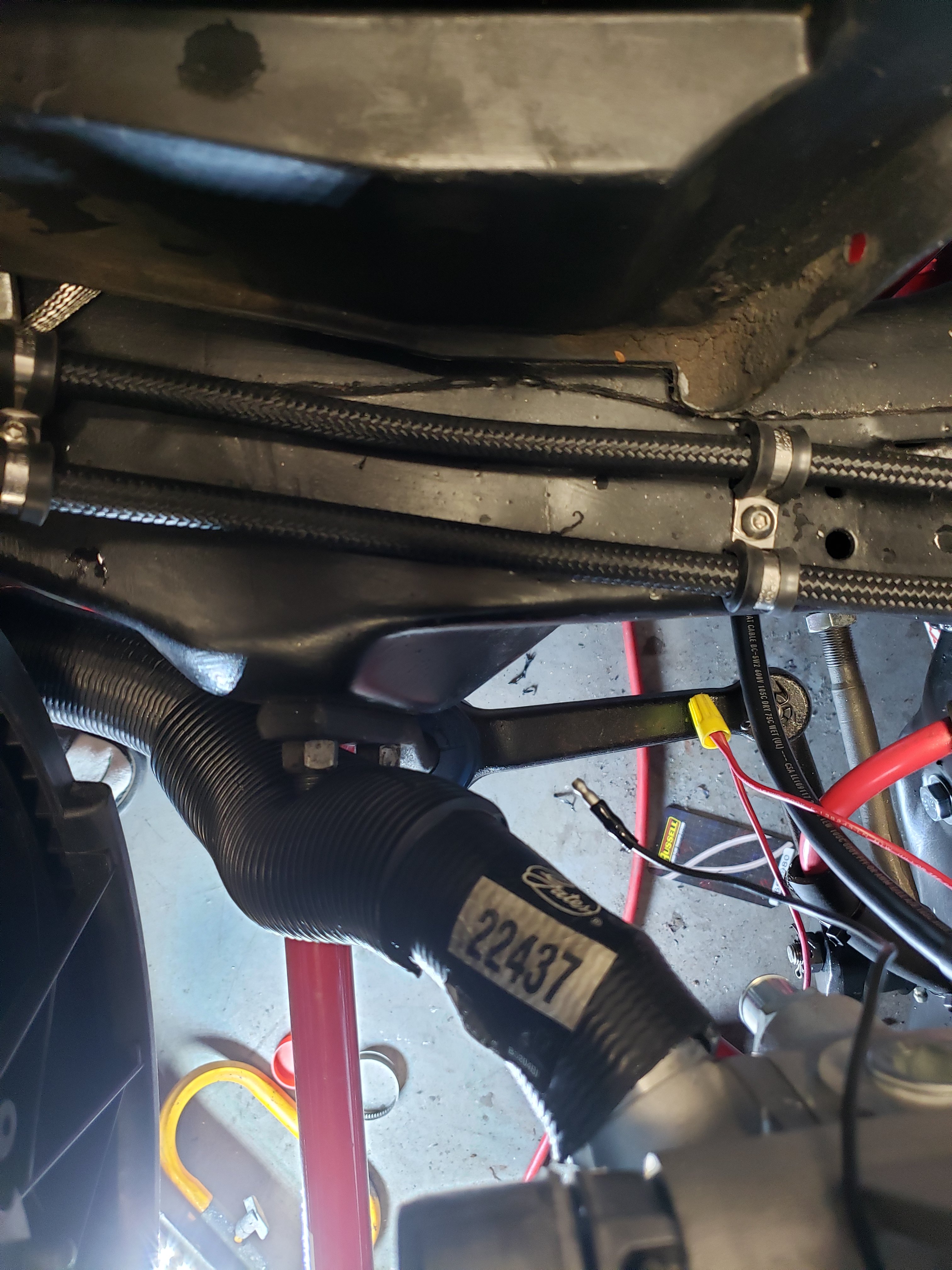

These were supposed to be the correct upper and lower radiator hoses. The bottom hose is way too tight on idler arm bolt and the upper needs about an inch and a half more left to right length.
Arggggg. Maybe I'll have to use a flexible lower? Any and all suggestions. Thanks View attachment 155045View attachment 155047View attachment 155048
First thing I'd do is figure out a way to turn the idler mounting hardware around.
Second recommendation is to 'hard-pipe' some of the system if necessary. I've used hose w/pipe fittings (exhaust or stainless tubing) on more than one ride but I have easy access to discarded stainless in various sizes. It allowed me to take a radiator hose(s) w/curves that work & splice a line together that clears things as needed.
A coat hanger bent as a template works to give you an idea of hoses that might provide the bends/transitions for an optimum set-up to your specific group of parts.
My buddiy that builds hot-rods for a living will piece together exhaust or stainless tubing sections & just use hose to connect the ends (the tubing gets high-temp coated inside/out) & then paints the outside in a satin/under-hood black.
Just some ideas.....
