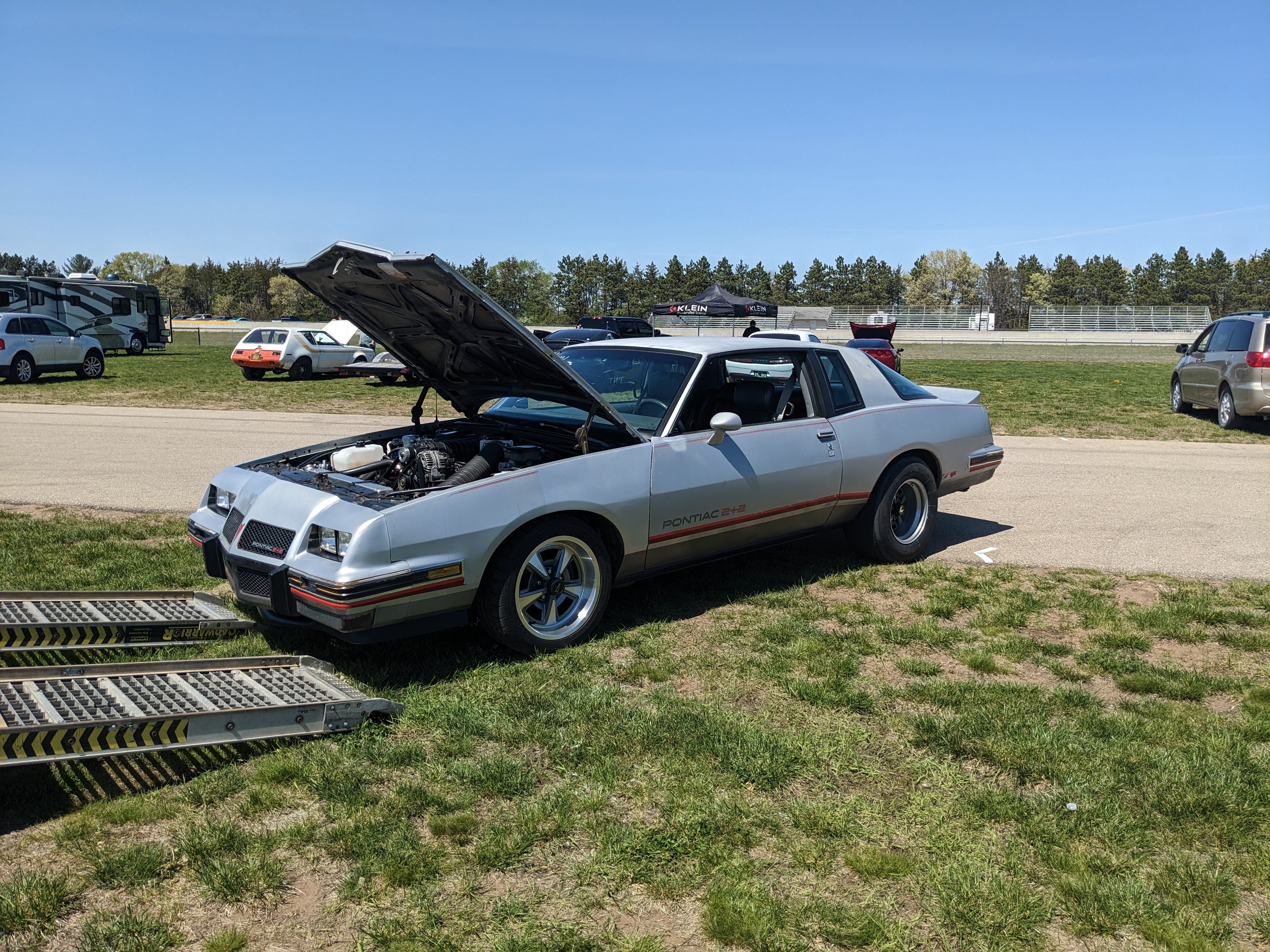

BUILD THREAD 86 GP 2+2~Blown 6.0
Finished the wiring oops repair and took it to the coin op wash to remove the 16 months of mouse blood and urine.
Also took it for a short drive and seems good! Its a bit rich at idle but not bad, quick hpt update and should be good.
Besides the cam having a bit more chop everything seems about where it was when it blew up.
Gotta wait for a good rain storm to wash the roads off before I take any real drives and find an open track for a test day but otherwise feeling ok where it's at.
