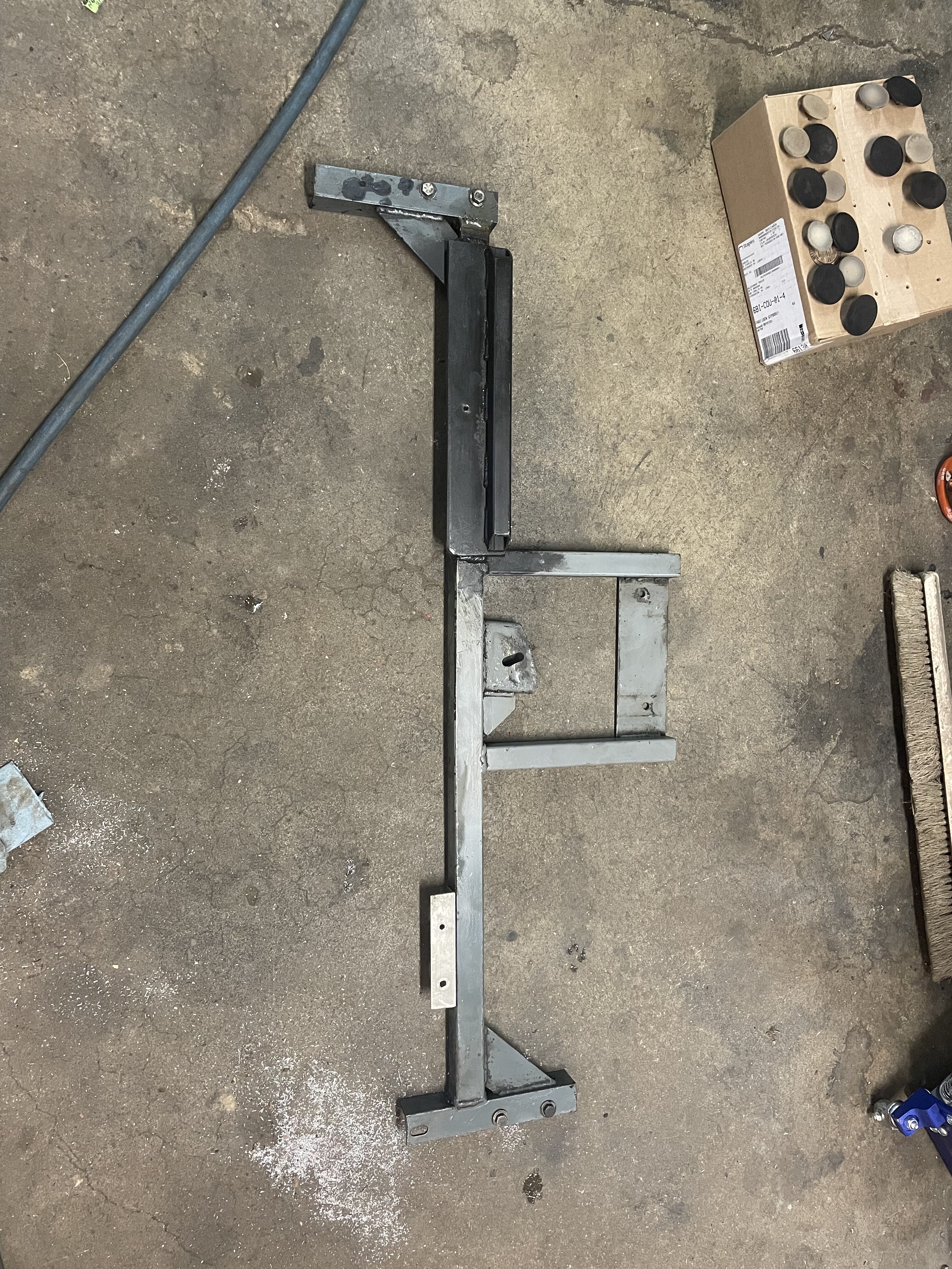

If any of you has a frame out, can you measure edge to edge and center hole to center hole of the crossmember area. Thank you in advance.
45” bolt hole to bolt center. 43.5” inside of frame rails to inside frame rail.IMG_2359.jpeg
I made mine obviously. The trans mount tab I cut off a factory crossmember.
And I know it looks crude, but it gets it done.
